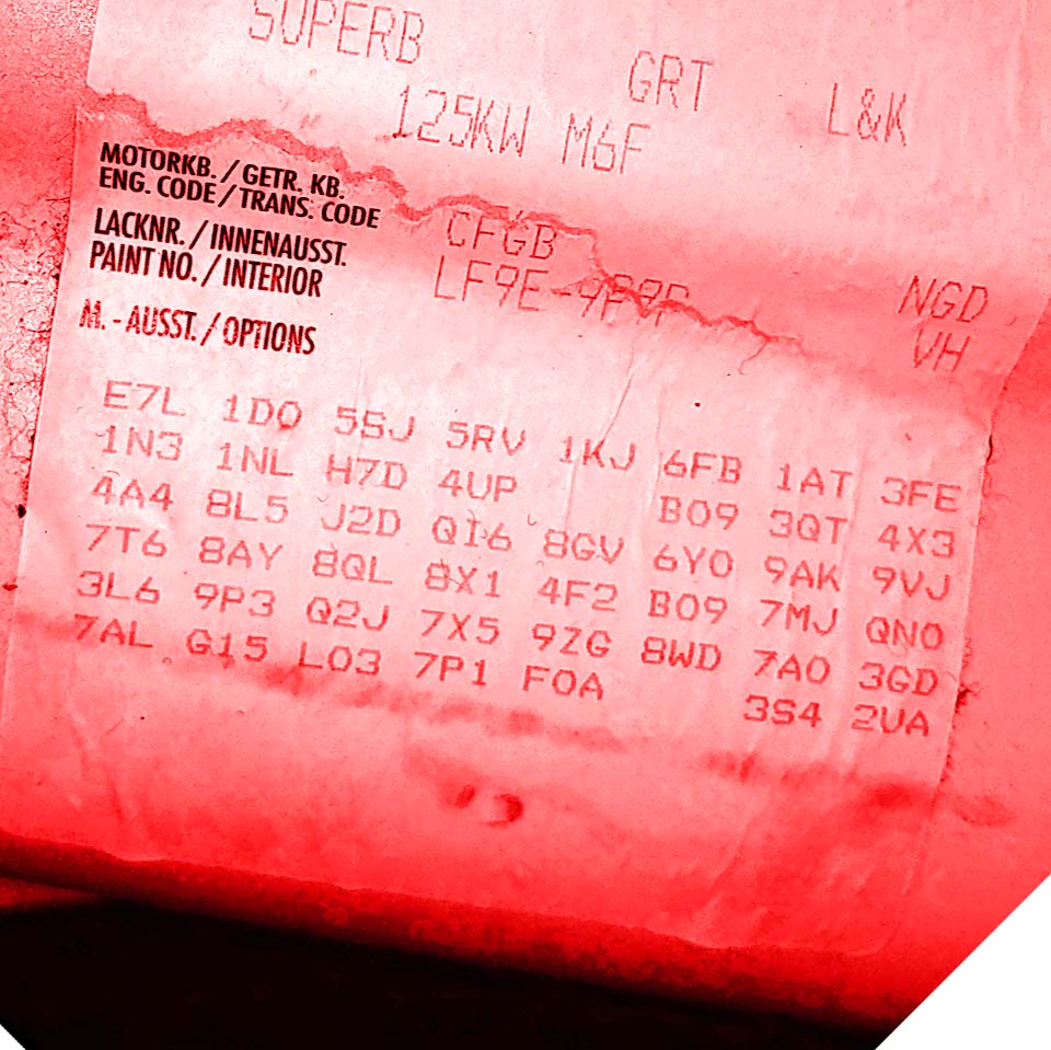

Ah, now that would be a game changer - no service book with my car but where do I look for the sticker?
The sticker should be in the spare wheel well.
The picture below is from a Passat wagon, but it will give you the idea. It will be somewhere along the inside of the spare wheel well :

Looking for the sticker as soon as it stops tipping it down

Blast - doesn't look like it:
From http://prsearch.planetvag.com/:
Quote
PRCode: 1AT = Electronic stabilization program (ESP)
PRCode: 1D0 = Without trailer hitch
