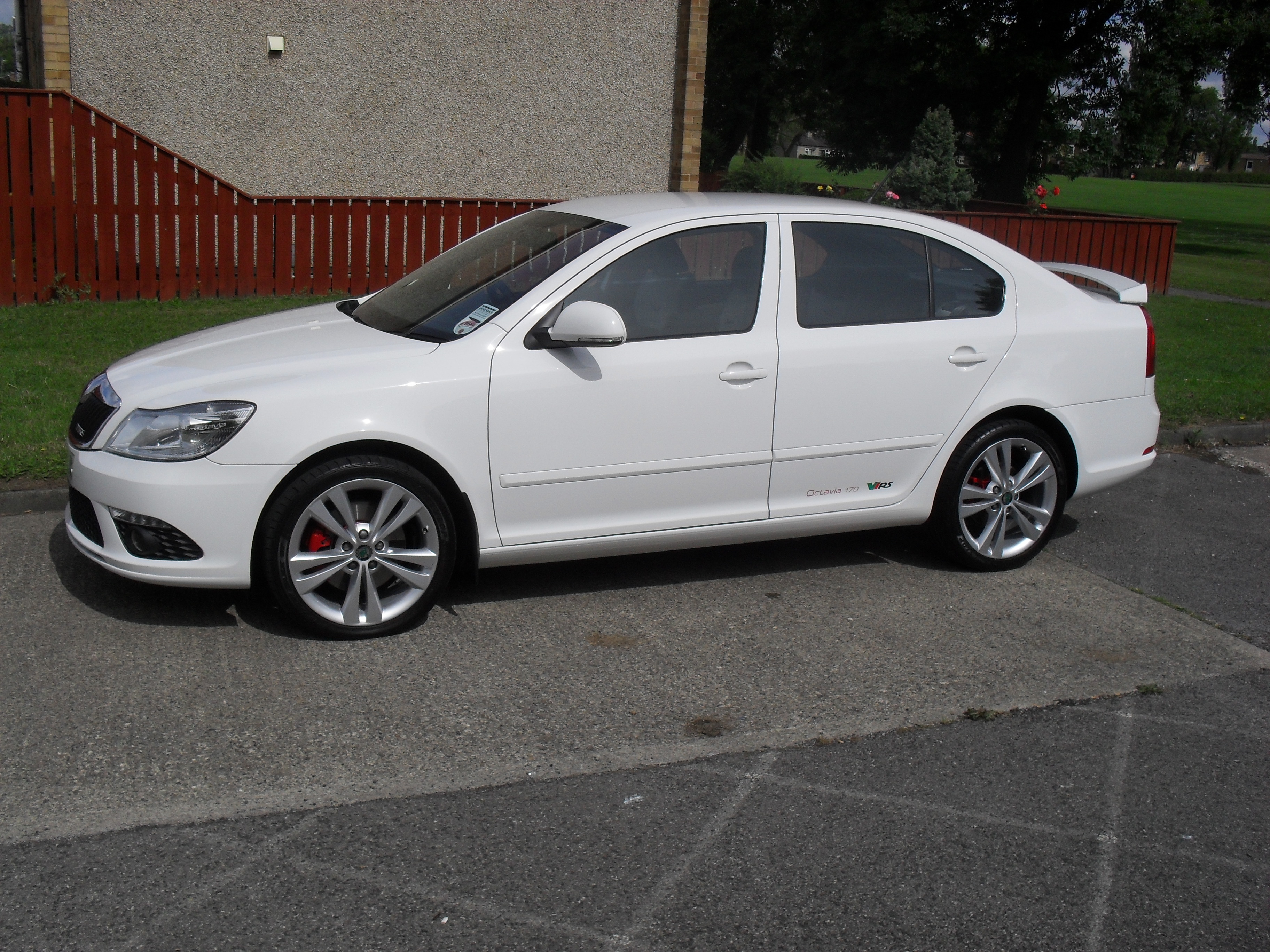

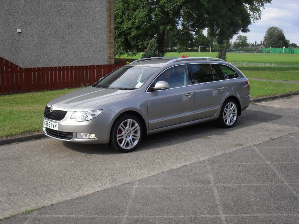

hello deco, would not drive it until you find out what is causing the issue. could damage the engine, have you had your emissions done yet deco, i have and all is ok for now, but i do find the vehicle has more grunt, and i can hear and feel the difference on acceleration, albit, it is a 4x4 superb, i love my skoda, it is so roomy, quiet, powerful, and comfortable, as well as good looking, it is in cappuccino beige,  i used to have the octavia Vrs in white, but i changed it for the superb to tow my caravan, but two weeks later i sold the Vrs to go back to a motorhome pictures supplied, the Vrs only had 9300 mls on it, i love that one to, these cars now are as good as any i have driven in my 55 years of driving.
