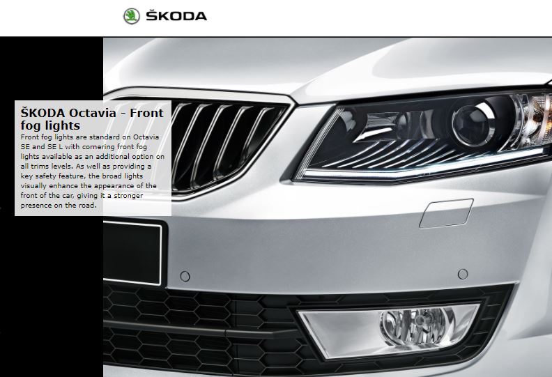

Front fog lights
Is your wheel turned when you stop? If it's a fog light it could be that the cornering element of the fog lights remains active when they switch to coming home - hence the side to which you turned will be on....
I'm guessing a bit here - but I'd claim it was an informed guess... :blink:

The units lying separately, below the main lighting units, are the foglights.
Try turning your lights on and having a look, at the various combinations of switch position, beam high/low and ignition on/off.
As others have said, you can get a one-sided effect by turning on the parking lights to one side (ignition off) or by having one front foglight come on as a cornering light, because the front wheels are turned (ignition on).

As I said in post 2 in this thread, the lights immediately below the main cluster on the Kodiaq Edition with LED headlights are the Front Fog Lights.
They are used, along with the dipped beam, for Leaving Home/Coming Home Lights, and as cornering lights. I haven't tried to see if they are also used for the parking light function.
If the OP has only one of them lighting up then it is easy to check - manually turn the headlights to dipped beam and pull the switch outwards one position to turn on the front fogs, if only one is lighting up then you have a fault. If both light up then the only other condition I can think of where only one side will illuminate is as a cornering light (assuming they aren't used for the parking light function).
Any faults with the lights should flag an error or warning on the dash.
If only one front fog light is lit then it is highly likely to be the cornering fog lights in operation.
All Kodiaq LED headlight functions can be viewed here, including the cornering fog lights...
Edited by silver1011
It is the cornering light function. It didn't make sense because they are cornering fog lights, but I've not turned the fog lights on. I noticed that one light was active when the missus was turning into the drive, which now makes sense. Re-reading the manual does explain the function and they do activate if the fog lights are off.
That video explained a lot but thanks to all of the replies.

Any bulb could provide the cornering light function, VAG have chosen to use the front fogs. They aren't cornering fog lights though, they are fog lights that are used for the cornering light function.
We'll have to agree to disagree :D
Same light, same bulb, same housing, two functions; cornering lights & fog lights = cornering fog lights.

Most manufacturers these days have dipped headlights that turn with the car, some have fog lights with two bulbs, one for the fog light function, the other for the cornering light (Kia Sportage comes to mind), some simply turn on the existing fog light.
'Fog lights with corner function' makes it sound more than it actually is, all they've done is added some coding to turn on a fog light in an effort to claim the car has cornering lights. I guess they are but they are cornering fog lights.
The O3 vRS if coded from the factory used only the outer bulb of the 2 in the fogs for the cornering light function, so even VAG do have variations on the theme
