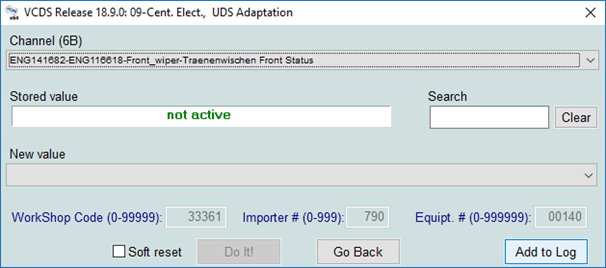

Controller 09 - Cent. Elect.
16 - Security Access - enter  31347
Adaptation 10 :
Select Channel 6B - "Front Wiper - Traenenwischen Front Status"
Set new value to "Active"
Click “Do It!"

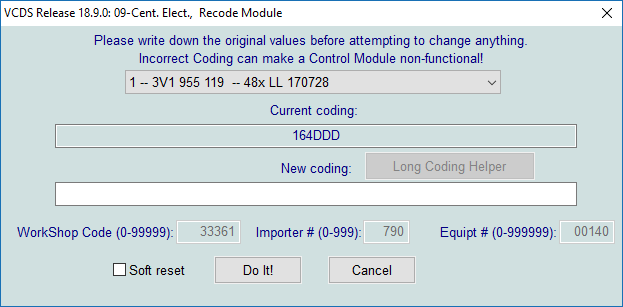

07 - Coding
Select "1--3V1 995119-48x LL 70726" in drop down menu
Click on "Long coding helper"

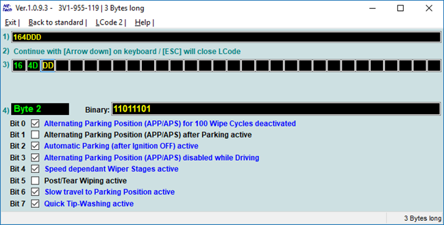

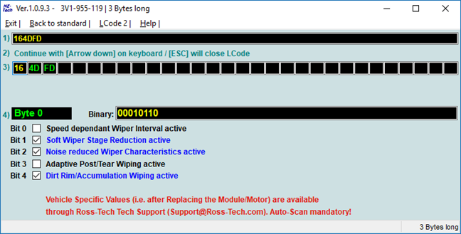

Byte 0
Tick Bit 3 "Adaptative Post/Tear Wiping Active"
Byte 2 / Tick Bit 5 "Post/Tear Wiping Active"

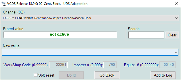

Enable Tear wiping for rear window wiper:
Adaptation 10 :
Select Channel 8B - "Rear Window Wiper - Traenenwischen Heck"
Click “Do It!"
