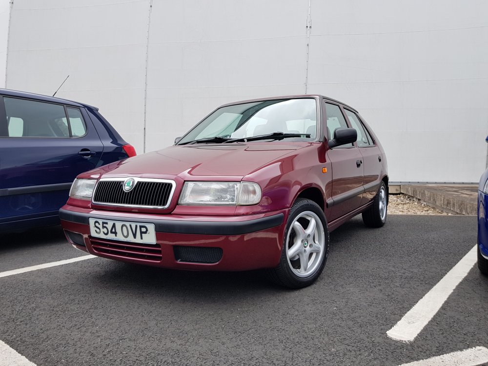

Not wishing to highjack your post here is a pic of my car at the Skoda gathering this year at Cosford car is STD apart from the wheels and tyres wheels came from my next door nighbour £40 all four + tyres.
I have to admit, your car is a peach. How old are you, Mike ? What is your driving style? How good are the roads you drive on a daily basis?
