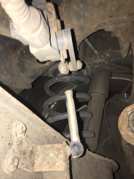

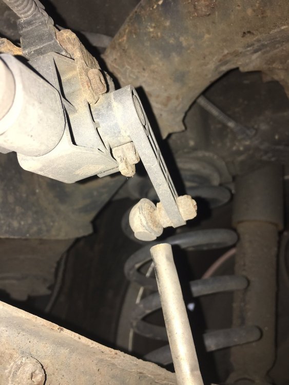

Anyone seen this problem? The rod that connects the lower suspension arm to the levelling switch for the Xenon headlights on my Superb II (58) has snapped.
I had an issued with a snapped spring last year on that nearside rear corner of the car and can only assume that the rod snapped then. The lower ball connector is very stiff/stuck solid so that's probably caused the failure. No idea how the switch itself didn't break.
Going to see whether the garage can weld it or may bite the bullet and get a whole replacement unit.
Apparently this is an MoT failure as well.
Annoyingly it seems that the link rod is not available as a spare part, you have to buy the whole sensor assembly, part number is 3T0941273. I'd check whether the sensor itself is ok before going any further. You should be able to check that the sensor is changing its output as the link moves using measuring blocks in VCDS. If it doesn't work, then you're going to be replacing the whole lot anyway. If you just need the rod, a scrapyard might be able to find one for you.
