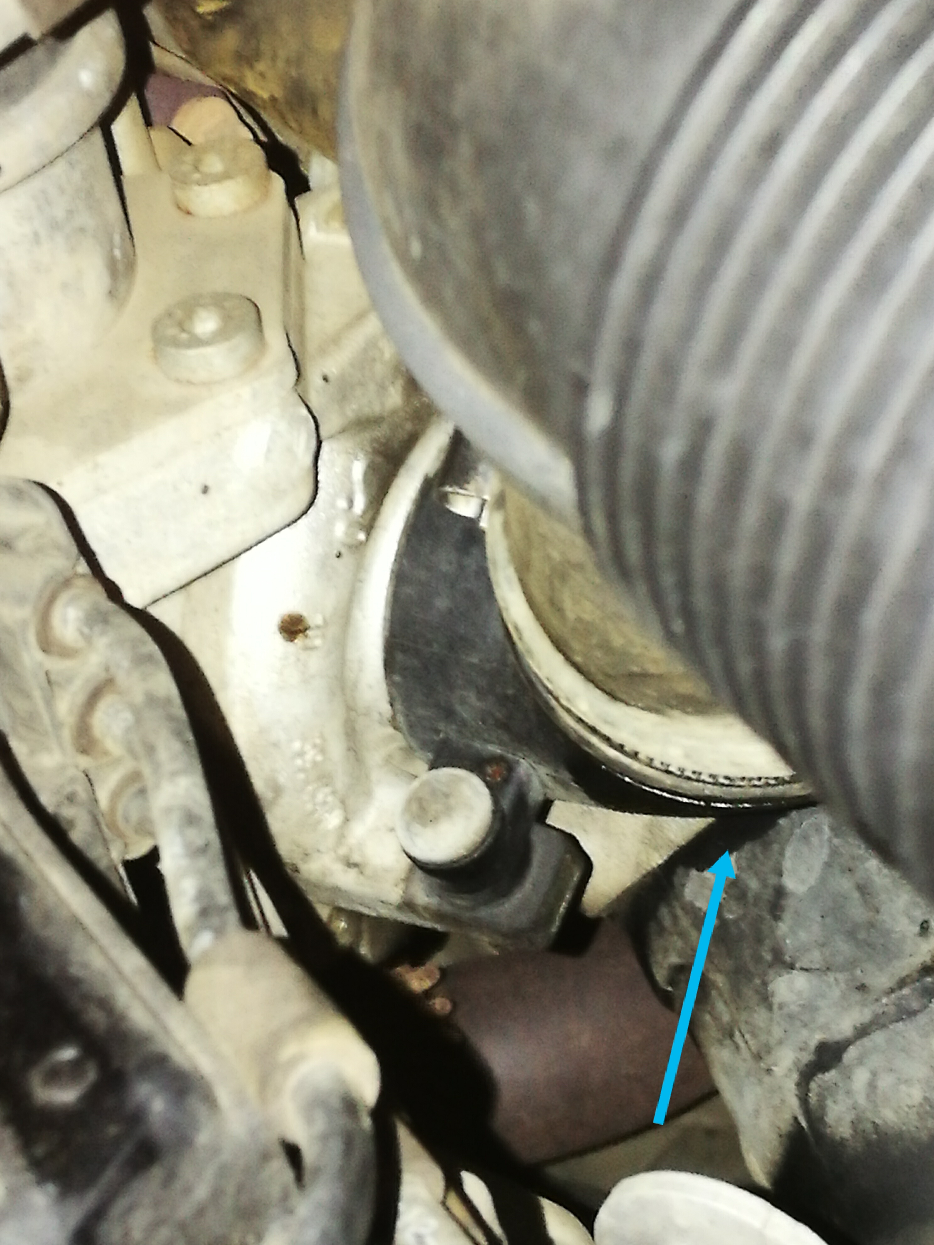

What is happening here? Why this stain next to the turbo??

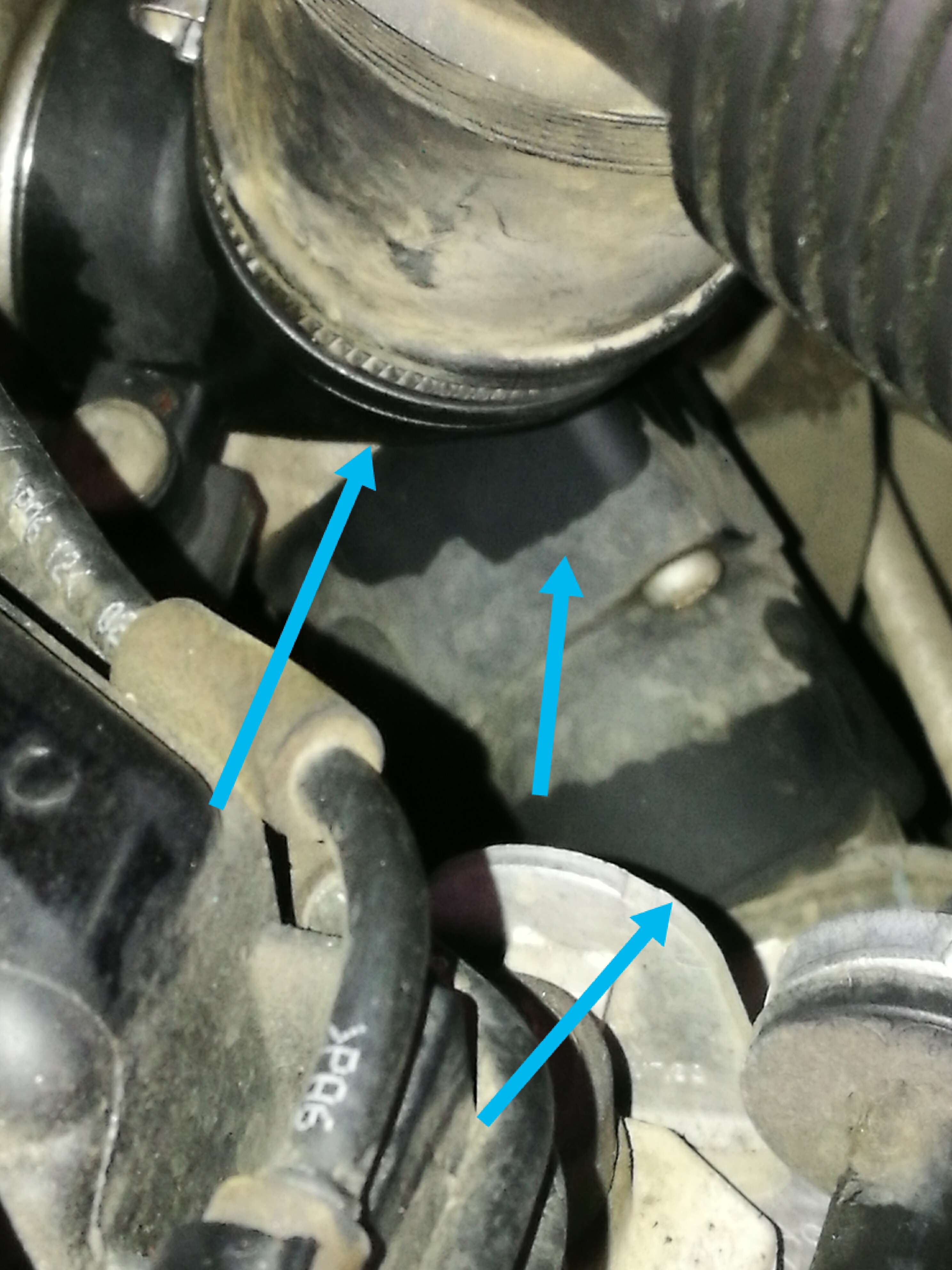

I took the intake apart, I couldn't see any cracks, there was a teaspoon of oil just outside the turbo. Cleaned everything with some electrical instant drying spray but the stain can back straight away. I can't workout the source.

When I took the intake apart there was a teaspoon of oil sitting in the pipe but not much. I taped the intake pipe to see if it's coming from the turbo or the boost pipe. so far no oil has been consumed. If that's is possibly the case, what symptoms am I looking at?

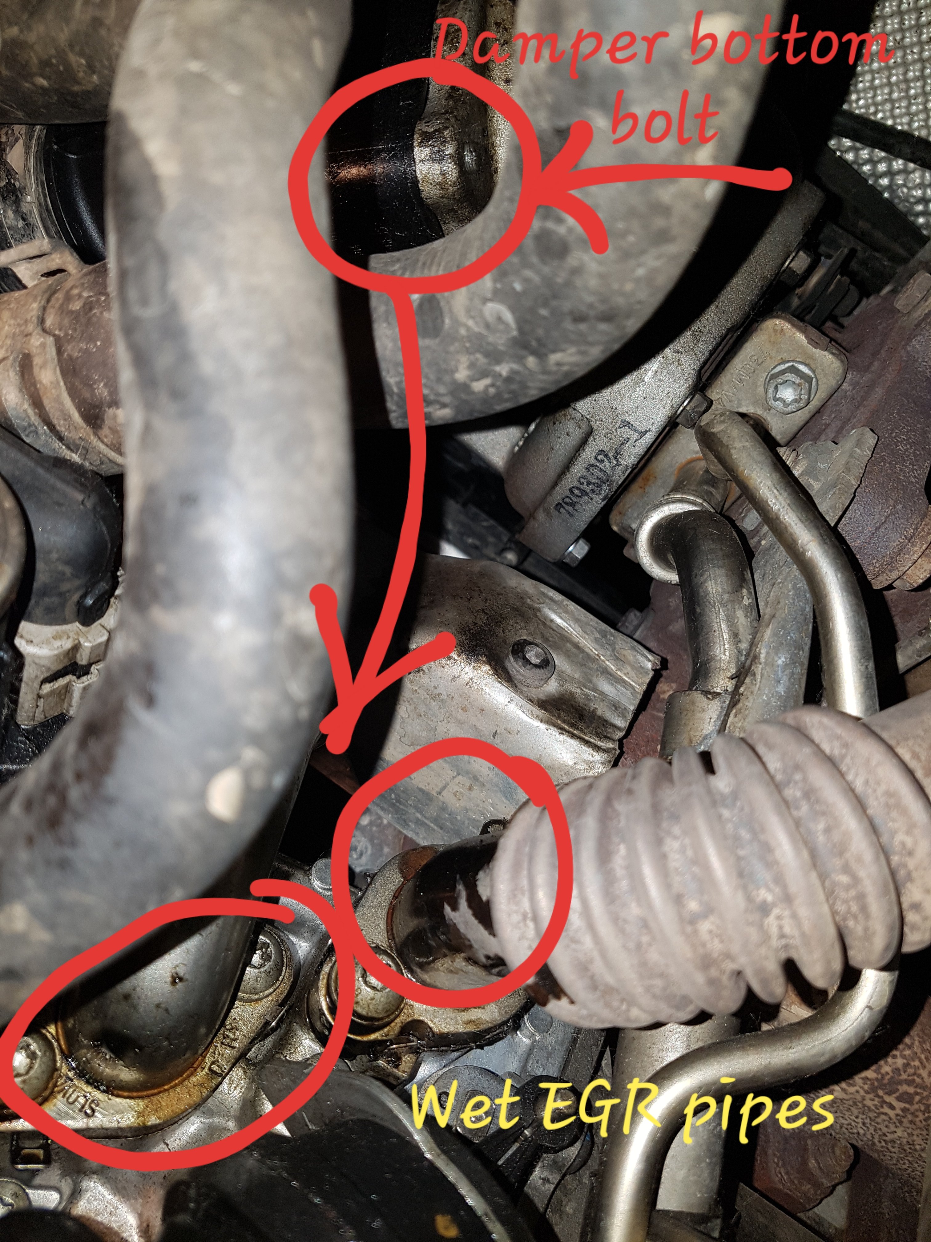

Hi Bertie90,

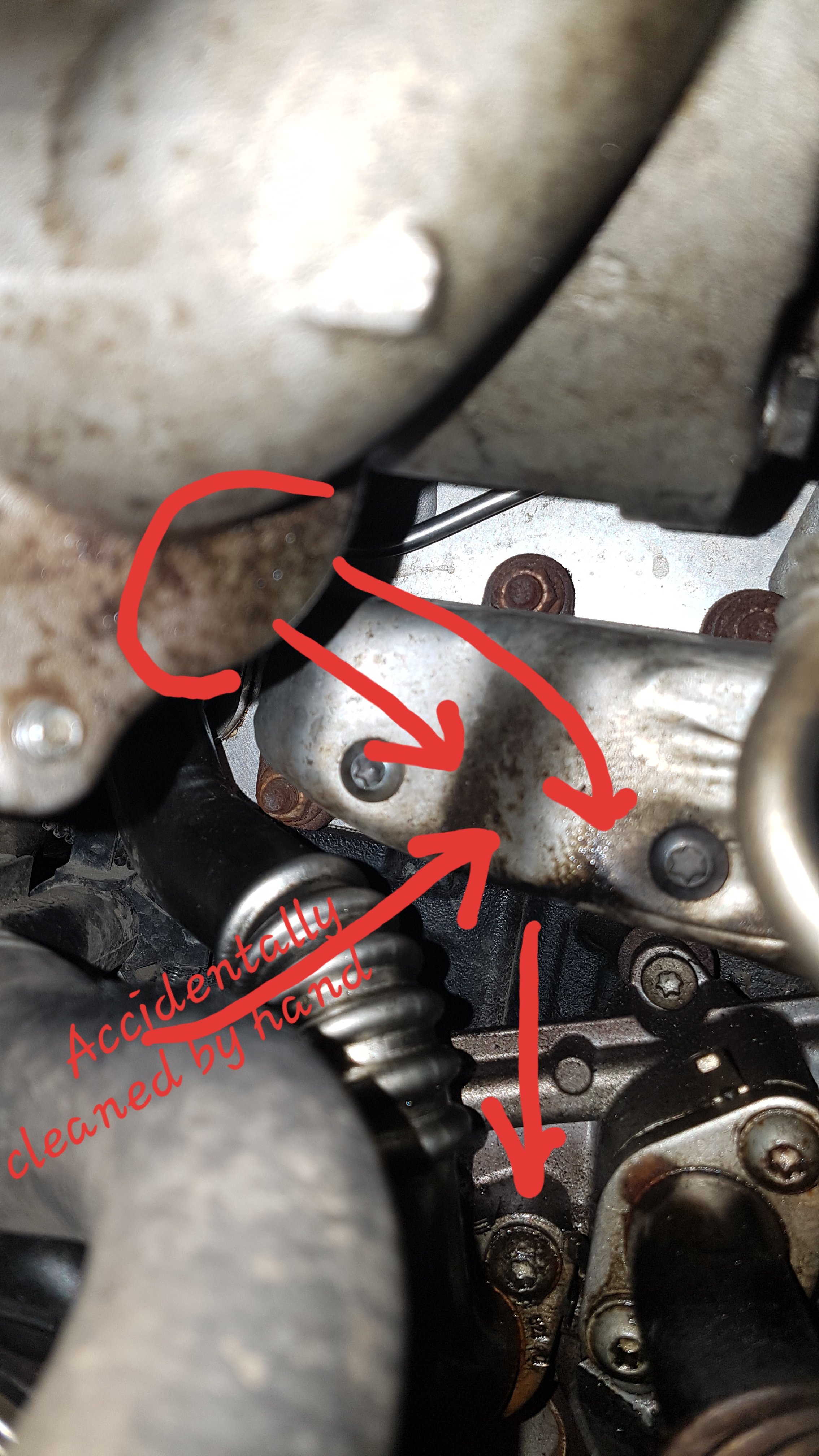

I have 1.6tdi CAYC and seems like I have quite similar issue. I dived my hand down to out-pipe from turbo, close to plastic damper and found that bottom bolt was all in oil, also, I found that EGR pipe is also in wet, seems like oil sprays from that tiny hole.
Do you remember, what kind of tape you used there, it should be resistant to oil and to constant pressure(don't want parts of it being sucked inside the cylinders) ?
Here is my case >>>
so i used teflon tape around the bolts for the damper and also changerd the O ring. Only use a little bit of teflon not a lot and you will be fine.
That looks to me like an EGR issue there. If those pipes have a gasket it's cracked or it can even be a different issue all together.
just to add.....clean the area with brake cleaner and monitor, see exacly where the mist is coming from. go from there

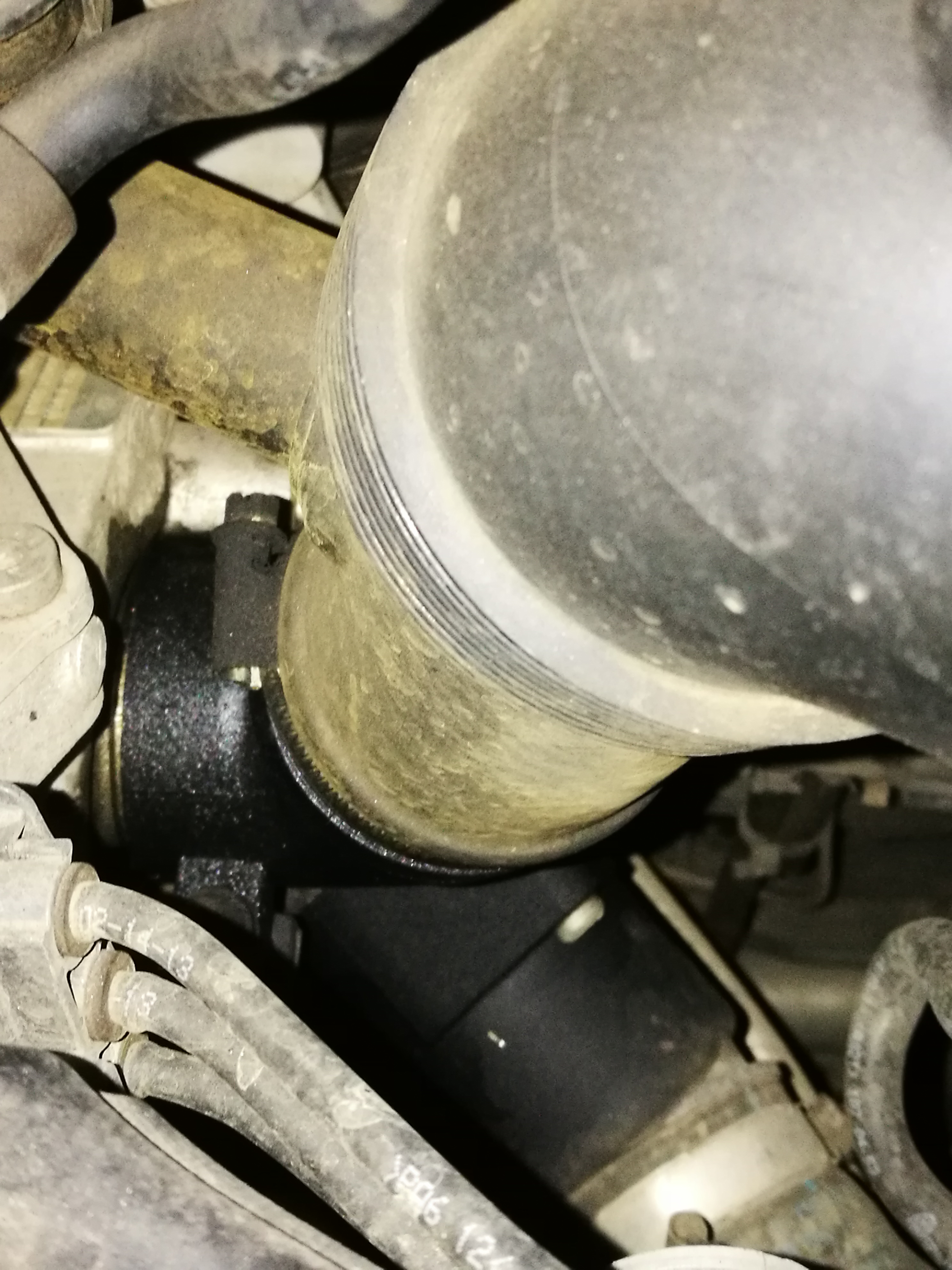

Hi again,

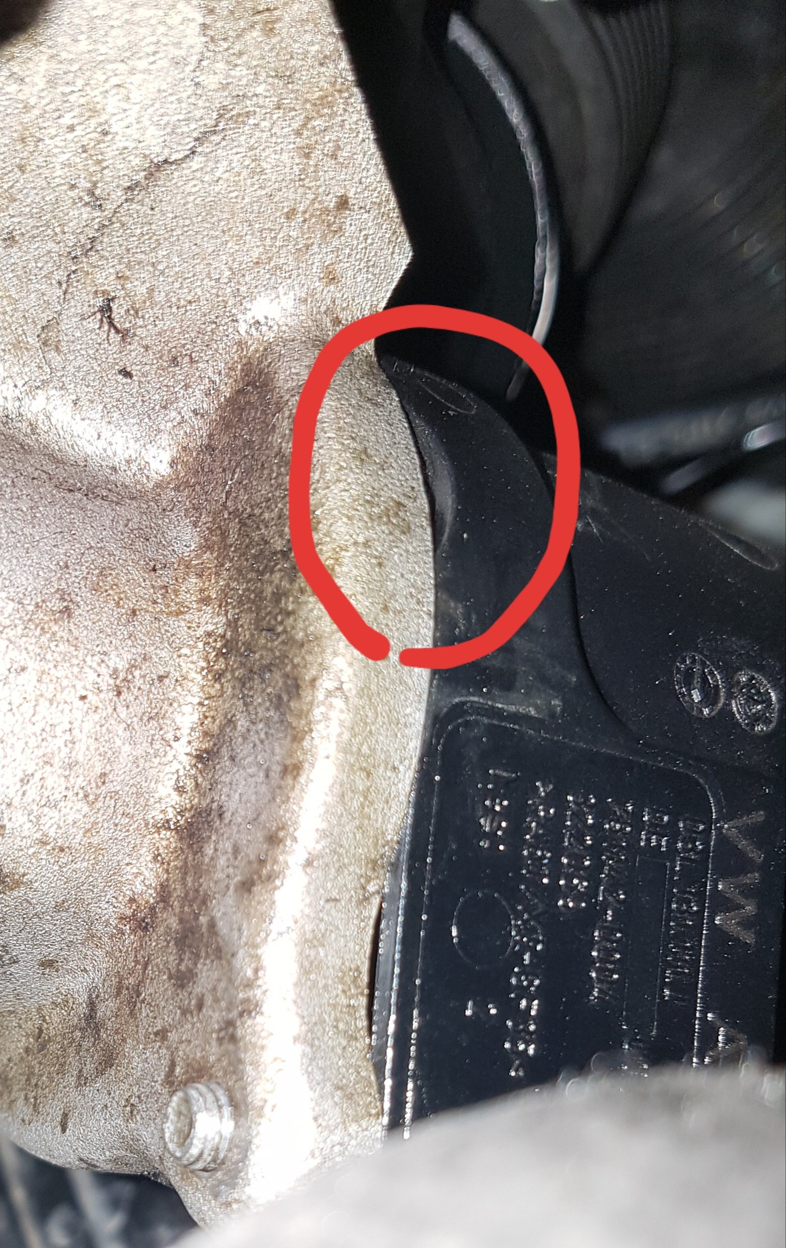

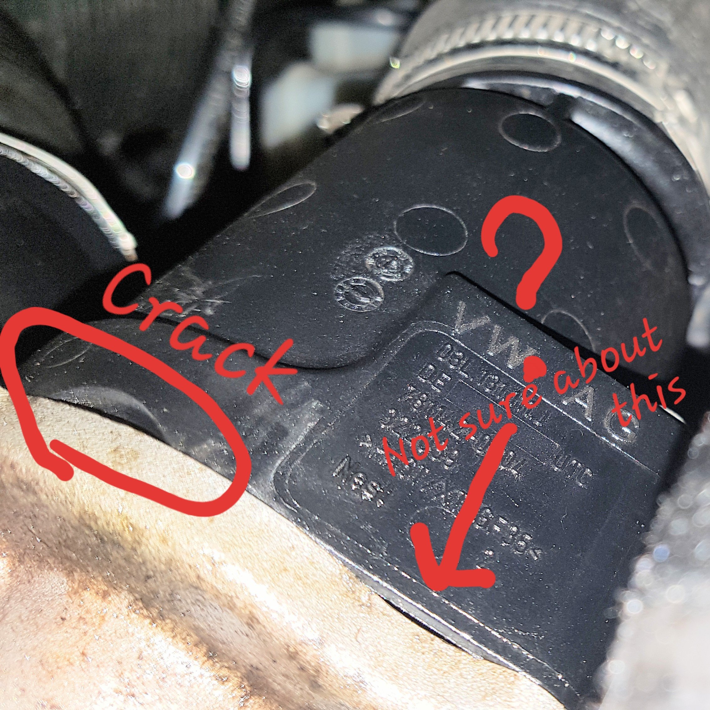

How about these ones? I think it is the root cause.
Seems like oil comes from that crack. Will order tomorrow new damper and o-ring.
20191111_230803.thumb.jpg.517c2655017d4e0f138f3edfa85c6491.jpg20191111_213242.thumb.jpg.88ee56b9837d5c6b4b7b6a703ae5a554.jpg
And, seems like stream from crack lands on on metal cover and drops down on EGR pipes(central surface on metal cover was rubbed by hand, that is why it is clean)
So if you're using a new dampener then don't use the teflon on the bolts. I used the same dampener But with with new O ring and a little teflon to stop the mist coming through the crack where the bolts sit on the dampener

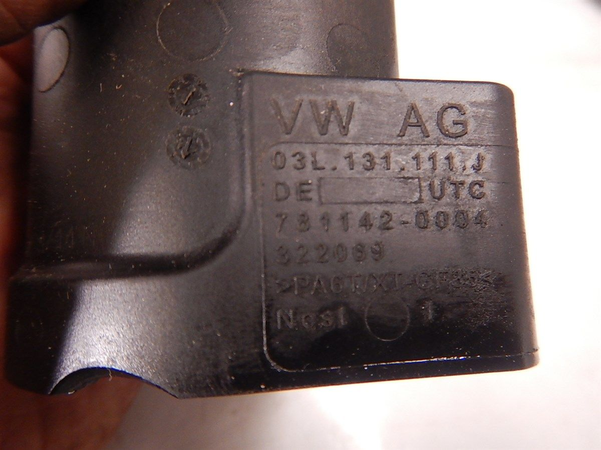

BTW, did you use such one? >>>
Yes that's the one
heh, Bertie, not so fast, this figure isn't crack there, here you example of new damper, as you can it has same stuff on the edge.
So, I think I will hold myself with ordering damper, just start with O-ring and tape.
