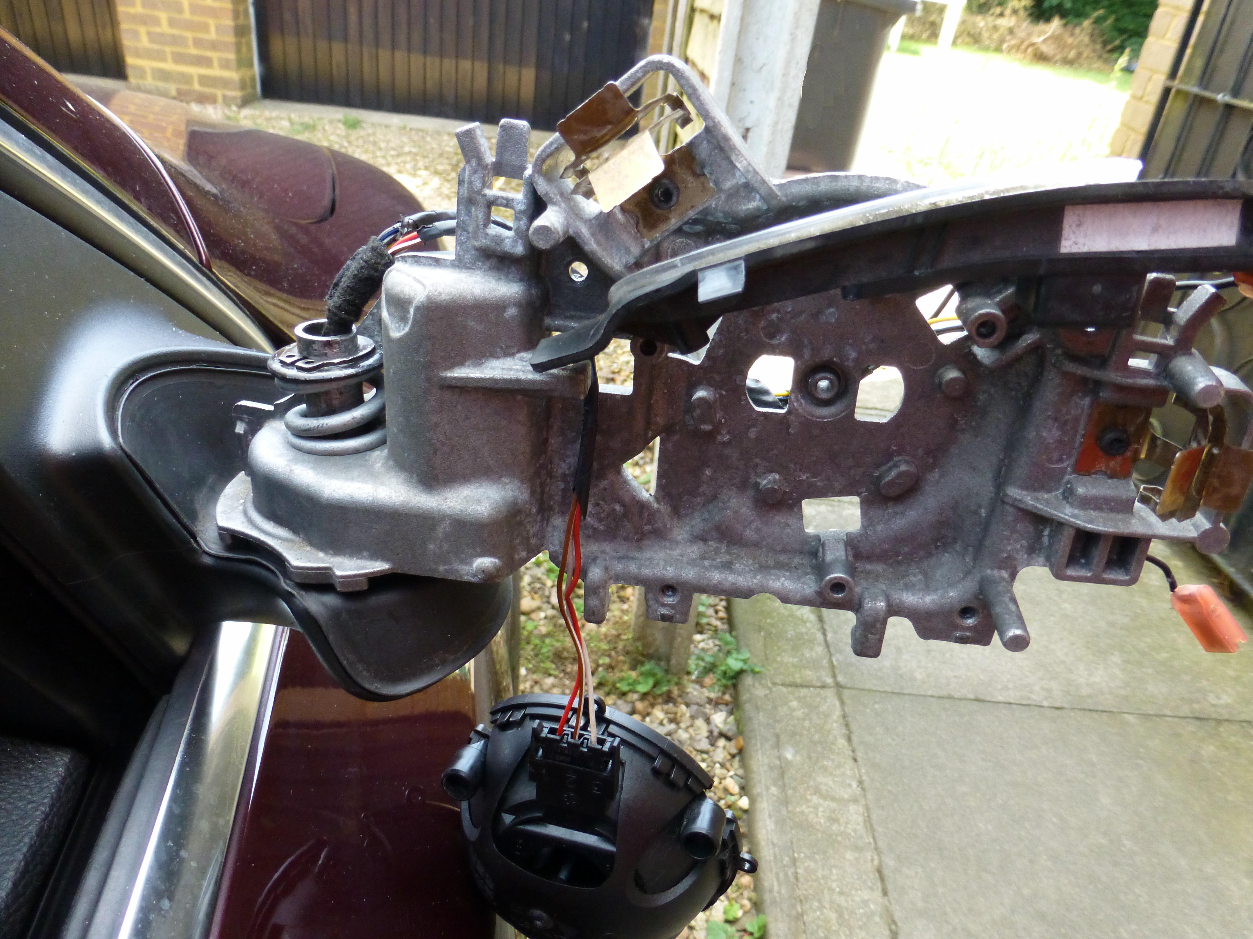

My mirror suffered the same fate as yours three years ago, except my car was stationary, when it was struck by some a******e in a flatbed transit, who didn't stop.
I did a modification/repair to the casting, but it took hours of fiddling and experimenting, and if a secondhand mirror was available then I'd go that route.
After removing the complete unit from the car (door card and tweeter needed removal to access 3 fasteners and cables), I 'squared off' the broken castings with a file to remove the cracked remains.  I then cut a short piece of hollow steel pipe (off some old, scrapped furniture) and cut a circlip groove at each end. And drilled the remains of the casting to the outside diameter of the tube.
I assembled all this, whilst holding the spring (shown in picture, after repair was done) compressed in a vice.  This was an absolute bu***r of a job, and took ages.
The spring is extremely stiff, and the wires pass up the middle of the new tube, as they did before.  This means all the connector ends have to be carefully removed to get them up the tube, then refitted.  It will be harder on an Elegance as there are more wires and motors.  As the original casting is so thin (puny?), there is more room in the original, hollow, cast tube to pass the wires that you Elegance jonnies will have to fit into any modified bits.
I initially, briefly, considered gluing it, but, when it's apart in front of you, you can see the stresses would overwhelm the bond, and it would never fold afterwards.
HTH

I second everything CombatWombat said, great repair by the way!
Gluing it probably a bad idea, it'll be unable to fold when hit so it'll either snap again or cause damage elsewhere.
Couple more images of the bases and the underside of a electric and manual folding version, getting the cir-clip in and out is certainly a challenge.

THANK YOU, very interesting/useful
Surely the mirrors are designed to snap at a certain stress point to prevent injury to a pedestrian?
Perhaps this adaptation could now cause serious harm and also perhaps tear the mirror out of the door should you hit anything else?
The mirror folds with much less effort than it did before due to the spring preload being less.  Because of this, instead of snapping off next time, the mirror is more likely to fold out the way. I have absolutely no concerns about this change harming a pedestrian or damaging the door.
