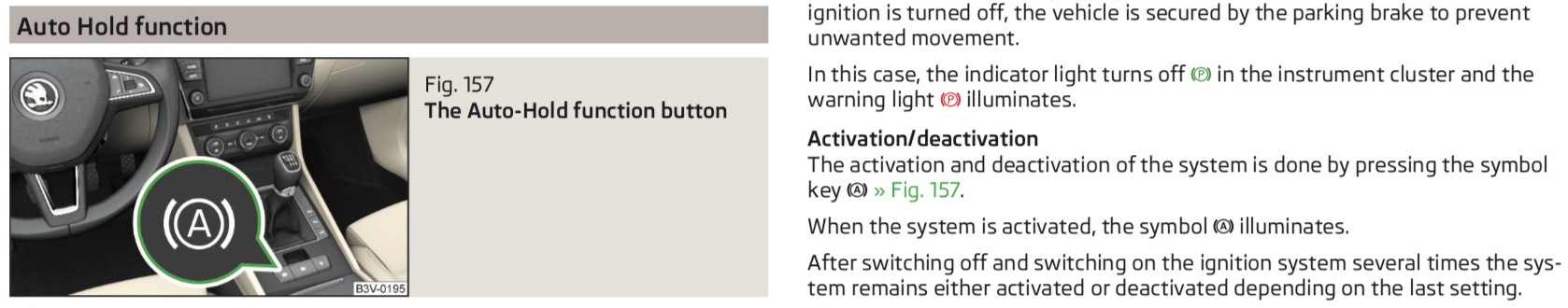

40 minutes ago, SiSuperb said:
Is there a way to disable the AutoHold function
RTFM...
5a0ac1c88829f_ScreenShot2017-11-14at10_11.thumb.jpg.abc1cf719b3ec0603ecac538a414d407.jpg

BillyJim... read the manual, LOL I can't believe it's that simple. Honestly I thought it was a much more complex issue than the simple press of a button. When I got the car, I vowed I would read through the manual to make sure I understood everything. A year on, I still haven't done it :)
Funny though, I did lots of googling and searched the manual... must have just used the wrong terminology!
I shall try it out.

Seems like turning off the AutoHold has solved a lot of the problems. I can see that I'll be turning it off and on to suit whatever driving I'm doing but that's fine for me. Talk about the solution staring me in the face!! :D
NickNorman - yes the 'two dabs' is exactly what I was doing. Most of the time though, there was quite a jolt when moving off. Turning off AutoHold sorts that problem (although you then have to keep your foot on the brake, or apply the electronic handbrake so it's a swings and roundabouts situ!)
