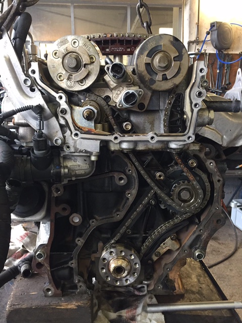

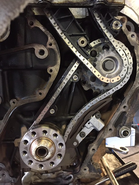

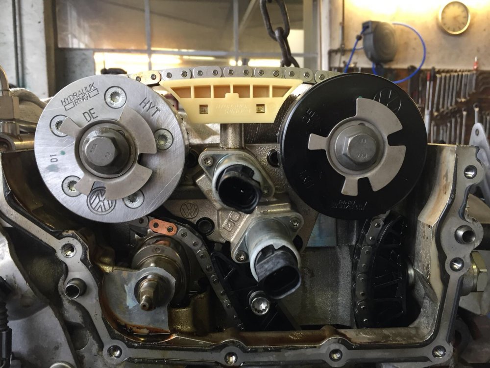

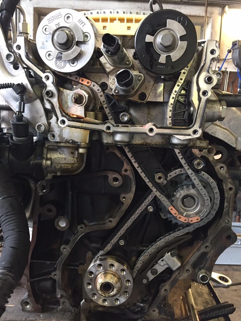

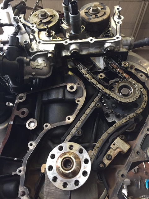

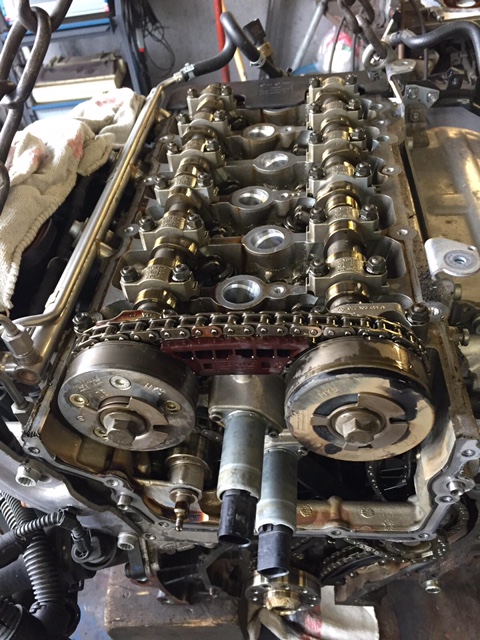

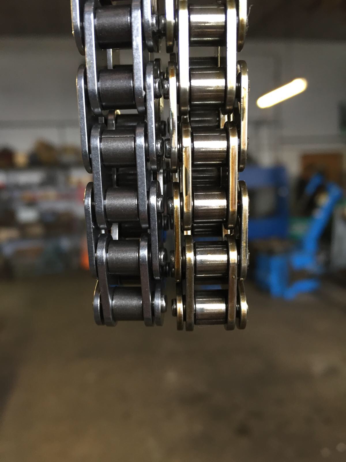

Well.....got car back. Engine all fixed and issues there sorted. Top chain had stretched (see photo) due to failed sprocket bearing thingy (tensioners were fine) but everything replaced just while we were there...
Problem is I now have (the garage thinks....) Mechatronic failure which is a bit weird because it was fine before....new oil and filter in gearbox might have highlighted the issue....so next part of the saga continues. Watch this space.....
Dave

Car now back and running beautifully. Issue was not a mechatronic failure but a reassembly issue...thankfully no damage but I have a two year (yes, two year...) warranty on the work (a CarXpert garage?).  The car is under a lease so not allowed to do it myself (or I could but I have to pay the lease off....).
Anyway, fingers crossed all is good....now my wallet is 5000chf lighter (£3800) :o They charge 180 chf an hour labour here (£140)....barstewards!
