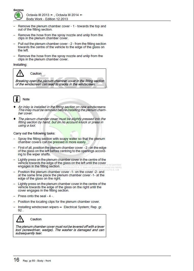

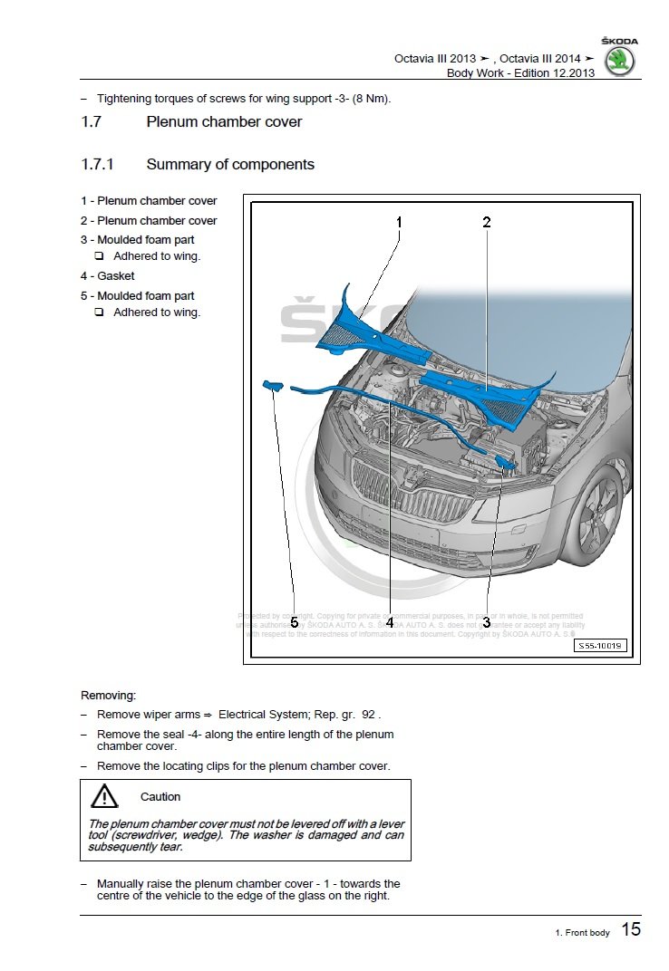

A guide on removing the plenum chamber cover for you.

Hi Dunc, I believe these are the instructions.
1178756742_page1plenumchamberremoval.thumb.jpg.bbaa23cb8a8f1a7005cb819b1051098c.jpg1047961149_page2plenumchamberremoval.thumb.jpg.8a8d2625a5f3fb980eb0f2e1d609b110.jpg

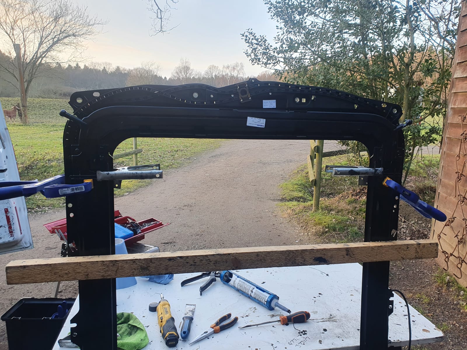

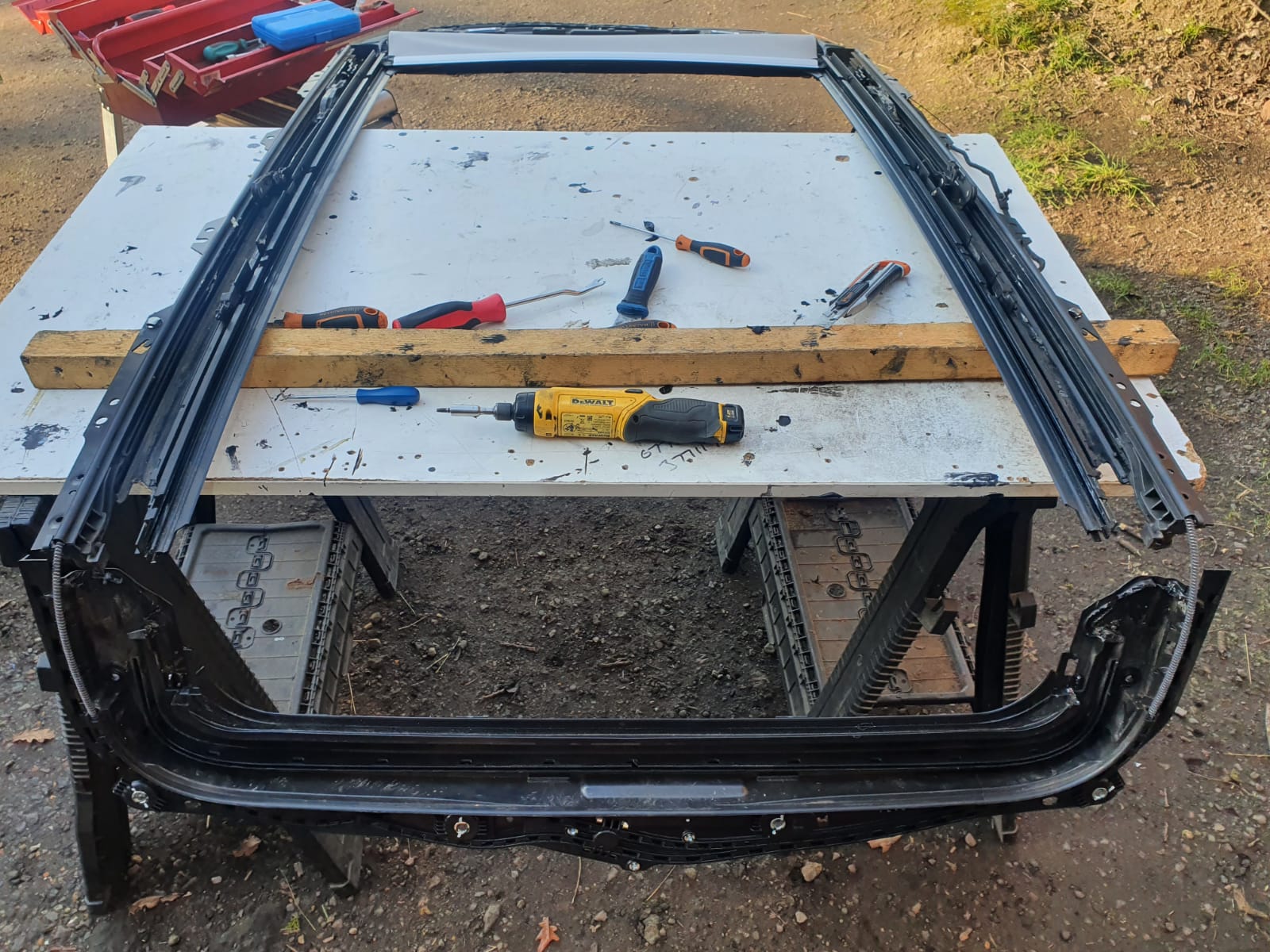

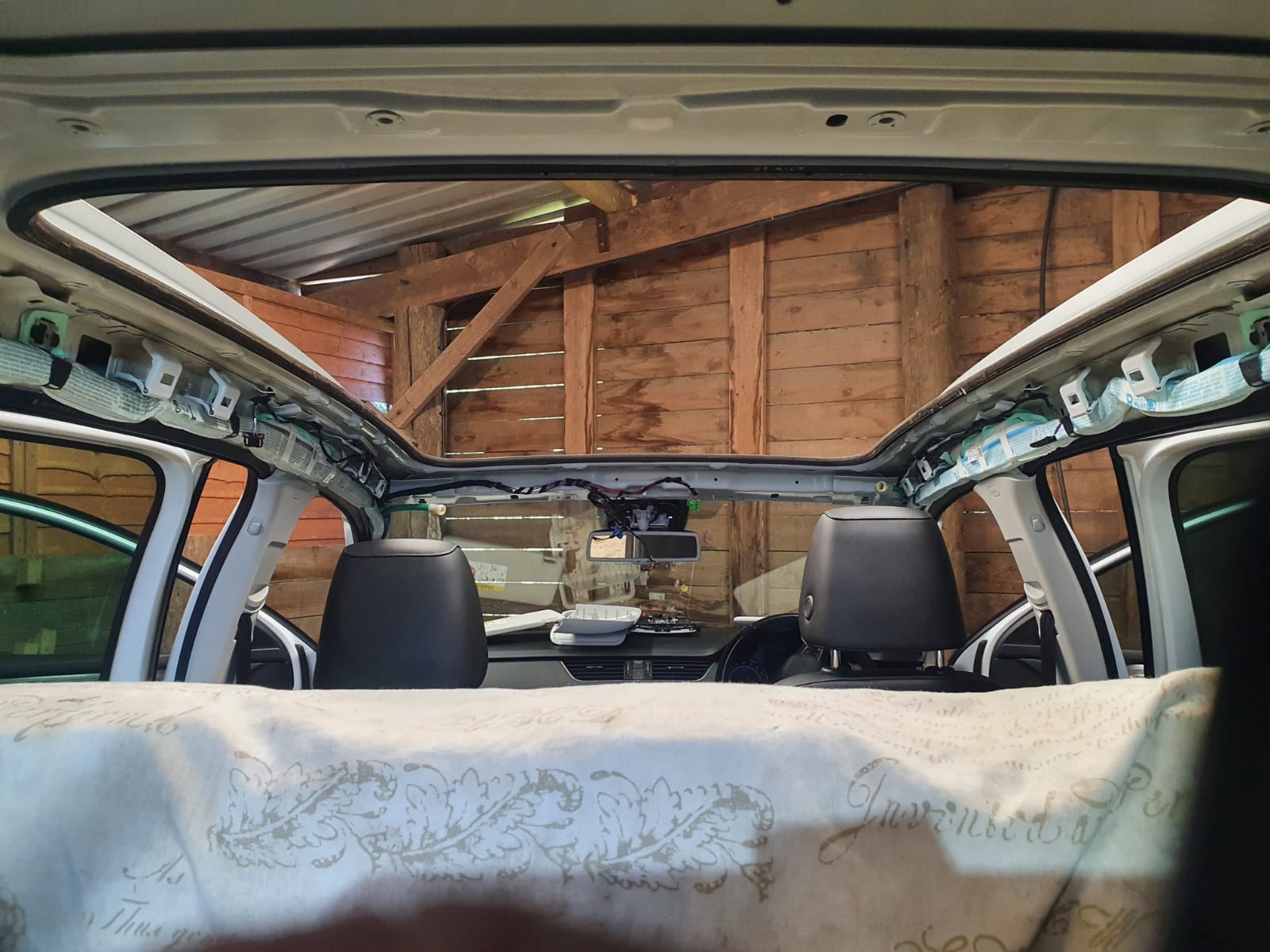

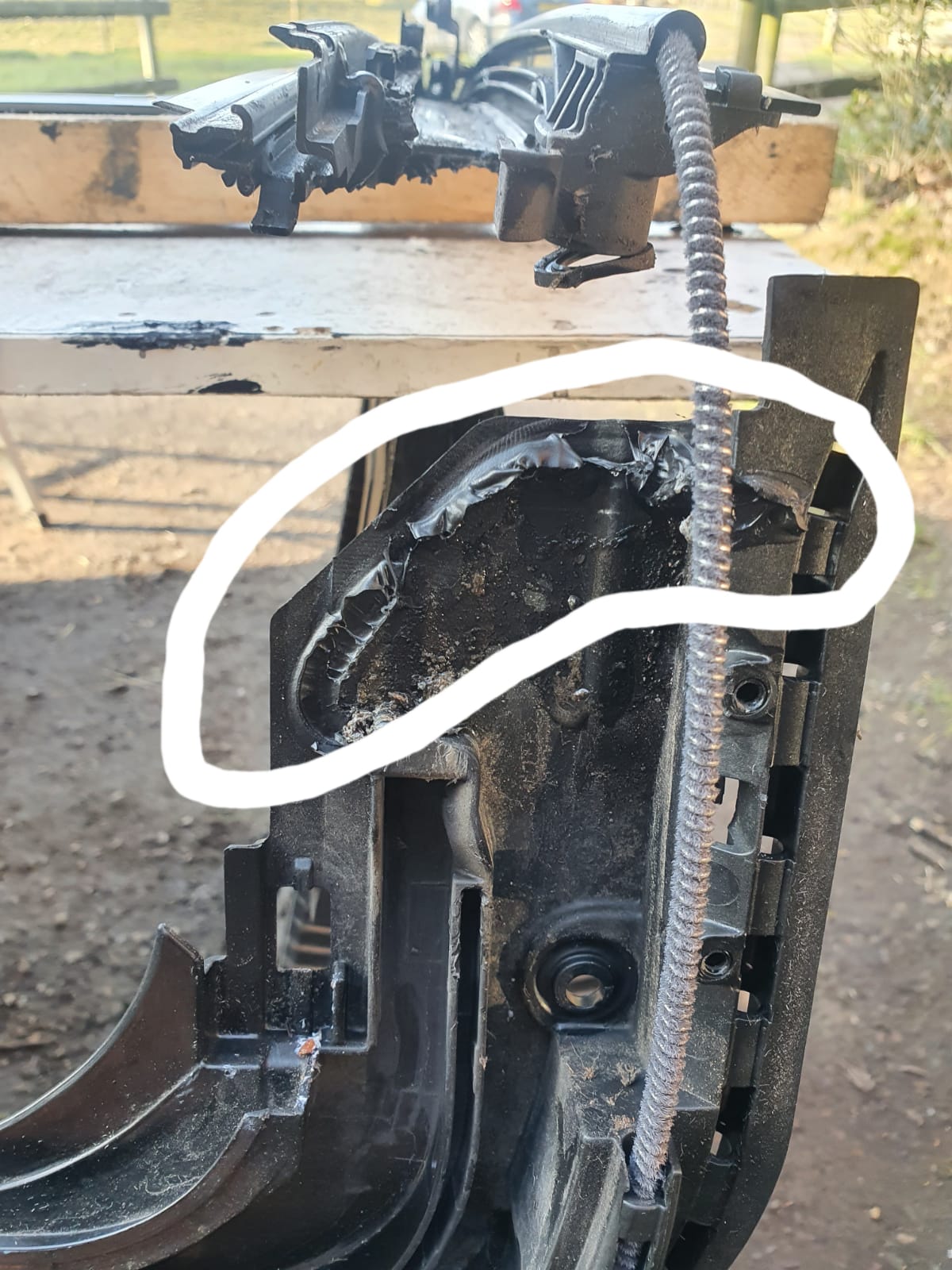

Had a similar issue. Cleared out drainage channels. Then further investigation showed the seal between the sunroof sections had failed. Whole thing taken out, re-bonded, new rubbers, roof rails removed, checked and re-sealed. I’m rather hoping that sorts it once and for all.
Edited by Rob74
Wow, that looks like a lot of effort, although I'm looking to do the same.
One thing I'm stuck on though is how to remove the sunvisors near the windscreen. Any tips (I realise this is almost 2 years ago...)?
All this work was carried out by Andy at Surrey Sunroofs. Can’t recommend him highly enough.
