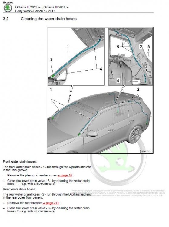

These photos may help your investigations.

Hi
Thx @stu53 i see the "3-Front drain valves" are placed is where i see the water starts to come visible in the car behind a-pilar cover..
I think one of two, that the leak starts there or it starts where the hose its conneted to the sunroof, if so its running inside a-pilar cover and coming visible at same spot.
So then i think i will see the valves behind the cover when i open the hood. Thx again :thumbup:

Hi Ken
A guide on removing the plenum chamber cover for you.

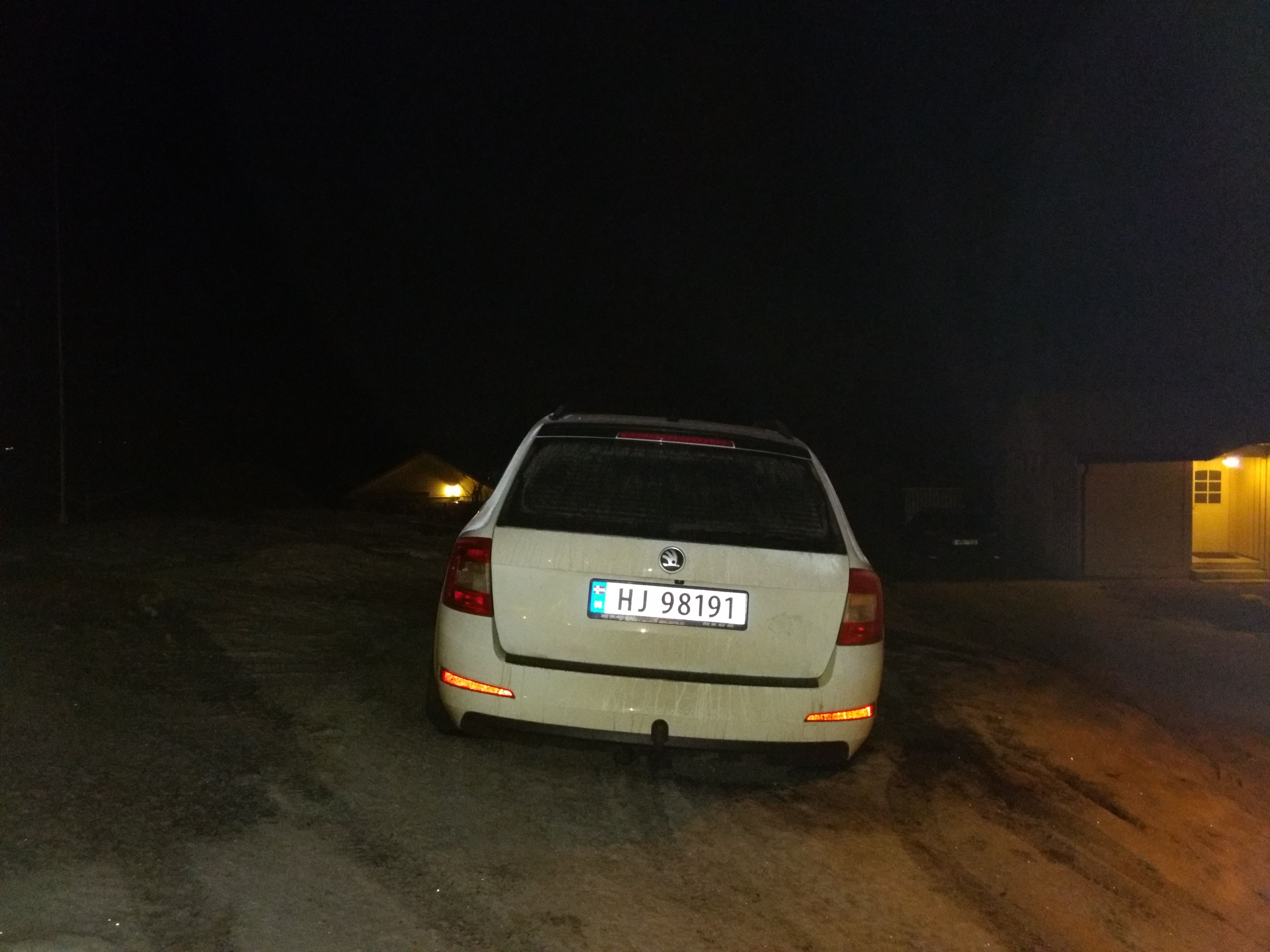

Now there it has been a rainy periode and the car is wet in the flor at passenger side front and rear again. And i get water at my fingers when i drag them along the inner edge from cupe along the sunroof.
I wonder are my car to mouh in angel when its parked???
Itsalso leaning backward a 2-3 degrees. See pic i take yesterday.
I hold phone inn water level when taken.

I have meassure the car is standing in an 5 degree angel when its parked.
I cant imagine Skoda or sunroof manufactur mean that is to mouch angel...
Mine was exactly the same - I ended up having all the carpets replaced under warranty and the sunroof and all of the headlining out.
They never did find what the root cause was - I had water dripping out of the courtesy lights in the rear! They tested the drain tubes and they were all draining fine and no leaks. It seemed to be overflowing the channels that the sunroof fits in and then running down the inside of the A-pillars - my door seals were wet underneath from about halfway down the windscreen.
Like you, my drive had a slight slope, but the opposite way to yours - about 5 degree front to back (front lower) and 5 degree left to right (left lower). The left hand side footwell was full of water.

Ok, so i finnaly managed to solve this issue by myself. My problem was the panoramic sunroof front water drain hose which run through the A pillars and end in the rain groove. The lower drain valve (no. 3 in the image) was fully sunk with dirt and the water was totally drained inside the car. I just had cu clean it up and thats it. Thank you for your cooperation :)
@cristi_r22 how do I get to the lower drain valve (No. 3) to clean it?
Any advice appreciated!
Thanks!
Thanks!
You need to remove the plenum chamber cover from the A pillar. Just pull it hard outside, but carefully. Then you'll have visibility to the lower drain valve.
