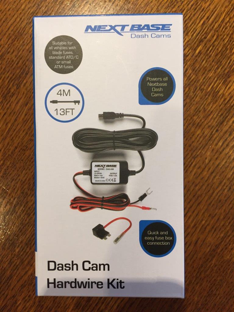

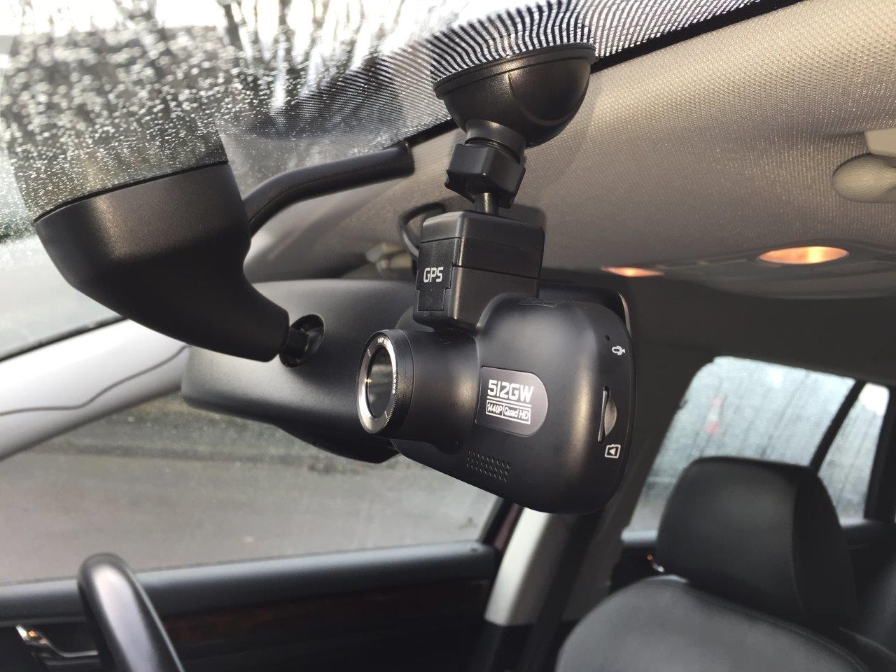

My photos show Next Base camera and separate wiring kit, but I'm sure others are similar. I only chose this one because it was in the Which magazine.

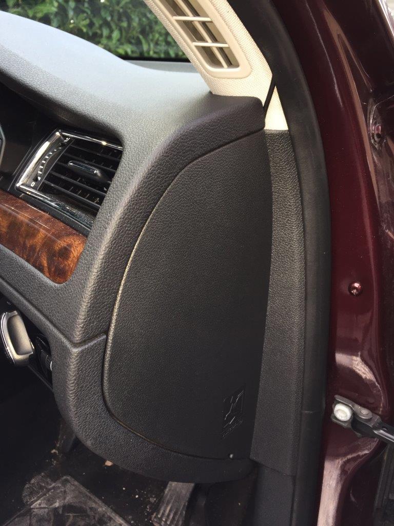

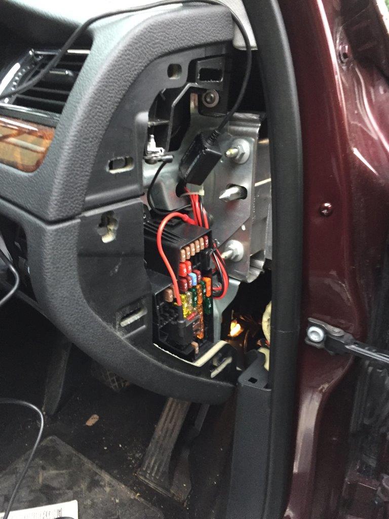

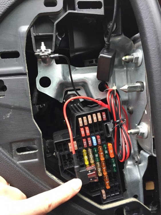

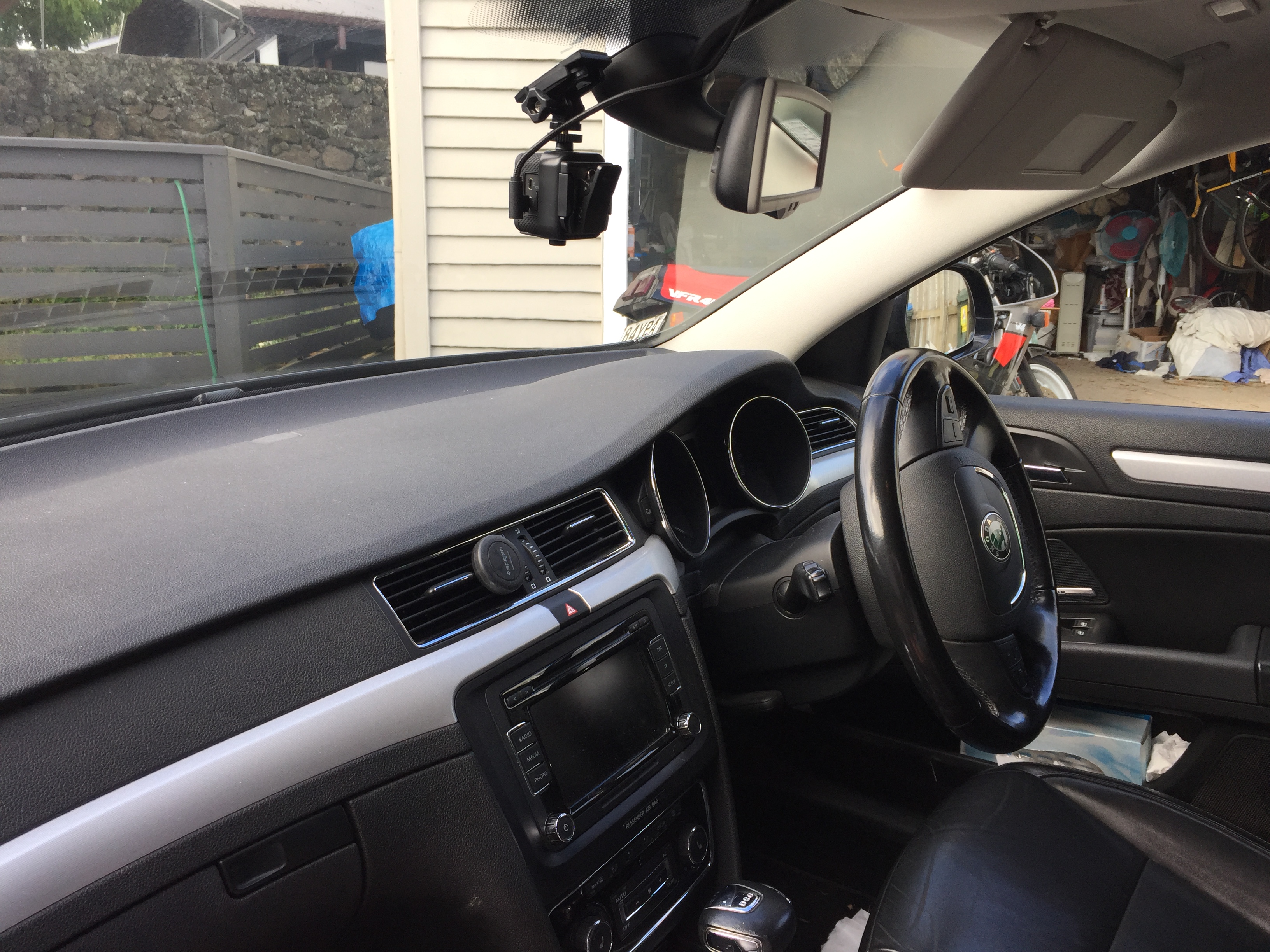

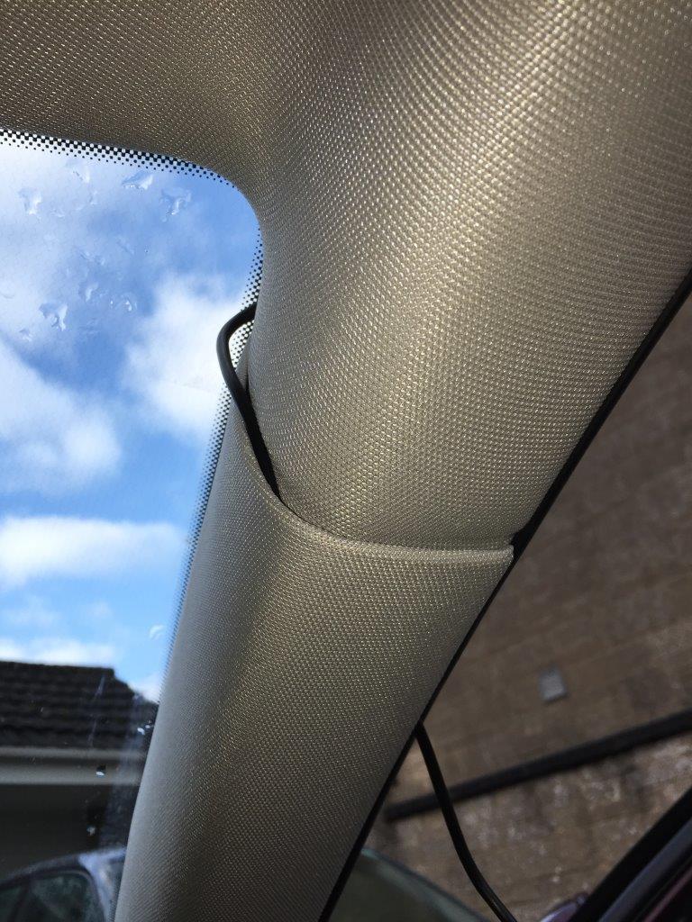

Used the suction pad to mount the camera, then power wire pushed behind roof and pillar lining down to the fuse box.

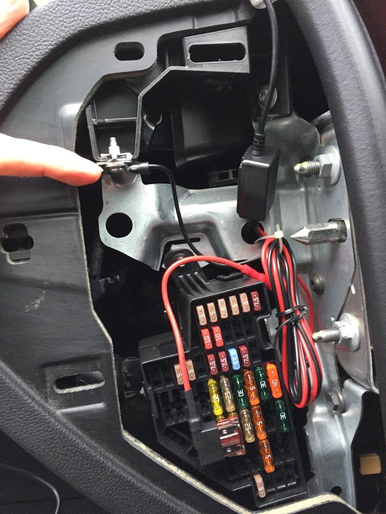

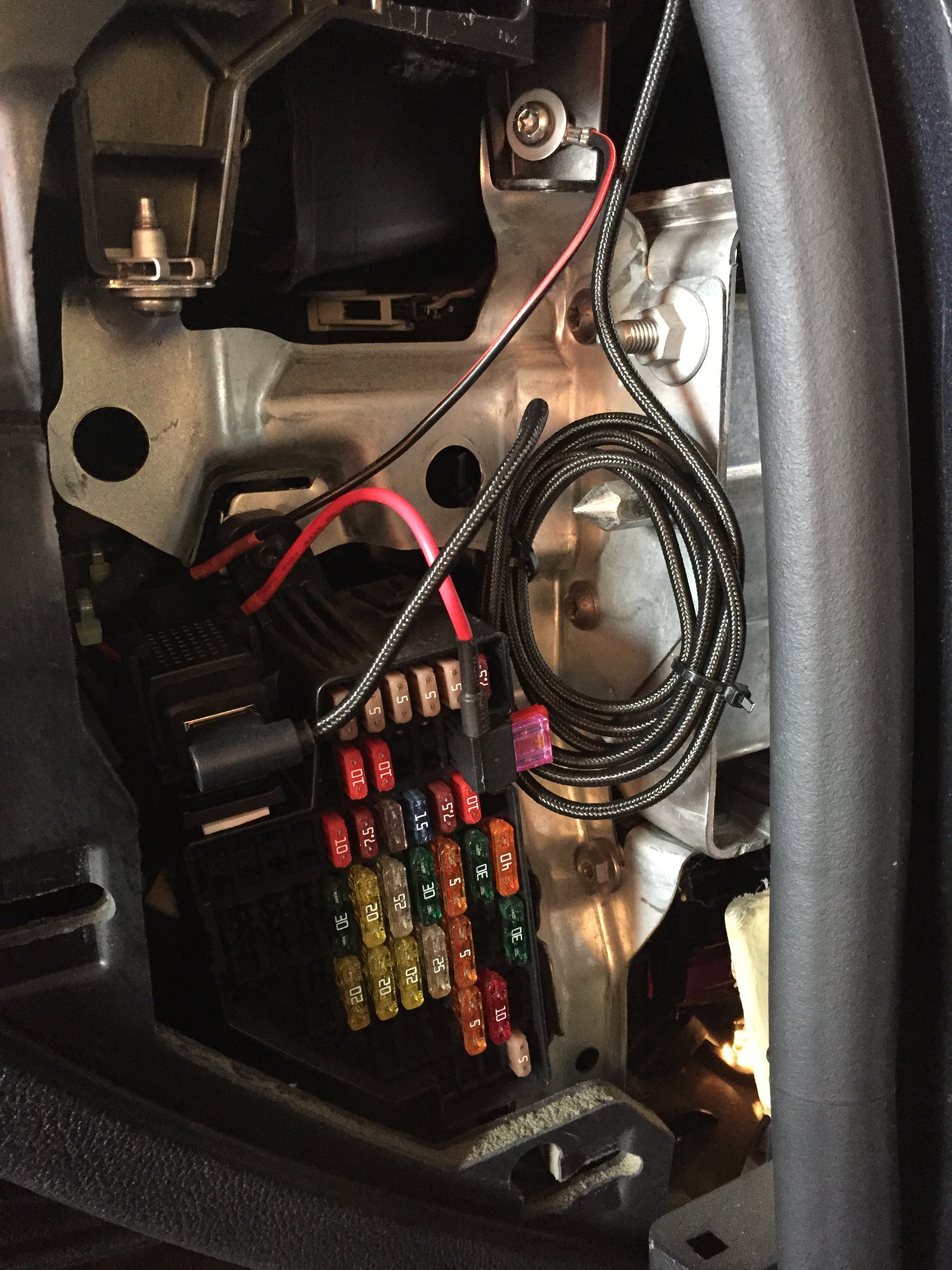

I used the supplied fuse jumper/doubler to take power from the rear wiper fuse slot.
The negative was then fixed to one of the screws on the metal points in the fuse area.
See photos. Easy work for more peace of mind while driving.

You can get an even cleaner look by removing the A-Pillar trim and hiding the wire behind it. The trim is only held on by plastic clips so is easy to remove and replace.
Quite a lot of similar dash cam set-up guides using piggyback fuse holders here...
Yup, that's what I did, removing the A-pillar cover (the photos were just work in progress stage). No wires can be seen now.
The hardwire kit came with smaller and larger standards of piggyback fuse

Be careful with running wiring down the A pillar that it's behind the airbag. Otherwise it could be nasty in a crash.
