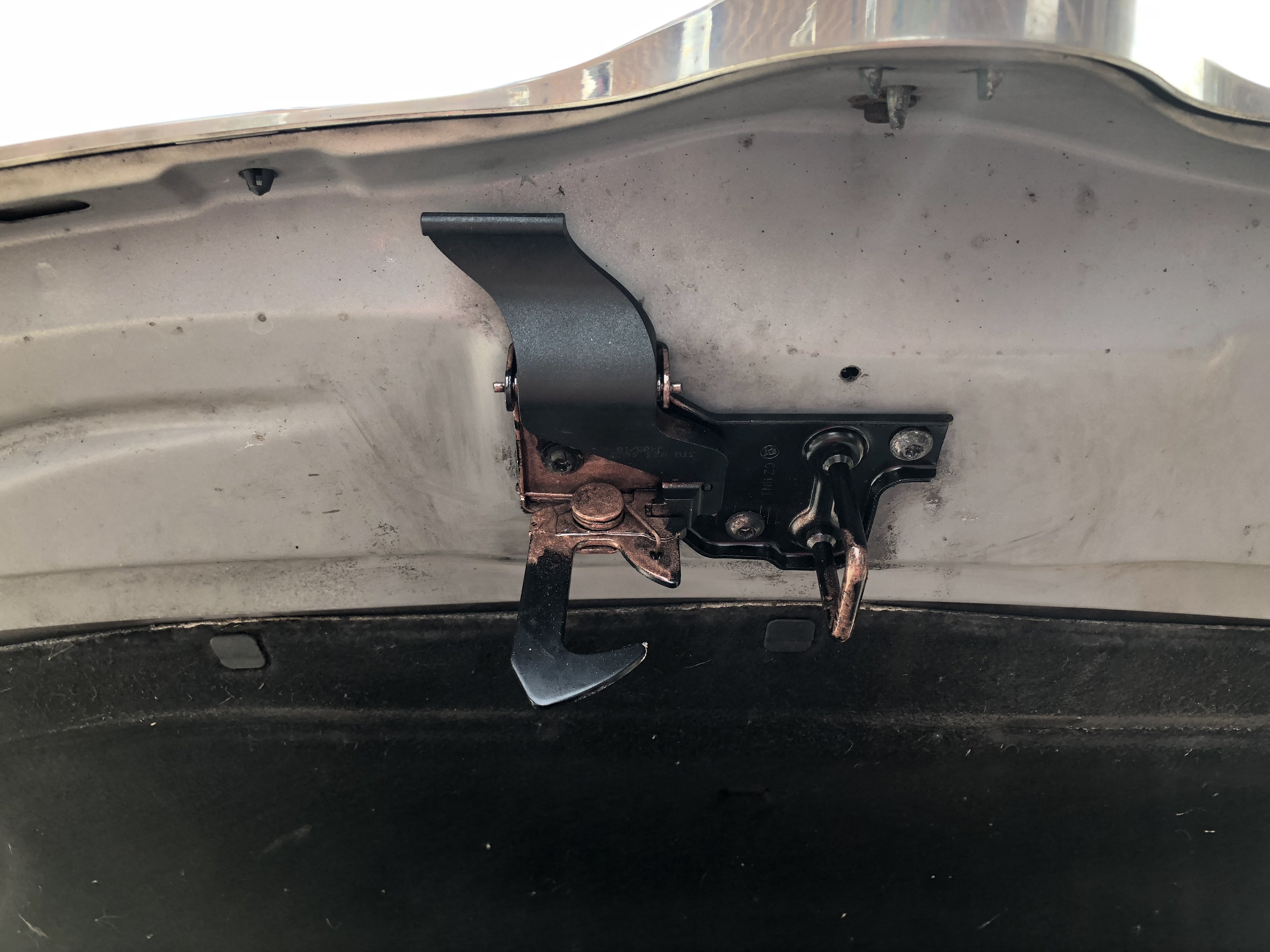

Had a look today while I was filling the washer bottle and I've given it the lubricating from hell!!!!! :D
Tried again and still the same in that the handle only moves the catch around 80% of its full movement so just not enough to clear the bar it hooks around.
As tifertwo mentioned above it is indeed only held in place by three torque screws as can be seen in the pic.

Its the actual handle (lever not the hook) that seizes the bit in the picture that is pivoting on the horizontal axis if you know what I mean:wondering:
Edited by DEL80Y
I know.... I've lubricated the handle/lever pivot points as well as the hook pivot points to no avail. with the lever pulled to its maximum it's only moving the hook by around 80% at most which isn't enough for it to clear the loop it catches around.

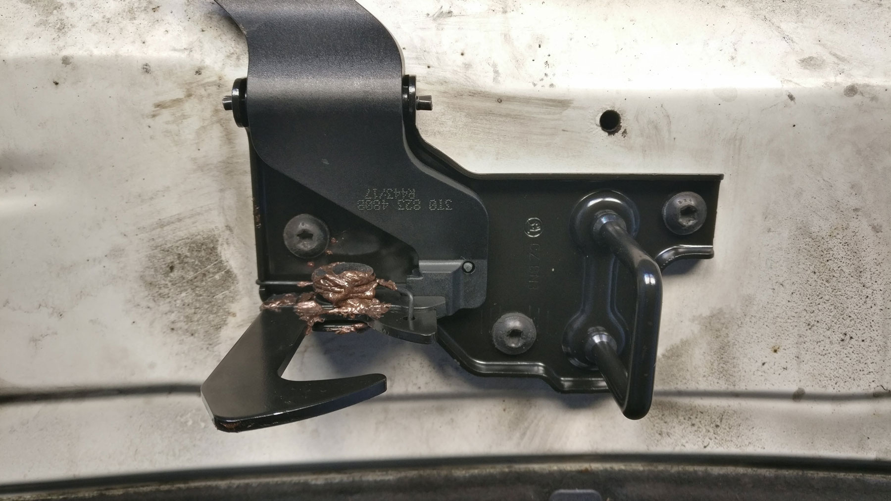

Well, I have the new part in place. As people have said, it is the lever pivot point that seems to sieze - either that or starts to flex as it ages - or a bit of both. The part number is 3T0-823-480-B, and the part description they  use is just "hook". Part number is in fact marked on the part, but you have to do handstands to read it.
I greased it up with some copper grease before fitting it (on the lever pivot as well as the hook spring) - slightly miffed that I couldn't find my tube of threadlock for the torx bolts, but they seemed to go in nice and tight.

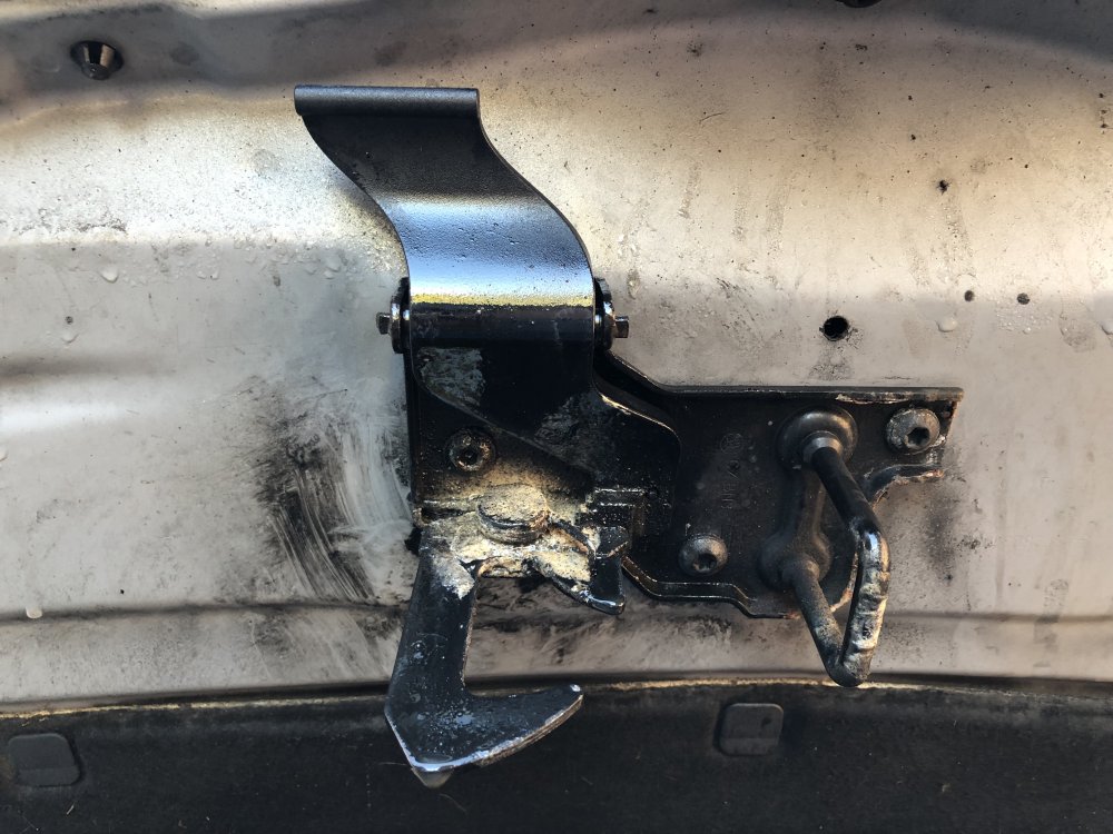

Got caught by this. Could not fully open nor close so the alarm was going off too!
As ever, the advice on these forums is invaluable. I squirted a load of WD40 and got my biggest persuading screwdriver out and moved the "hook". A 10 min soak and all is well but it really gunky and rusty so a new part may be the order of the day.
I took mine off (it was getting very difficult to open) to clean as obviously access is easier. Cleaned all the parts to fully de-gunge all moving areas. Put it back on (looking like new) and all is well.
