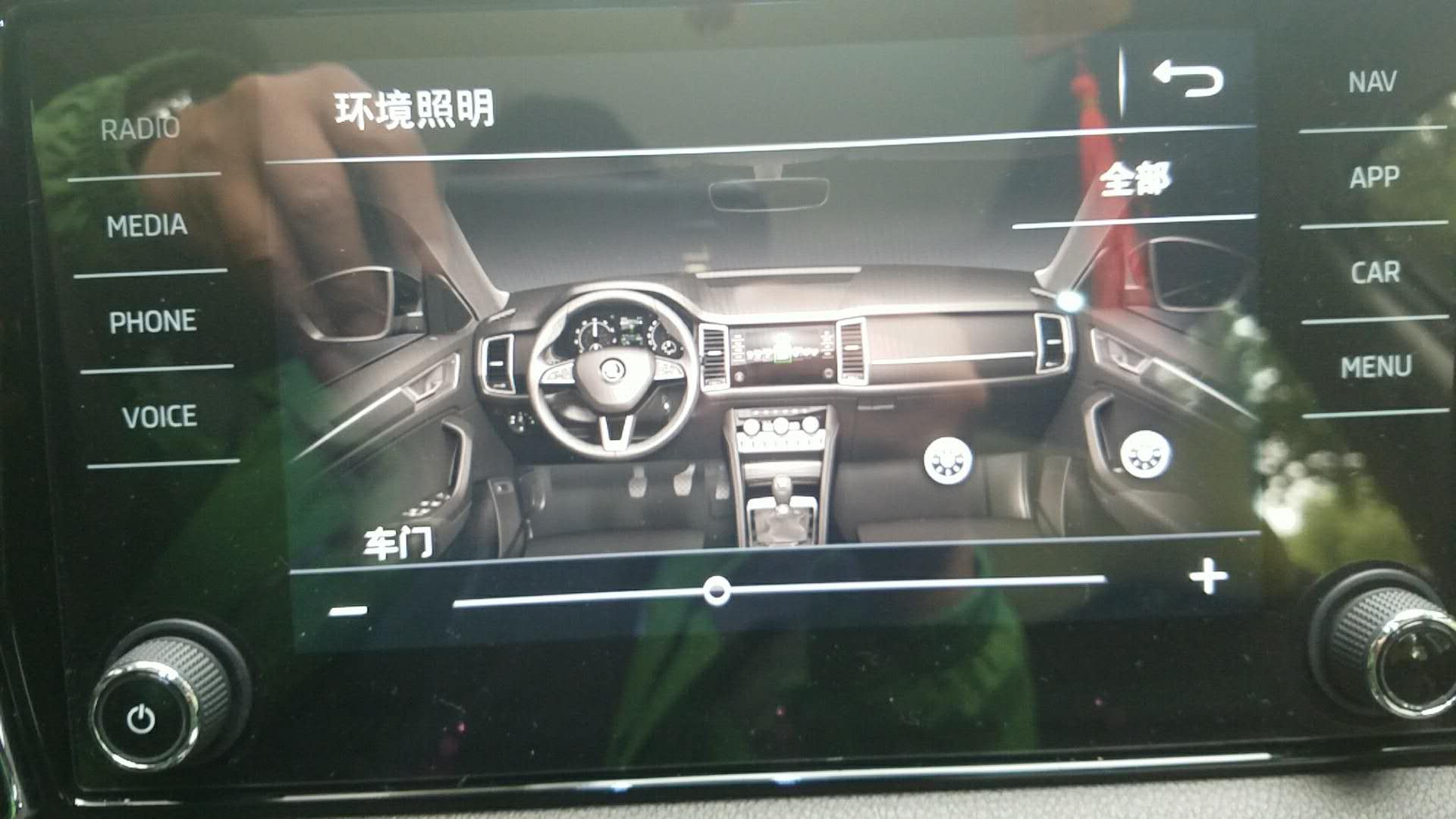

I can't find the ambient lighting colour options in MIB2 with my kodiaq ,but I can change colour only in the vcds, there is only the Lighting brightness control in the ambient light meum ,so whether I can open the colour options and display the different ten colour ?  I brought the car in china,  the Device part number is5Q0035866B ,hardware H30, software 0361。
In the same adaptation channel there should be an option for the menu?
Press on the circle 'target' near the passenger wing mirror and it will bring up the brightness and colour options
Yes,but there wasn't colour options ,only the lighting brightness.
Isn’t it a option ?  Standard here but isn’t in some markets/models from what I have read.
Seeing as I can't read Chinese :) I can't really tell what is happening.

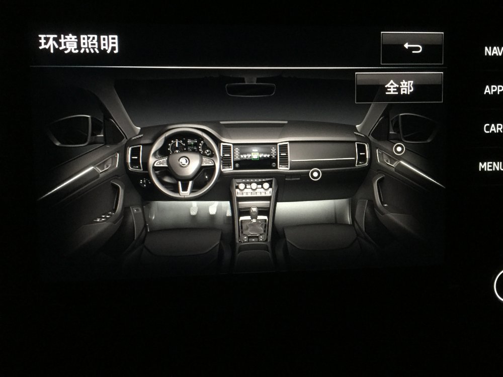

You definitely touched the target on the door and not the one on the glovebox for the footwell lights?
Thanks for your replay,now I had translate the word for EN on the meum.
Yes, I touched the door ,not the footwell lights. Whether the chinese version have no color selection? Do I need to upgrade my device? Or we can change the 5F in VCD to increase the options?
So back to my question - you definitely pressed the target on the door?
Didn't Steven answer that when he said, “Yes, I touched the door ,not the footwell lights"?
Edited by DaveMiller
Ha - missed that! Was too busy looking at the picture!
I've just checked mine and the colour option is there when you are in the brightness setting of doors, footwell or all.
At a guess there will be an adaptation channel on 09 or 5F for the colour menu, but I haven't looked.
