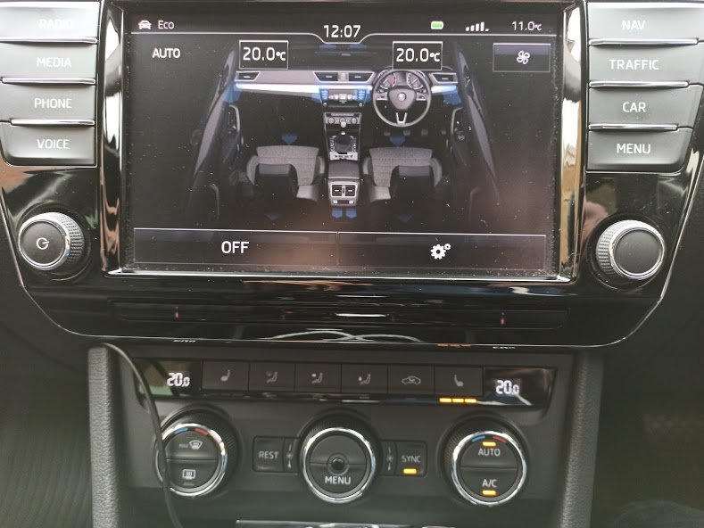

My infotainment always shows the same whether the heated seats are on or off. No option for the seats or the wheel on the screen.
Not bothered if i dont have one but would be nice, and the garage shouldnt have sold it saying it had.
Photo to show it. I take it there should be the option to control the seats from the screen? Any ideas on how to enable that?

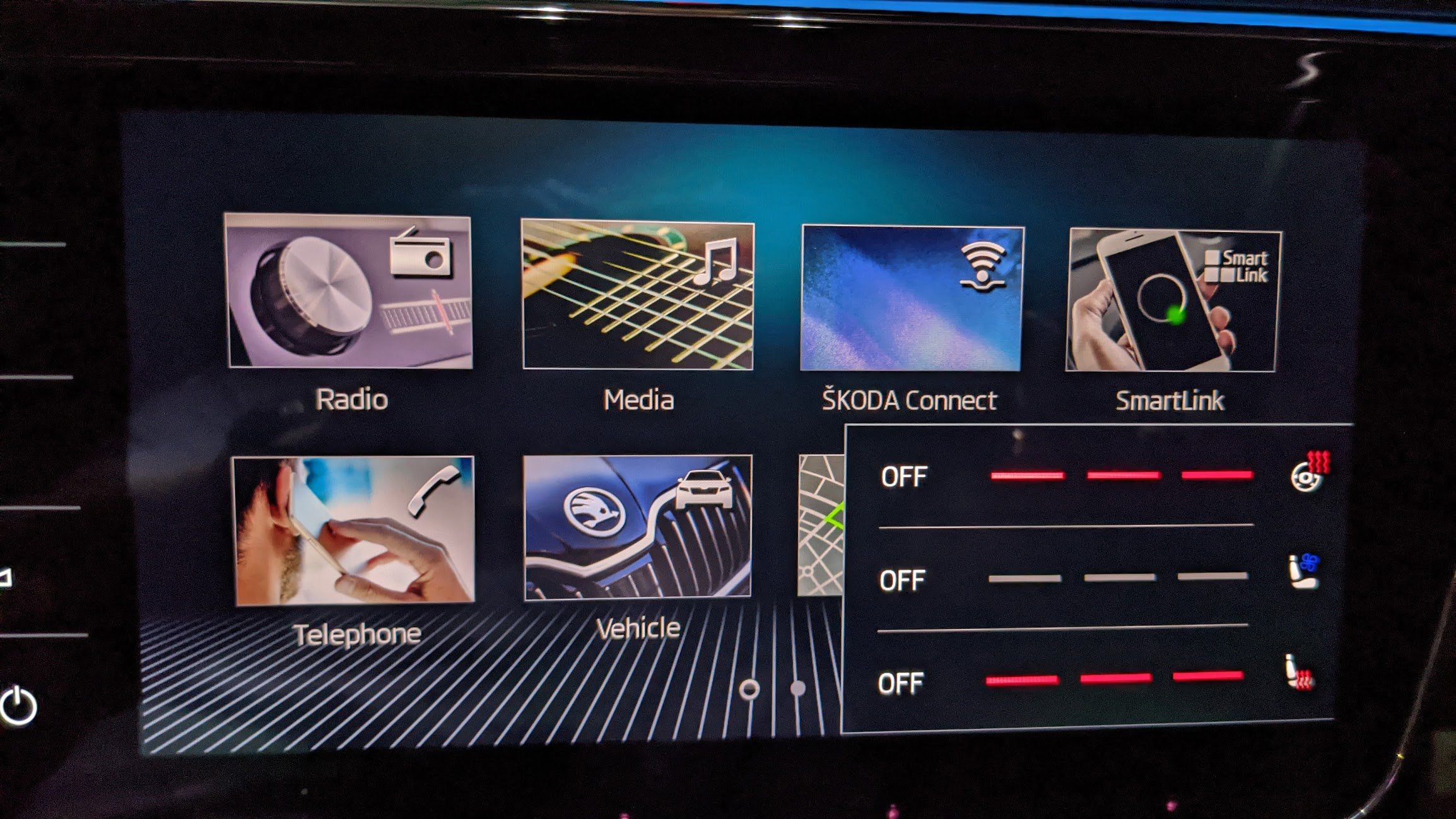

I've just taken a few photos to show what I see.
This is the graphic which overlays when the heated seat button is pressed.

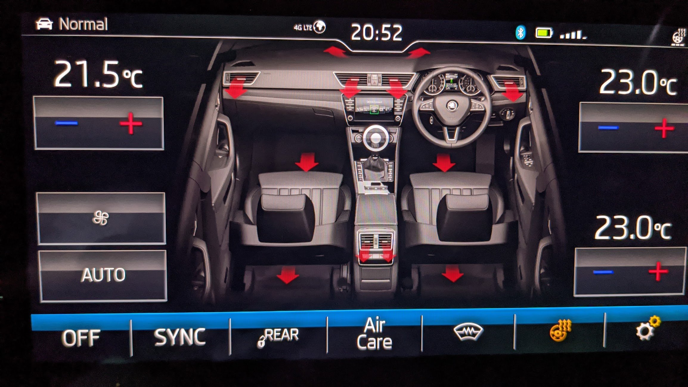

Here's 'my version' of 'your version'.
This doesn't come up automatically but does show the heated wheel status in two places. I didn't think to see if the yellow wheel icon allowed controllability though.

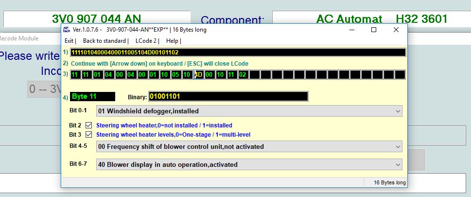

Do you have a copy of your 08 HVAC coding by any chance? @john999boy
For some reason my heated steering wheel layout is different to yours and cant for the life of me see why
