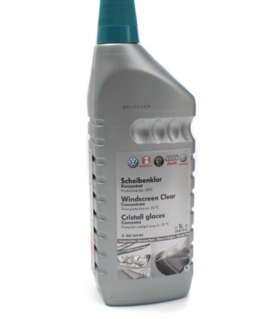

I'm running VAG genuine screenwash - neat...
I use the Euro Car parts -30'c stuff or the Lidl -20'c stuff for years....
Though avoid the cheap supermarket or rain x stuff as they can congeal on the level prongs and provide false low level alerts..
