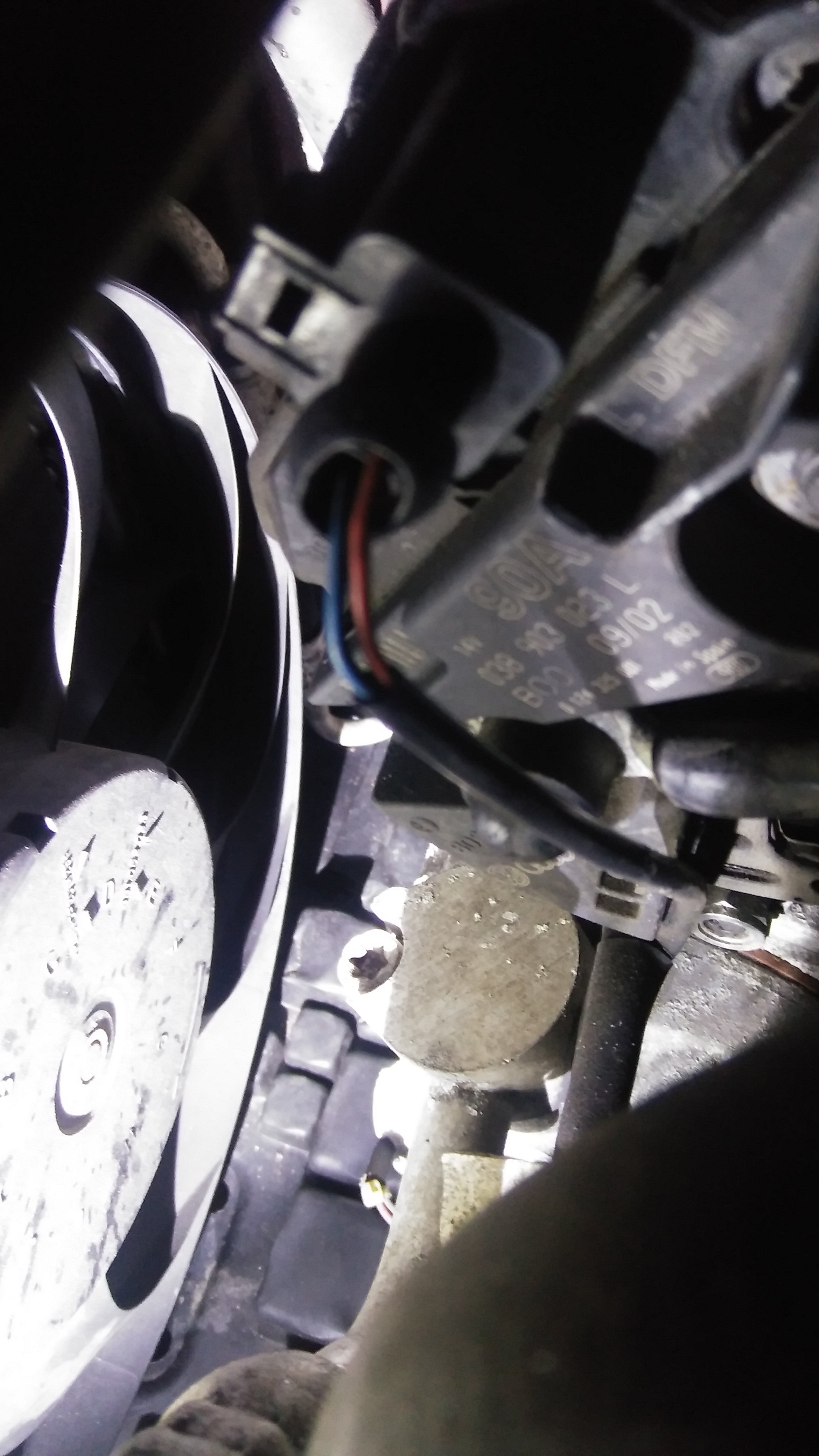

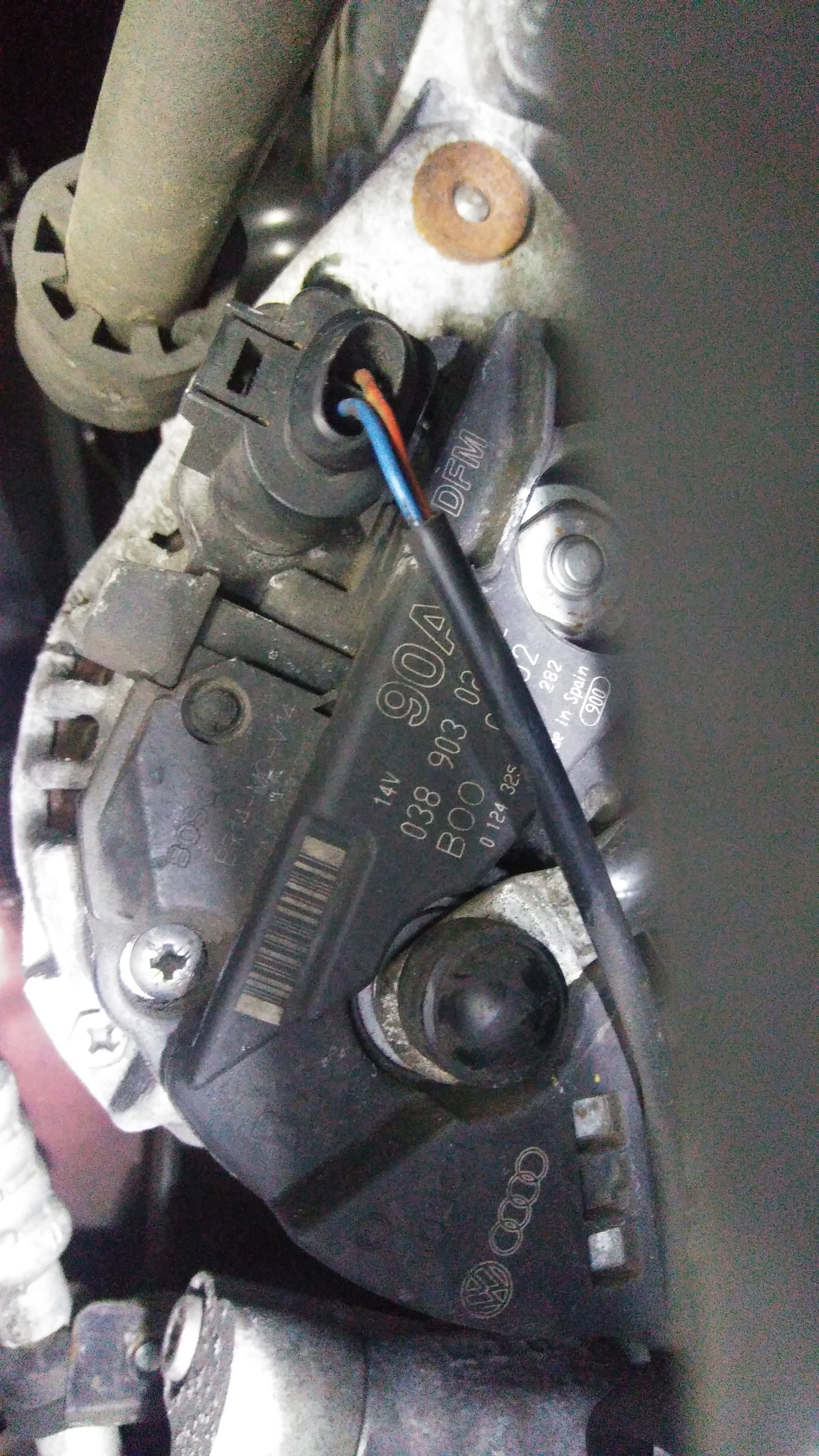

If you can get a well lit, in-focus photo of the back end of the alternator, there may be a visible part number on the regulator/brushpack. If there is a VAG part number on the alternator, that might also be sufficient to find the right regulator.
Edited by Wino
Just not sure which numbers are relevant.
  • Sponsor
038903023L is the alternator part number. Give me a few minutes and I'll see what I can find out.
