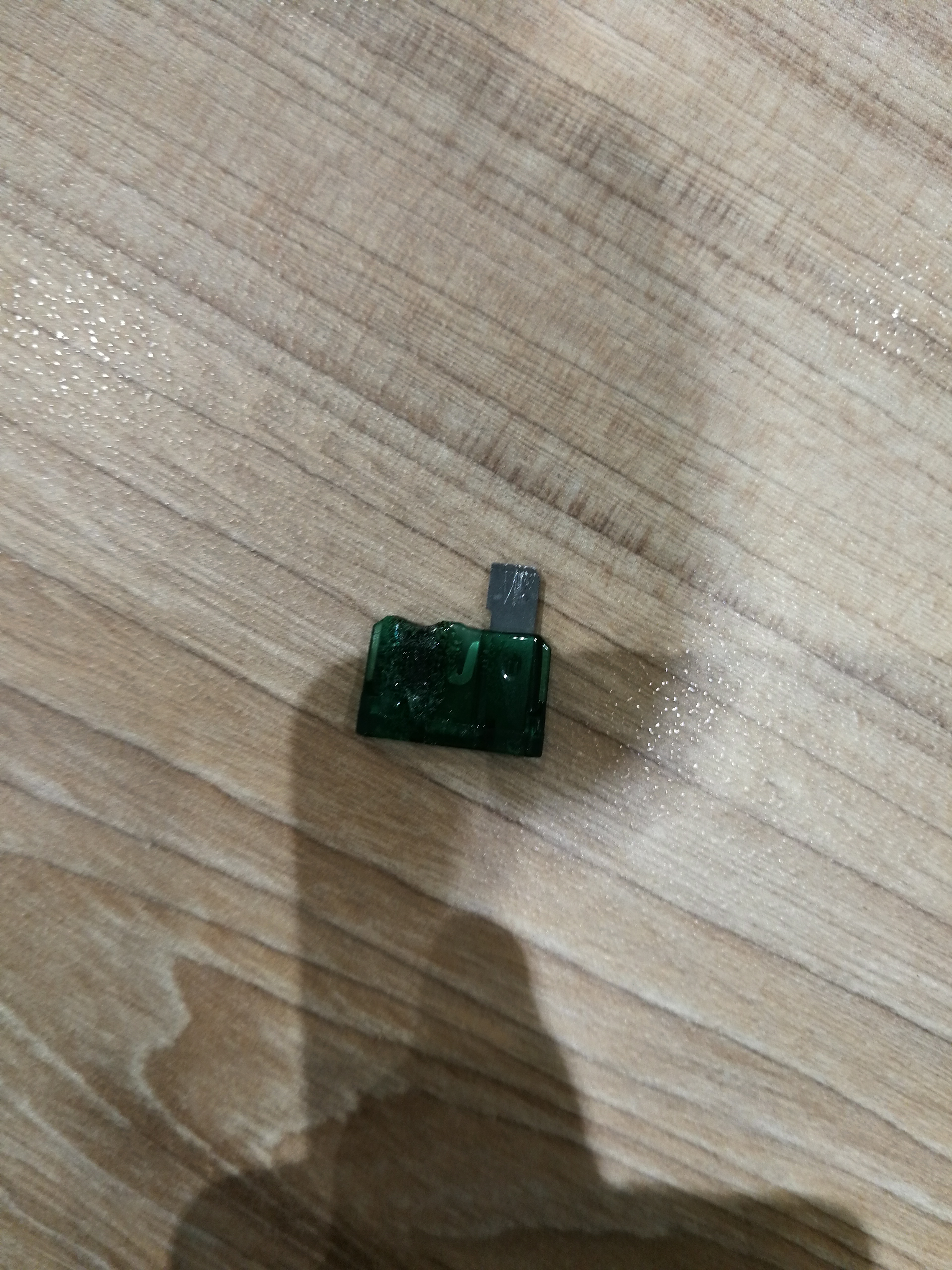

Hello I've got a rapid 1.6 tdi cr greentech se 63 plate. Turned the ignition on and I couldn't hear the fan kick in, the climatronic fan speed is going up and down but no air going into the car, does anyone know what would be the issue.
Well today I phoned up skoda to see if the car is under warranty, found out it is and said I've got no heating. The earliest the car could get booked in would be middle of January where the warranty runs out. She told me to ring skoda assistance which is basically the AA. They came out checked alot of fuses to find out that fuse 39 (30a) was blown and started melting the fuse holder.

The fault has been logged with then, the car is still under warranty and with them right now, got loan car off them for the time being. I believe it's more than just a fuse holder and fuse that will be replaced
Right I have rung skoda today for an update and basically I have been told that the part that has gone is down to manufacturing defect and I won't get charged for the repair (even though I asked is the car under warranty and they have said yes) I will keep an update tomorrow when I have more information.

Well my car has been in with skoda for nearly 4 weeks lol.  heater motor was the cause of why my fuse box went for a melt down  ("pun intended") they have replaced the heater motor, resistor which is different to the standard one, heater controller and fuse box but can't have car back till Saturday though.
