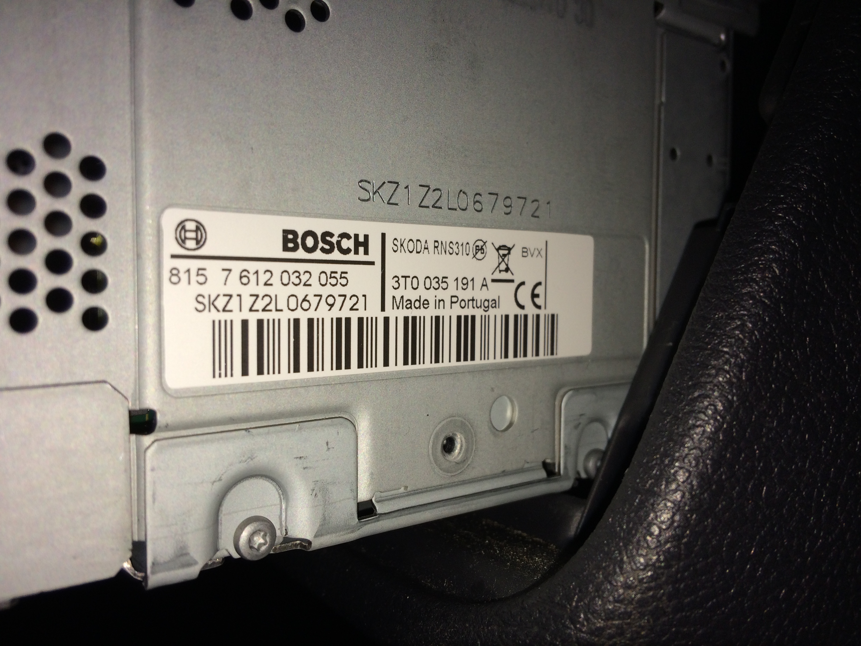

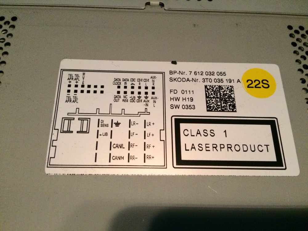

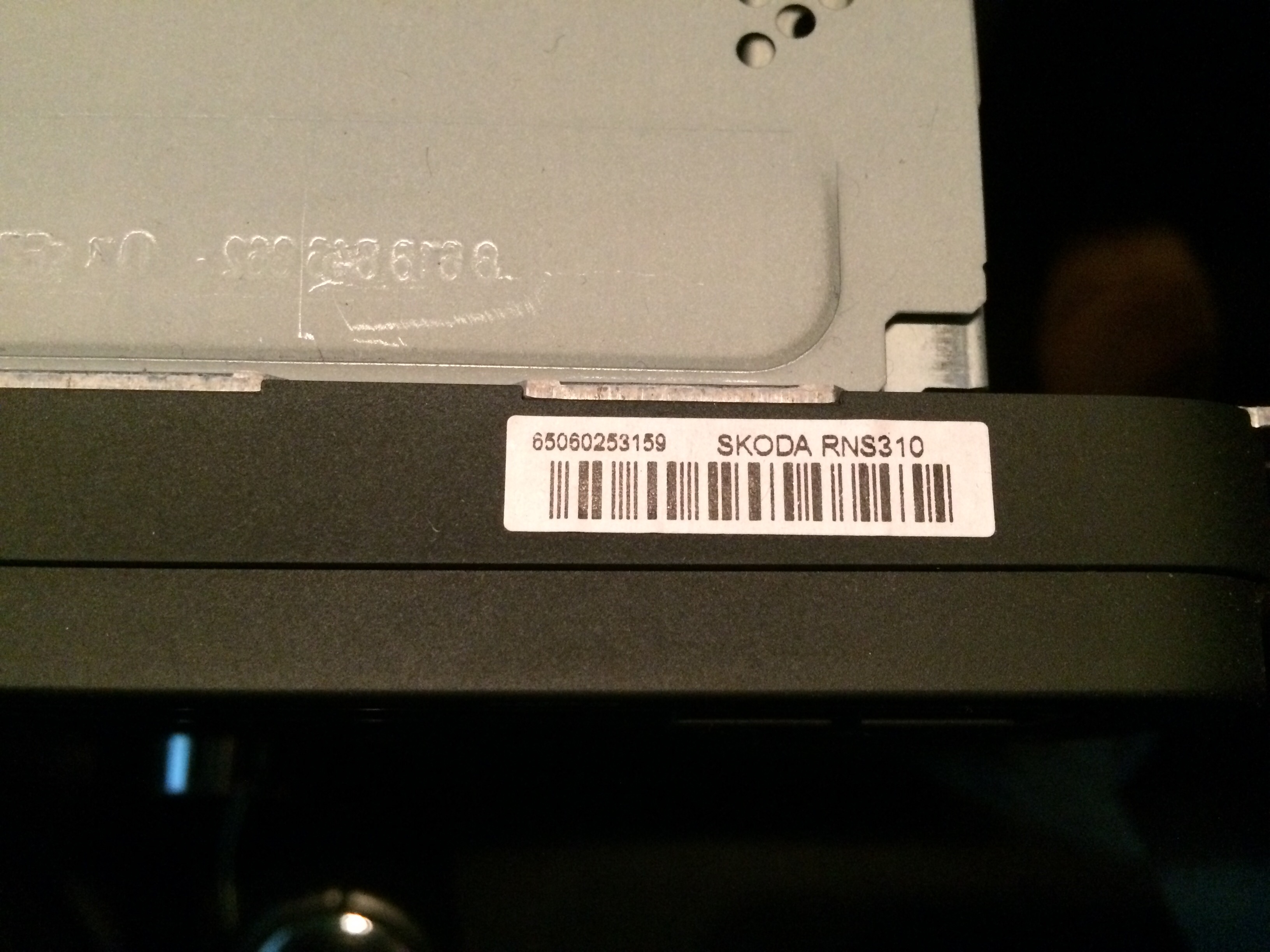

I pulled out the head unit last night - couldnt find a MAC Address at all... So I'm slightly stumped. I've attached pics of stickers etc.

That part number is an RNS310 which doesnt have BT. I am also not entirely sure RNS310 work with separate BT modules either. I thought the Amundsen was an RNS315 so my info earlier was based on that sorry.
I suggest you research whether other RNS310 users have ever successfully fitted a BT module.
