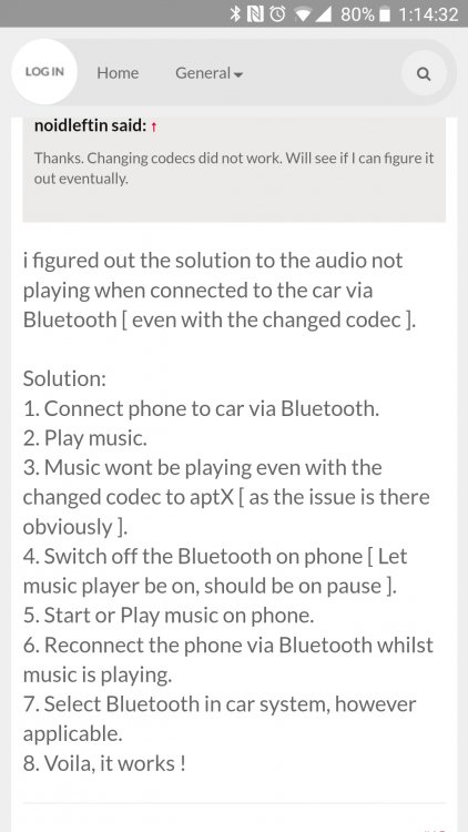

I found the following on the OnePlus forum, so on my OnePlus 5 I went in to Wi-Fi preferences and turned off Scanning always available, then on the same screen I went in to Advanced and turned off Network notification, I then turned off Wi-Fi.
I then connected via Bluetooth to the Superb and tried to stream audio, after a few stutters I managed to maintain audio for a good few minutes when usually it has been only seconds, it continued playing until I disconnected. I'm out in the car early tomorrow morning so will test it out over a period of an hour and see how it goes. I'll report back here with the results.
You may also want to give it a go.
If this works, and pending a permanent solution, I'd prefer this to keeping a cable attached.

Well I gave it a go, it was hit and miss, more miss than hit although I did manage to stream audio for 40 minutes at one point then it lost it again. I've opted to use the cable for now and live in hope it will be resolved soon.
Just tried this out, seems to work OK, only tried it for a few minutes but it didn't cut out at all.
