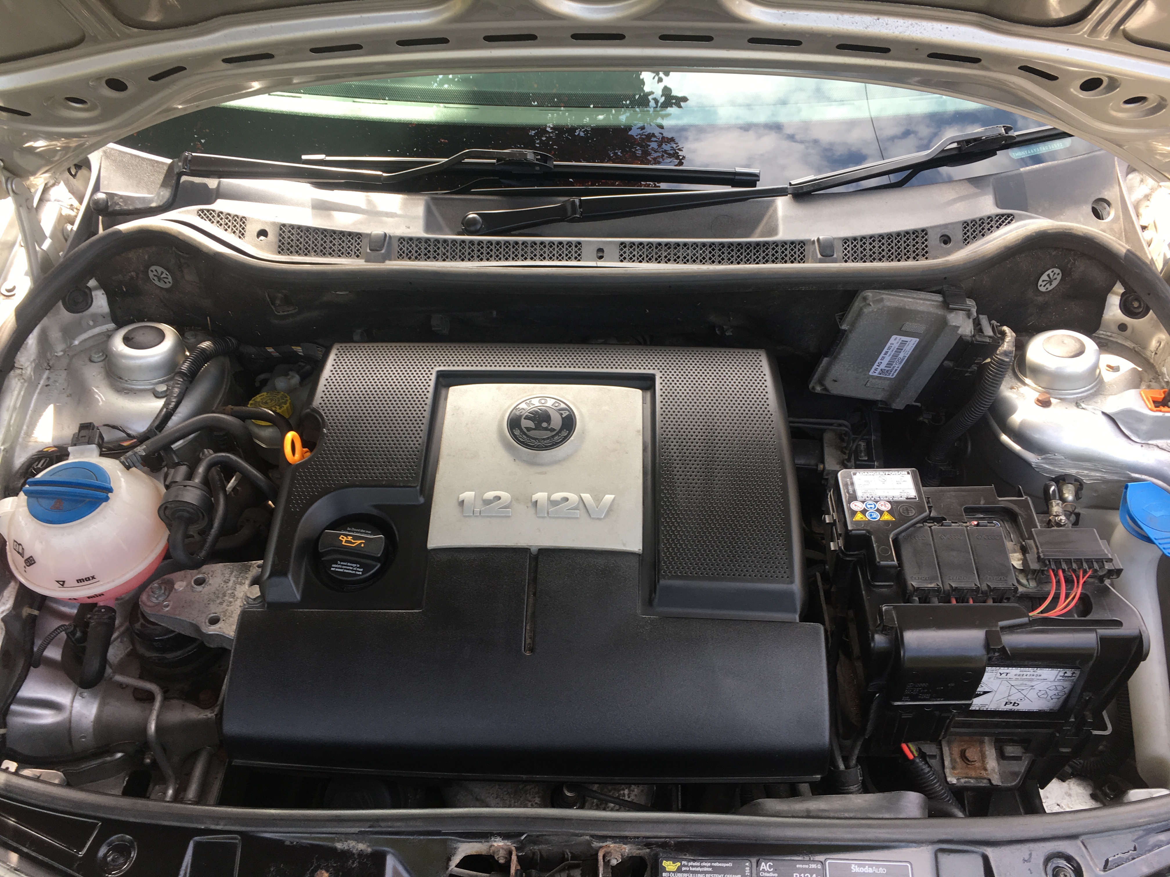

Well, I've just been out and done them and must admit it was a lot easier than expected.  Doing both took a little less than 5 minutes I reckon.  And there seemed to be plenty of space on the passenger side without having to remove anything.  Perhaps my battery is situated differently???

If youve got a petrol fabia its likely the battery is mounted further back hence the extra space available.
Mine's petrol but the battery is mounted right up to the headlight. Must be some variation in them.
My old 1.2 had it set back, no airbox though
Ah, Interesting :)
