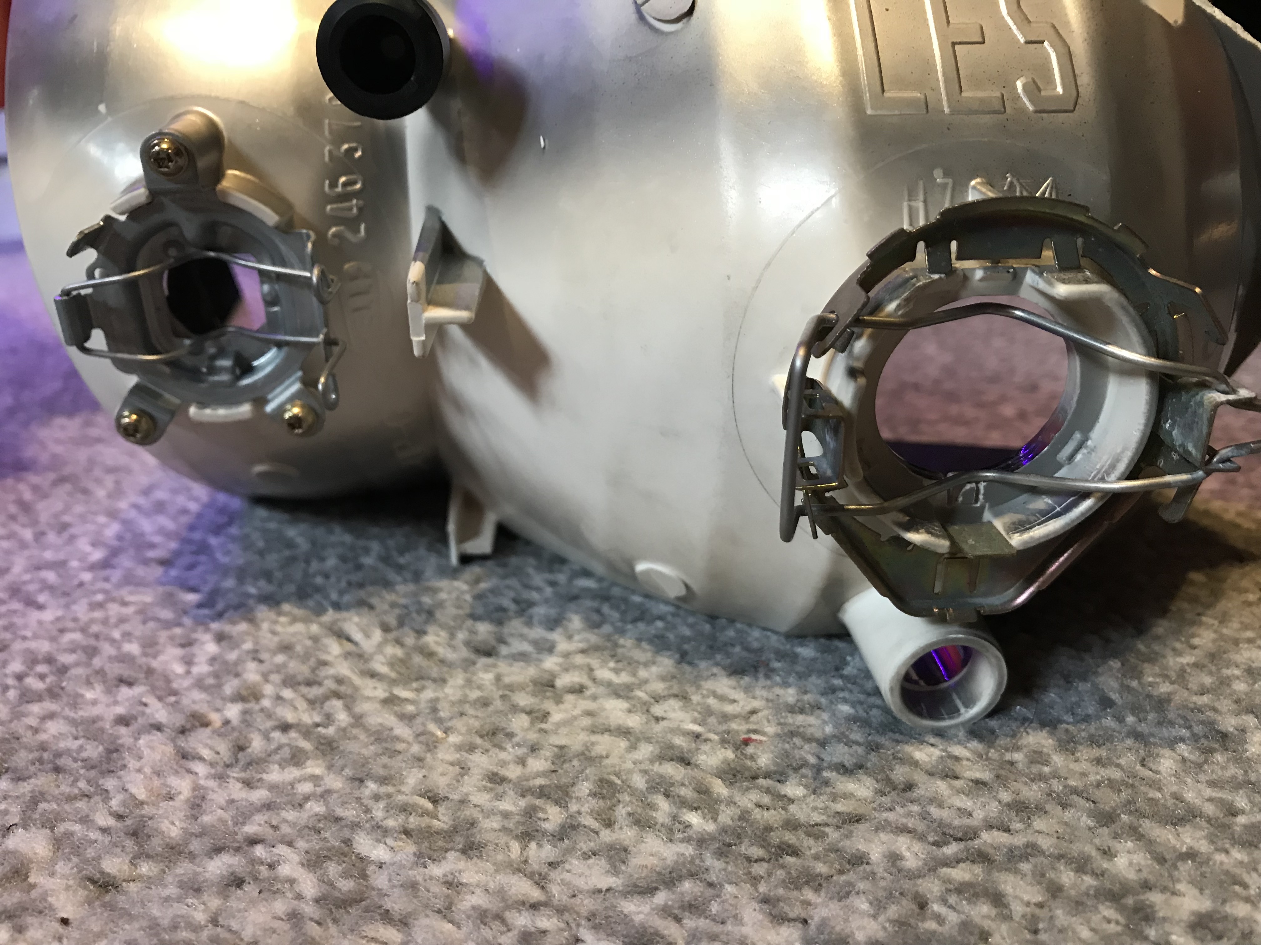

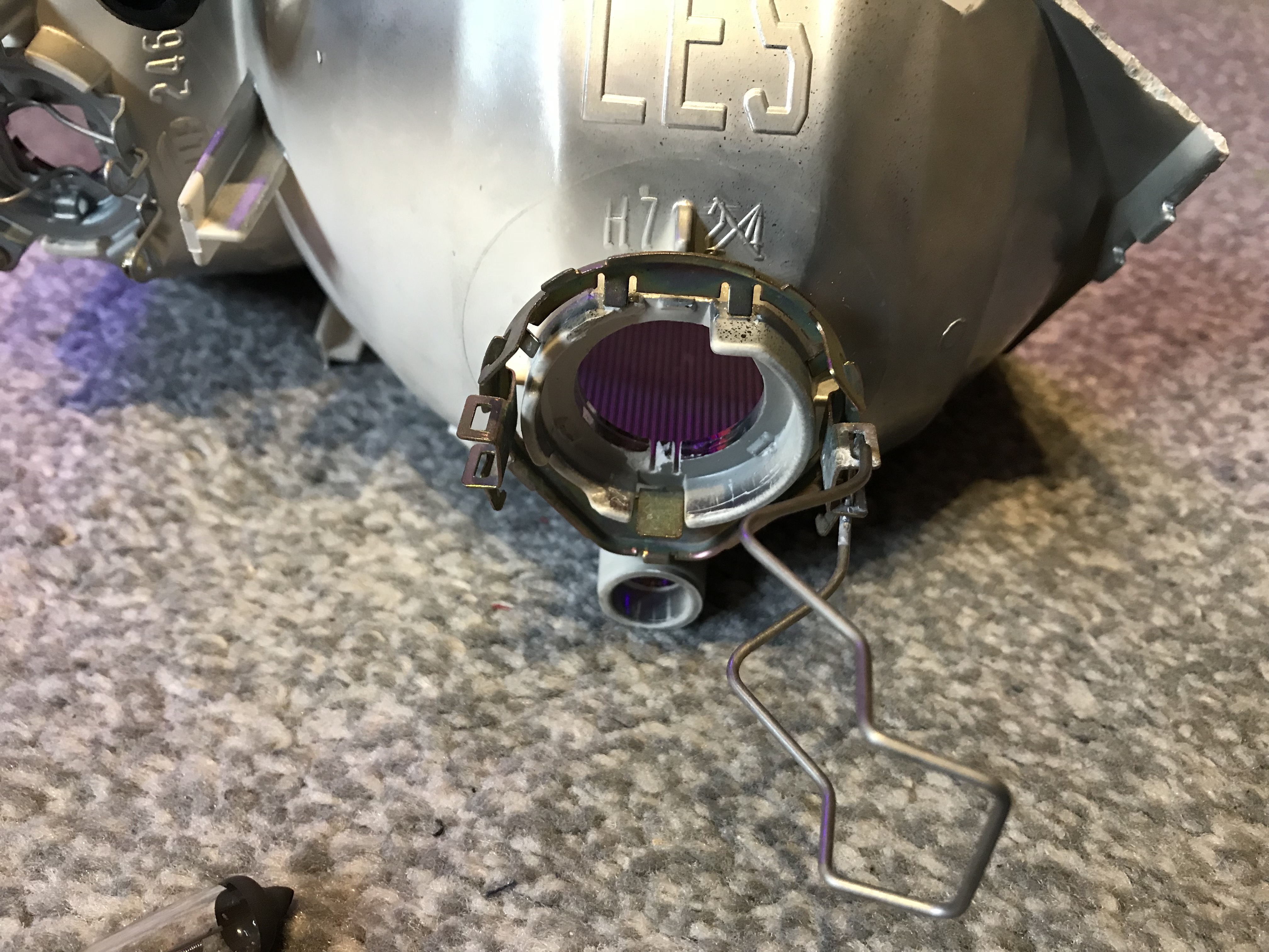

Just be careful not to push so hard you dislodge the headlight reflector from the mounting. Depends on the condition of the rubber mounts inside but i've done it before all to easily when trying to clip the metal bulb holder back over. It's not the end of the world if you do, can be reattached easily but best to avoid as headlamp aim will probably go out. Also make sure the bulb is seated correct orientation as otherwise you wont have a very effective headlight.
Ive attached a photo of what the drivers side light looks like, the one you want is the bigger fitting to the right of the two (looking from the rear)
Also note which direction the metal retainer unhooks from
Edited by JWvrs25

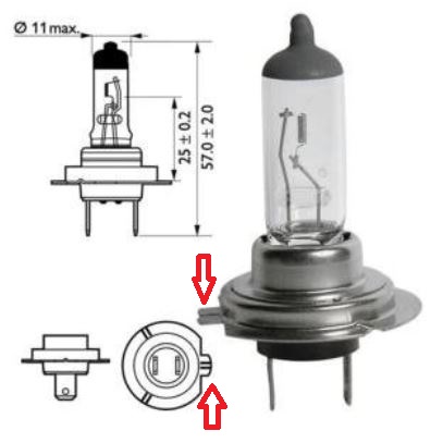

How do I ensure it is the correct orientation?  Or will that be obvious?

The tab sticking out the side gives you the orientation. It probably won't fit unless that is in the right orientation, but just look at where the tab is as you pull the dead bulb out and put the new one in the same way round.
