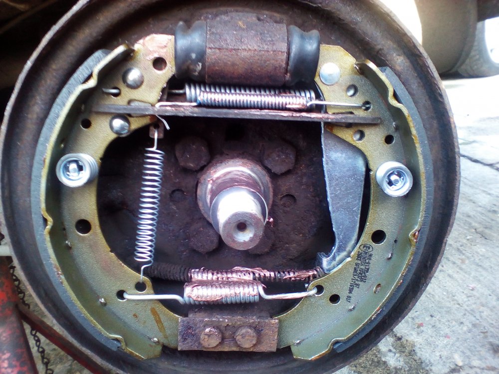

Front brakes all replaced new pads and discs... Straight forward enough.

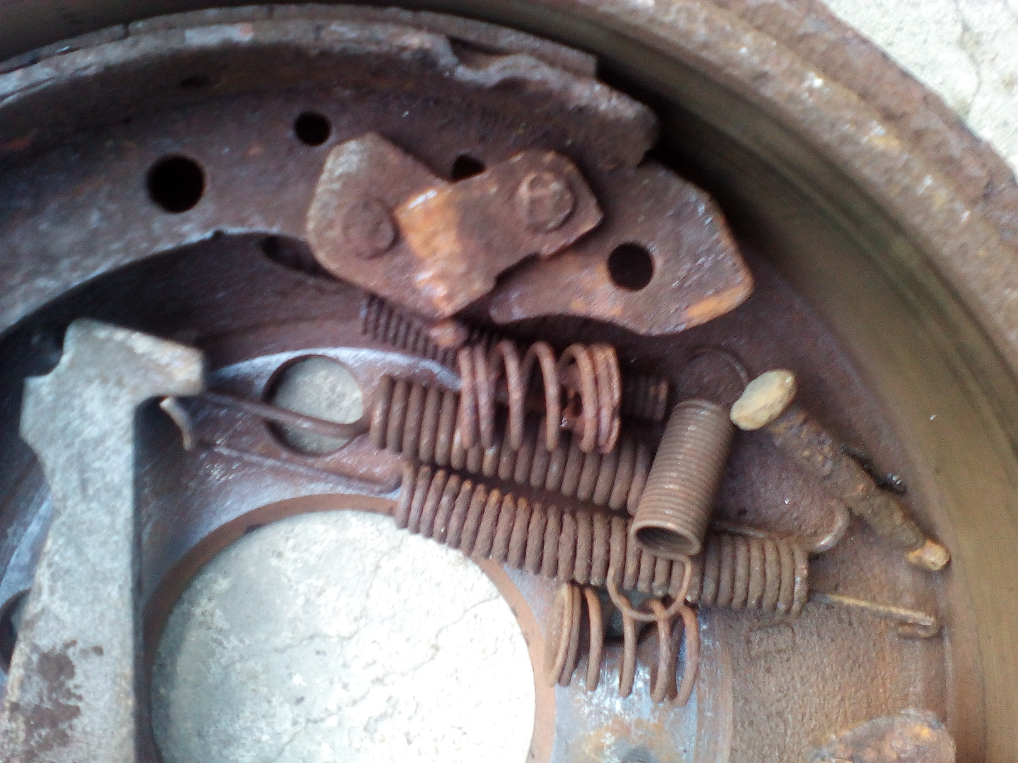

The rear was a different story.
As the pictures show how bad the old lot were and these according to service history were changed 2 yr ago
I beg to differ

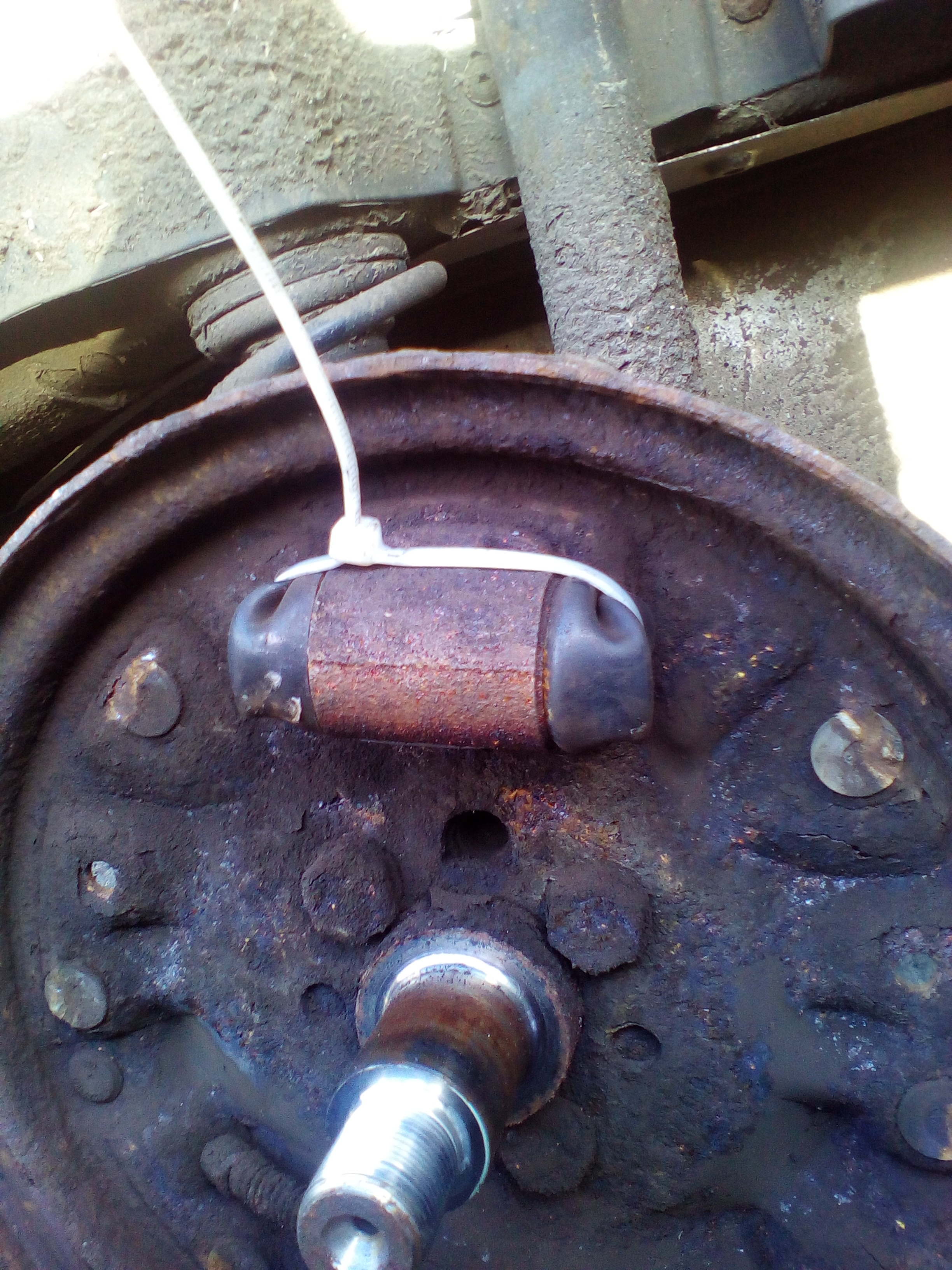

Here's something I've done for years them cable ties do come in useful

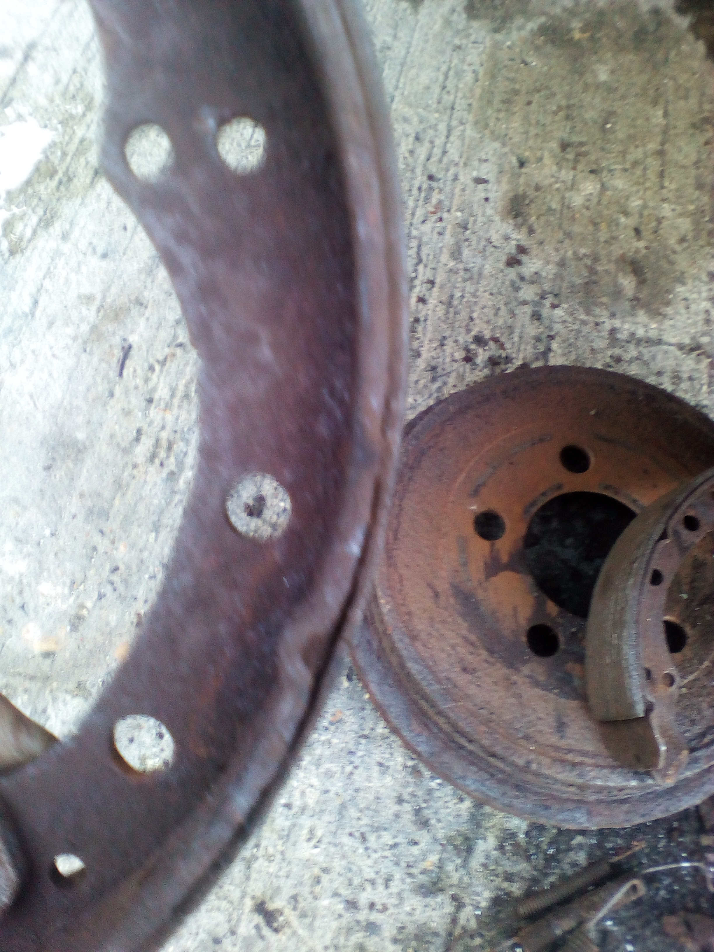

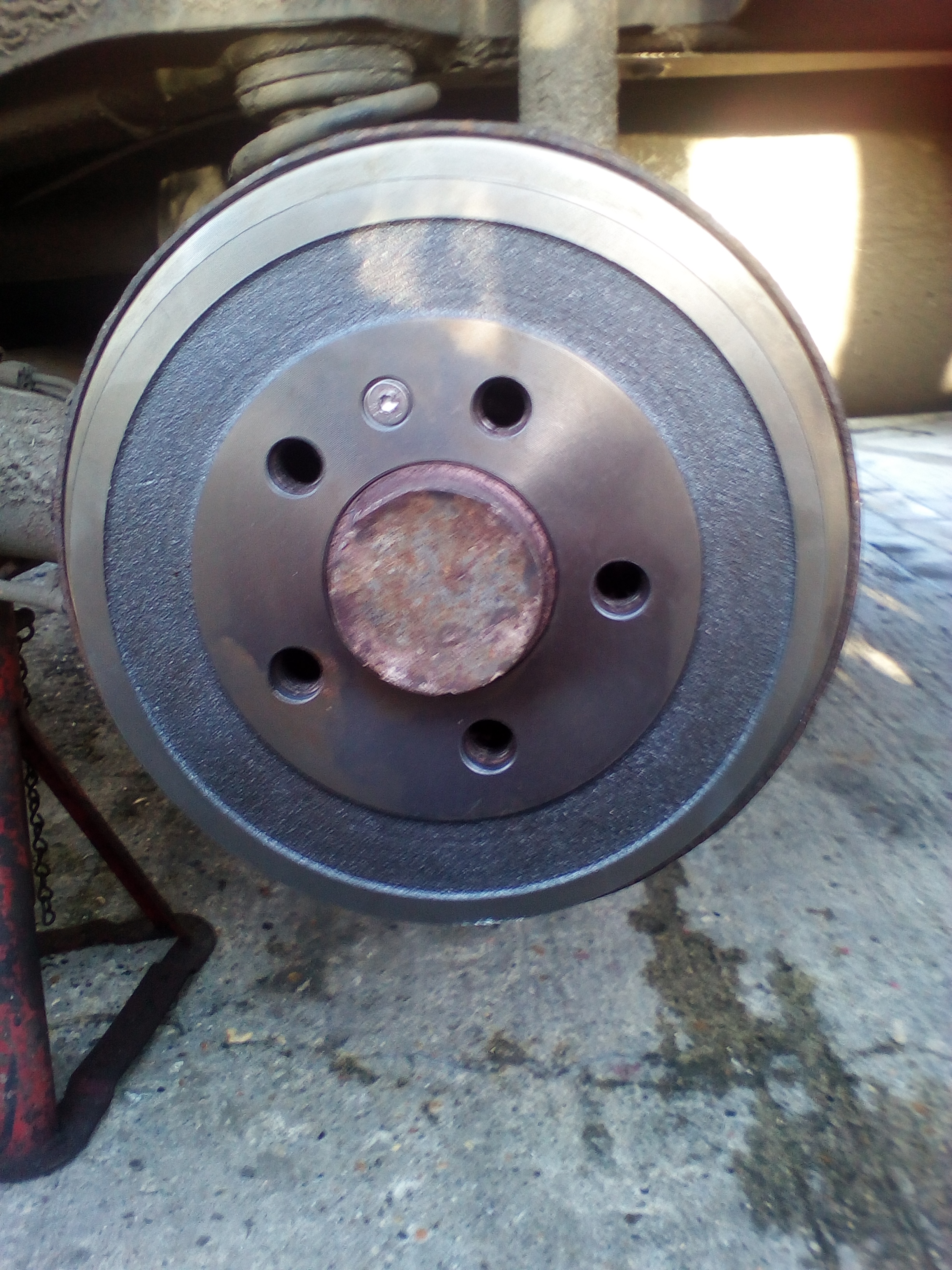

Nice new drum aswell

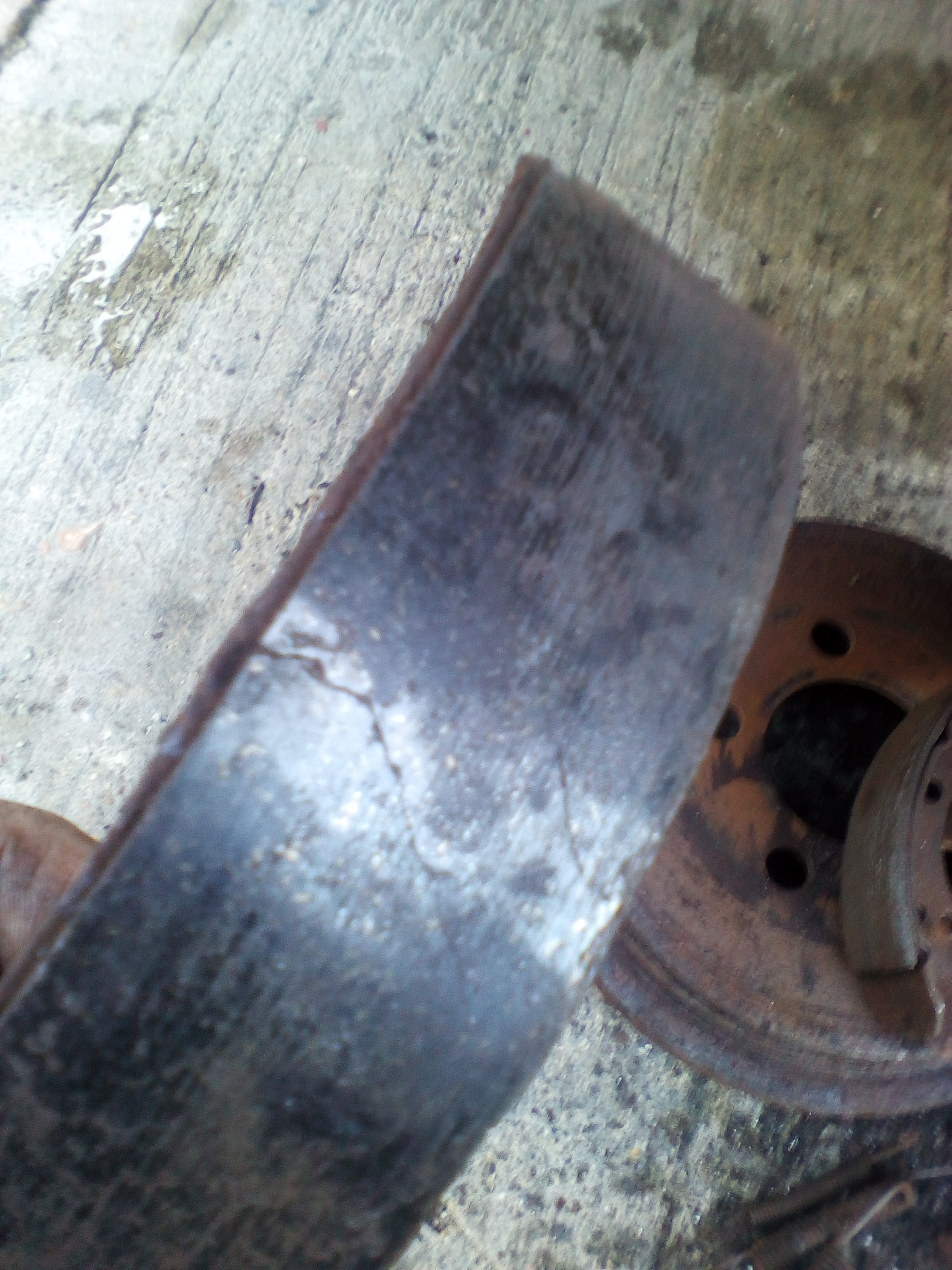

Shocking brake shoes ....

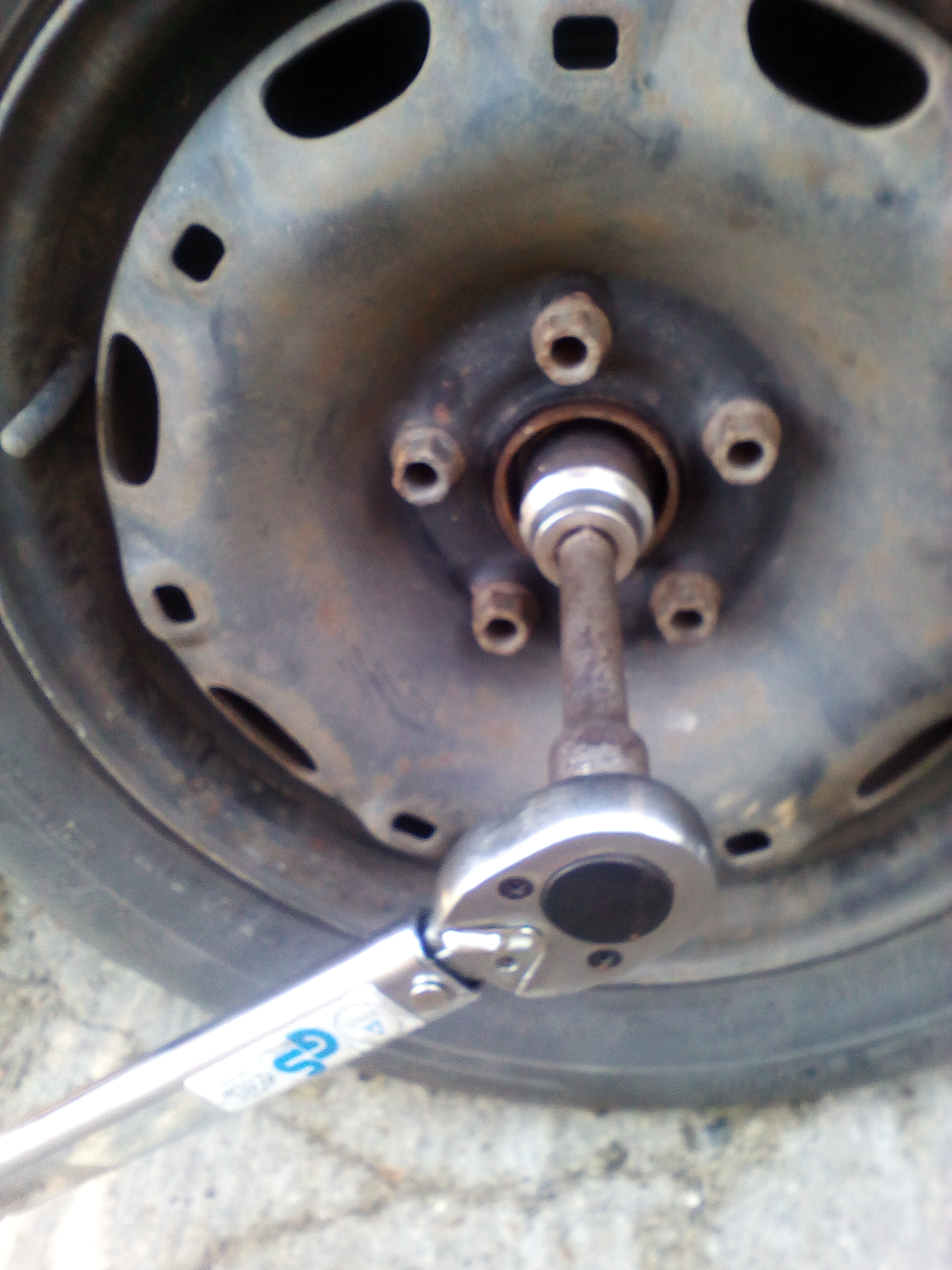

So much easier removing the hub
stevie wonder service ?  previously--I hasten to add
I beg to differ
Look nice and new ....

for next time don't put copper grease on the hub spindle...use a yellow/clear bearing grease....as will cope with higher rpm than the copper grease which is not a lubricant per se....just a anti seize compound...it surfaces are not moving but static to each other...
I wiped that off after the photo was taken and did apply the grease as you suggested, just can't believe the service history that came with this car claiming rear was all done 2 yr ago I feel a name and shame coming on ..
At least i know all brakes front and back are new done by myself and saving a few quid.
Good man...I have numerous greases which cover all situations on a car...
Whoever did those rears even two years ago ..all the retaining springs have fallen out ..did they not lock them in with the turn cap/plates??...
I only paid £400 last September the history to it was amazing till you start to investigate and find the real truth , the poor old chap who owned it before was such a nice chap he  gave me a tenner back for diesel home and to think how these garages can do this to people is shocking to say the least

Have to admit I was proud of my rear brakes when I re newed them. All shiny with new drums. Did the front as well stops way better now. Problem is I've got alloys so the drums are a little rusted and show through brown. Going to de rust and paint this week end if the weather is ok.
There are six plastic 'glide pads' on each side which simply push into the backplate. The brake shoes slide on them. Yours look a bit knackered. Part number 6N0609589
All done and new ones fitted i  didn't manage another photo was getting to cold and just wanted to get the drum & wheel back on ,car down then in for a hot cuppa tea !

Exactly 2 years ago replaced rear brakes on my Furby- TRW drums and pads (full kit with cylinders, springs, wedges, pull-back plates). + New brake cables.
Now handbrake starts to stick on one side (but am using it often).
99% that damn pin (pad<>cable's lever) is rusted again- despite, I sprayed it with ceramic grease before mounting.
So, in next days will try to drop a photo of mine "2 years old brakes" :-/
Question remains open- "to grease on not to grease" :-) that pin.
And if "to grease"- than with what?...
You mean the handbrake arm pivot?....
I just put a drop of oil on mine when I fitted my shoes.
