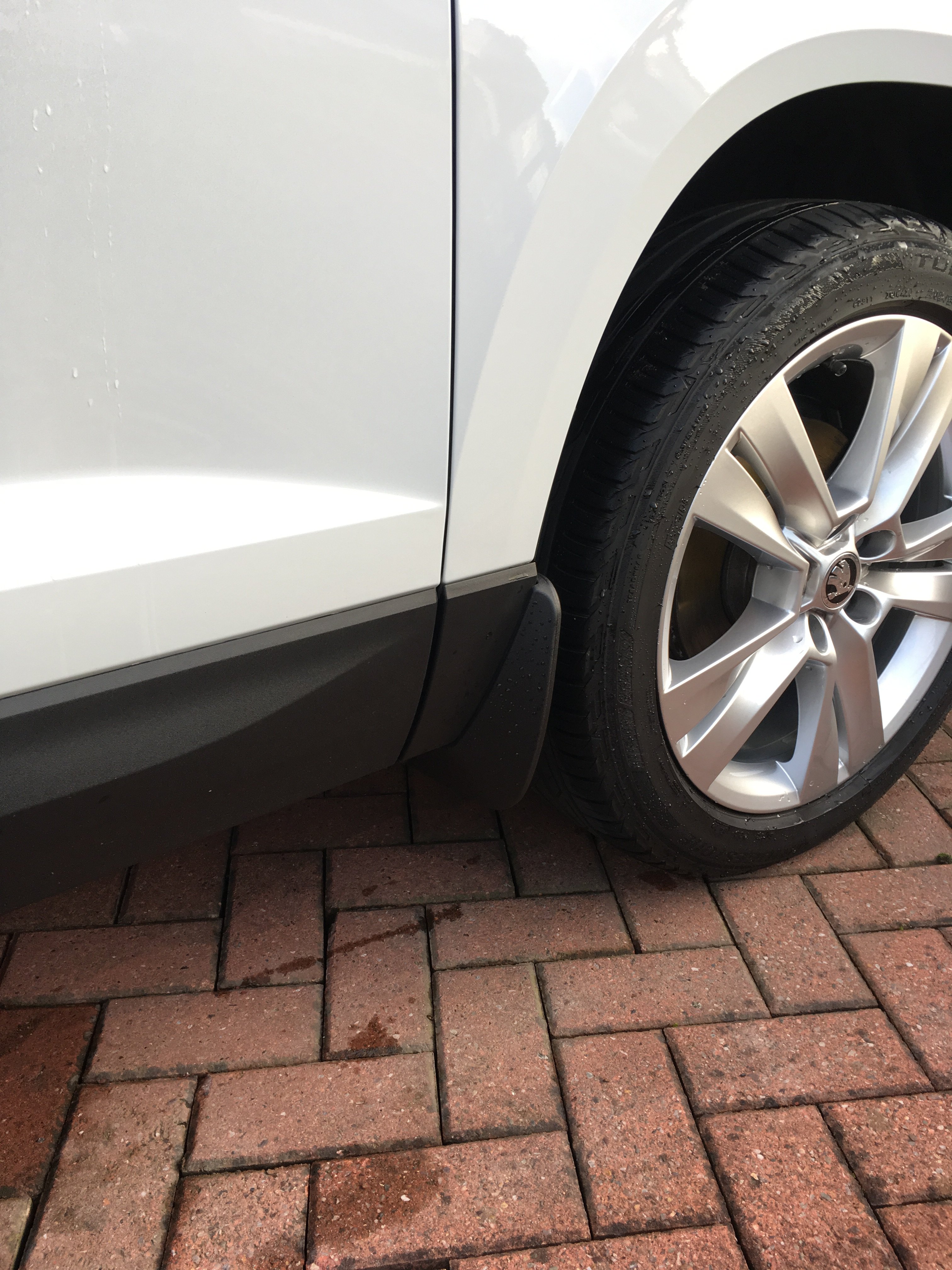

I did it !! Didnt need to take the wheels off - 18 inch. They do make a difference to both looks and splatter. Took me about 3 hours.20180527_163850.thumb.jpg.0ed82a1693cc4d0b8cd19231e3030c5b.jpg

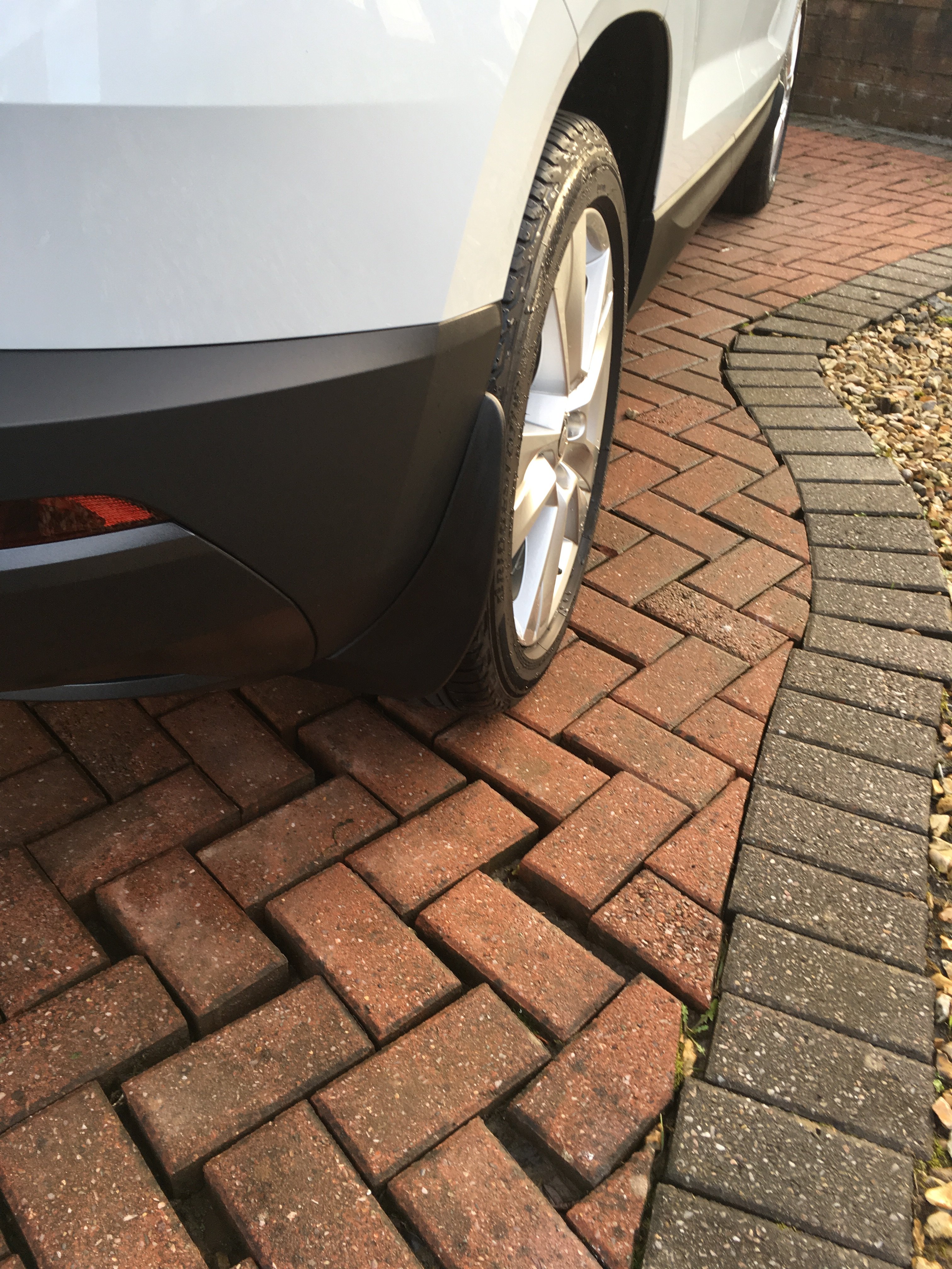

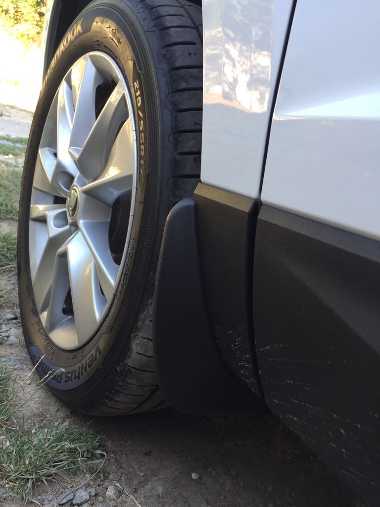

As promised,pics of my Moon White Karoq with shiny new mudflaps.
