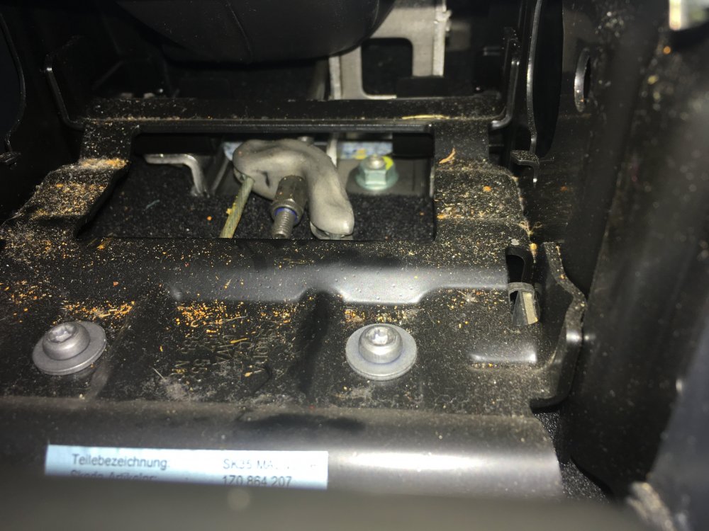

My 2005 1.9 Octy hatch has a handbrake that's not up to scratch. As per a thread on here was planning to adjust under the jumbo box.  However that may not be possible due to the handbrake cable equaliser plate looking a little mishaped.
I can't see how I would get a spanner in there anyway.
So my car pictured first, then a stock image from Haynes. Something definitely not right to me. Even if the plate was straightened surely it's strength would be compromised afterwards ?
Advice welcomed.
i've seen a few posts with the equaliser plate that looks like yours.  I'm not clear if they are all faulty.  It looks wrong and damaged. Could the caliper / handbrake connection for that side be seized?  That is what I'd be looking for first.   May need two people to help check.  I have a feeling the cables cross so RHS maybe rear wheel LHS..
A 10mm spanner or a 10mm socket on a universal joint and extension bar should reach...

Yeah was told the nsr brakes are binding last service and after popping to garage the equaliser plate is level now. Does not look like Rr handbrake is seized underneath. So looking at new rear caliper.

Well this could explain why the handbrake equaliser was skewed one minute then straight the next. But then again if my pads are now unequally work that's surely a bad caliper.
Given the rears calipers are wind back I don't understand other than the moving in and out when brakes applied how they stick.
