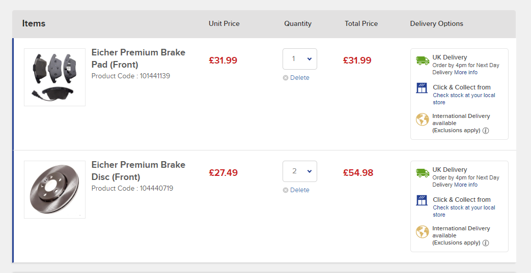

Do you rekon i'd see any improvement if I went for the below?
I would say no improvement.   If you want better braking try fitting Braided Brake Hoses.

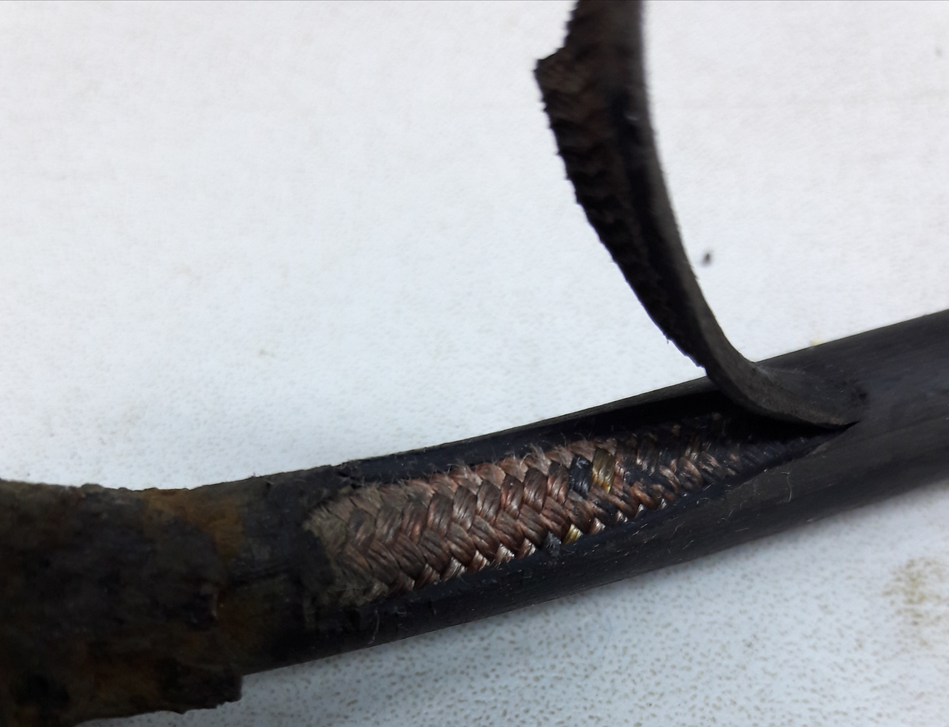

All brake hoses are braided, aren't they? This (original) one came off our humble HTP a couple of weeks ago. Outer protective rubber, then a braided layer.
OK it's not metal braid, but at the same time it's not just rubber.
Sorry i should have said good quality braided hoses and not the  Sh1te Skoda fit, and get decent brake fluid as well.

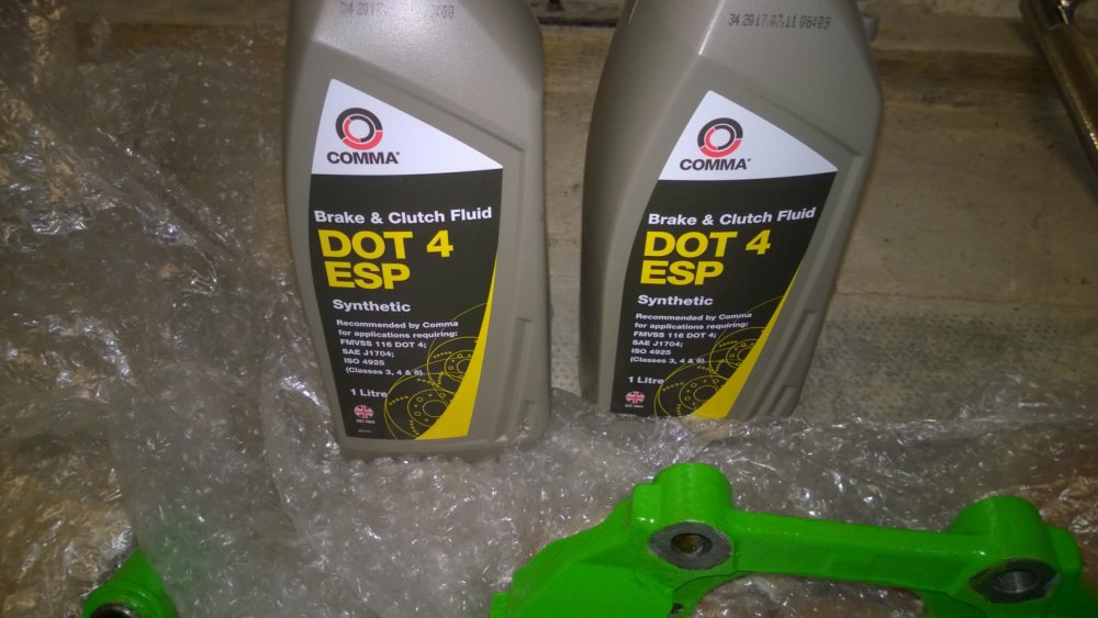

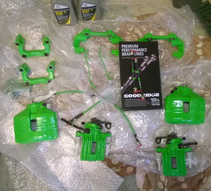

1. Good Discs & Pads
2. Brake Fluid
3. Braided Hoses.
4. Clean & Strip down of Housings
(1& 2 is far more important than 3 & 4 but i was repainting a second set.
 EBC'c & redstuff pads (may be overkill), Goodridge hoses (front mids) improvement over stock
Edited by Kobayashi

3 hours ago, Chibakun said:
So with those discs , pads and new fluid you've linked, do you also need new calipers?
new ATE / Lucas ' Caliper housings' not necessary simply a cosmetic mod, though i did get them re gasket the green painted ones,
you shouldnt need to do this at all on originals, mine came from 2 x ebay scrappers VRS MK2
(obviously the original red VRS MK2 ones i needed attached to the car! for it to function while i painted the others)
So i now have a spare red Front Set and 1 red rear set off my VRS MK2 if anyone fancies painting them as a project! All sorts of OEM parts lurking in the garage...
Its probably the best upgrade on the car to be honest having really good discs & pads / hoses / new fluid.
Though i doubt i would tell much difference if the EBC discs were swapped to Brembo for every day use...

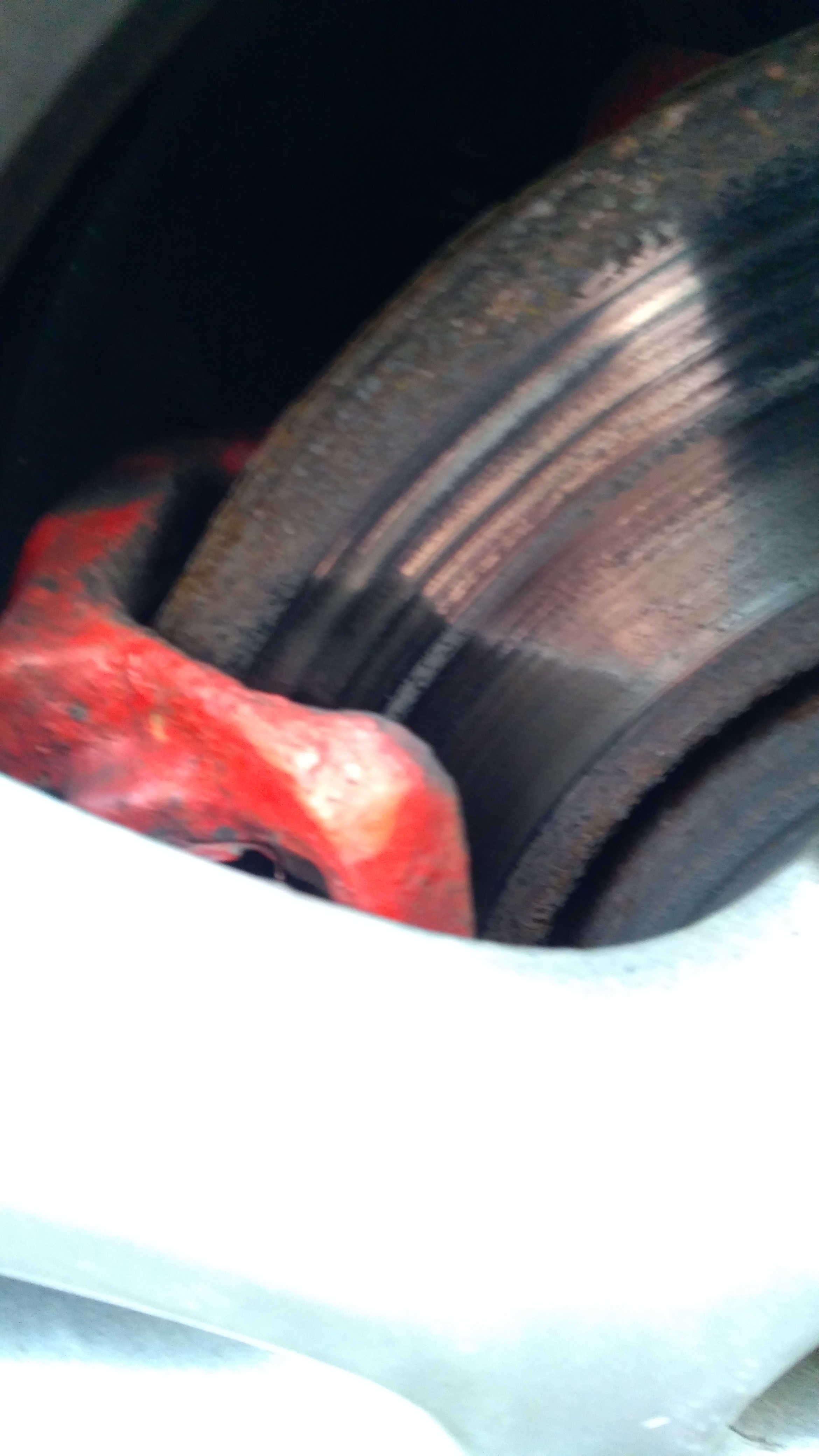

Hi,
I just bought a 08 Fabia 1.9 tdi and it looks that the pads on the front only cover part of the discs, as if disc was 288 mm and a pad was made to fit the disc of a smaller diameter.
Both Discs don't look good and aren't great on this car comparing to VW Touran, so I am going to replace them along with the fluid.
My question is - would calipers be the same for a smaller or wider pads,in other words - whoever put  the smaller pads made a mistake by ordering wrong parts, or the wider pads just wouldn't fit and they had to go with the narrow ones?
Thank you

You are probably right , it just looks that something is wrong there:
  • Sponsor
Nasty. I bet the inside surfaces are even worse.
