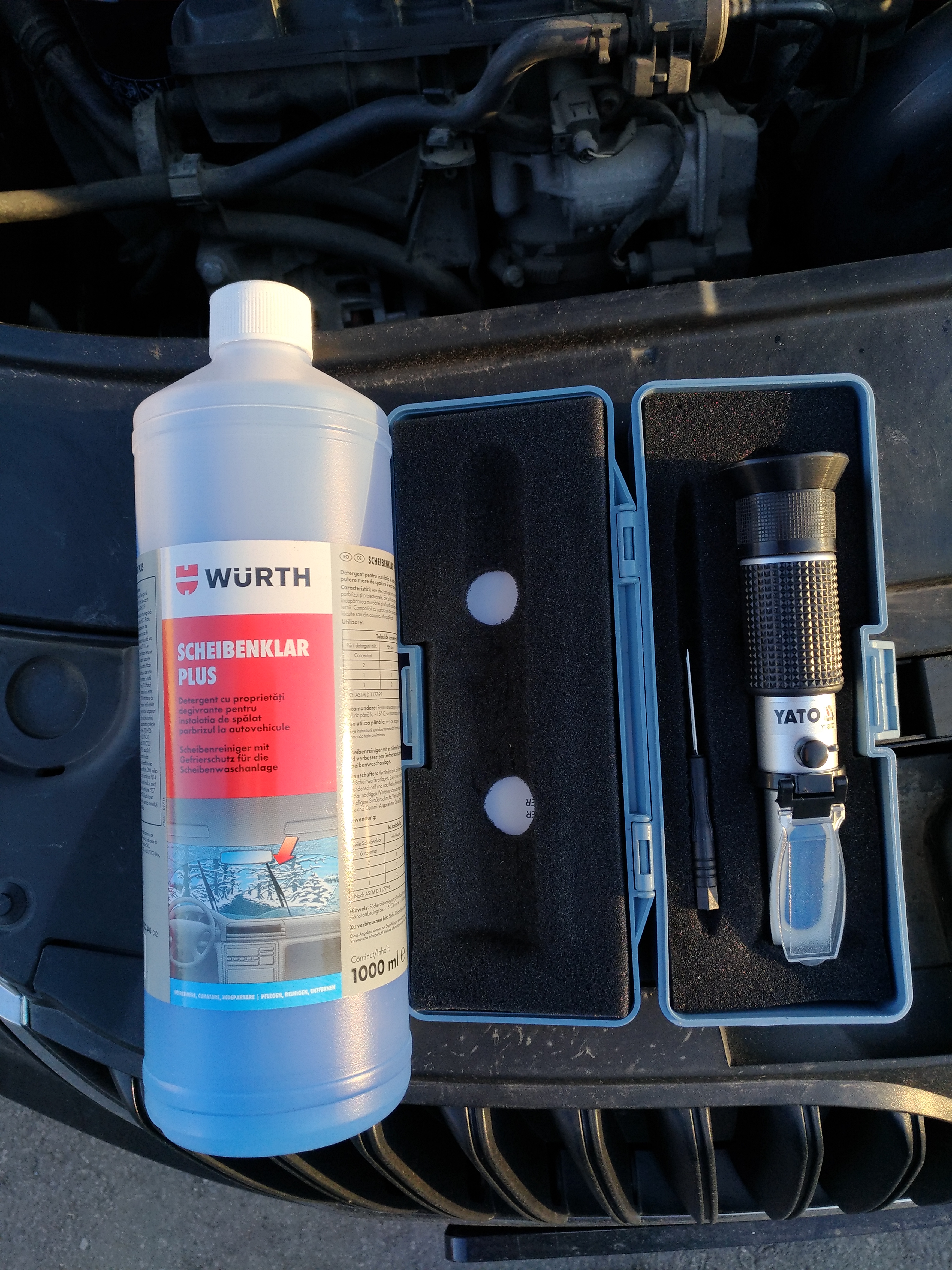

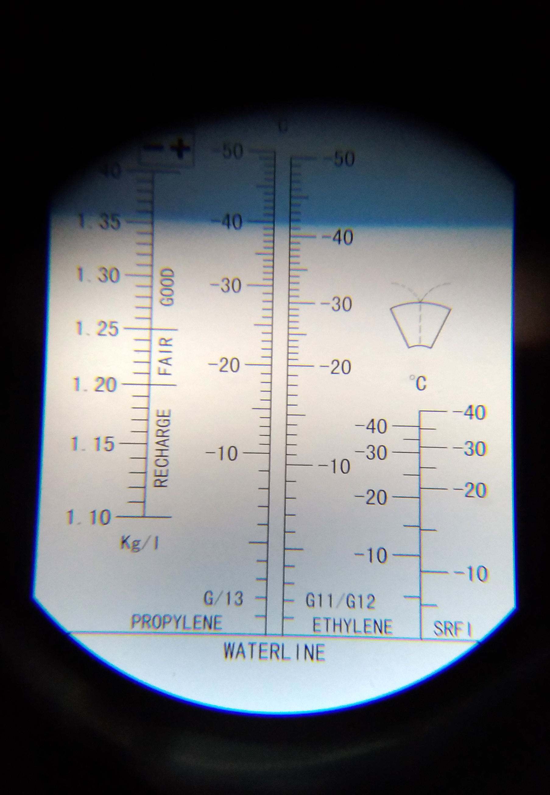

Nothing to be concerned about if the amount that you need the correct level is not above 1/2 liter per year of coolant or distilled water (depending on the minimum freezing point). My CDAA TSi engine started to warn me about low levels after 5 y and more than 100K km. When water pump was inspected there were no noticeable leaks so the recommendation was just to monitor and to correct the level. Not more than above mentioned amount is necessary  so far to cover 15K km every year. BTW I noticed that the coolant lose is more accentuated in cold season and I have not certain explanation for this.
Before topping up the the max level I check the coolant freezing point with a YATO refractometer IOT to balance optimal concentration.
