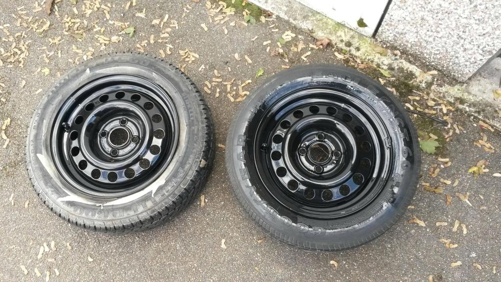

This stuff pretty good......Used it on my Mk2 Golf steelies a while back (see picture)
https://www.zoro.co.uk/shop/lubricants-and-chemicals/paints-and-primers/direct-to-rust-smooth-black-aerosol-metal-paint---400ml/p/ZT1036506X?utm_campaign=pla-Lubricants+%26+Chemicals+-+&utm_source=google&utm_medium=shopping-pla&utm_keyword=ZT1036506X&istCompanyId=6aa6787b-063e-4414-802d-129f235df603&istItemId=wtqitwpprr&istBid=tztt&gclid=EAIaIQobChMInerCr9ub2QIVBxDTCh35WA7OEAQYAyABEgIHz_D_BwE
Just mask the brakes off etc and slips playing cards into the tyre/outer edge of the wheel. Clean the wheels down with sugar soap and then scuff them with some scotchbrite pads to help with adhesion.
https://www.pistonheads.com/gassing/topic.asp?t=1474257
That link shows how to use playing cards for masking off etc.
