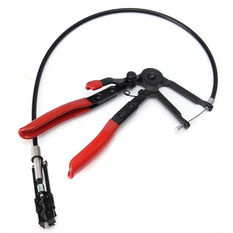

It's dead easy if you have the correct tools    £9 delivered
And once you remove air box its right there

Thanks you sir. I have seen pictures of the area on threads.  What is that tool though. Is it like a brake pipe clamp?  To prevent fluid loss ?
i take it you only need to clamp one end as that's where all the engine fluid would leak out ?
I have a brake pipe clamp which squeezes a brake pipe together is that suitable too ?

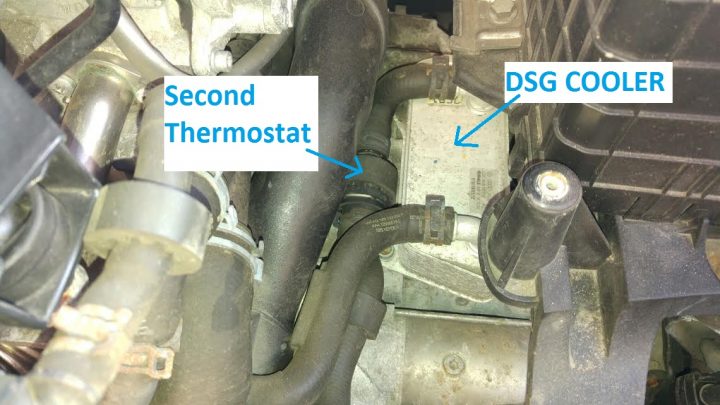

It will most likely just need reset to standard with VCDS and the tool is to remove the metal clips that hold the pipe on .
Use the tool to slide the clips back on the 2 hoses that connect to the thermostat then twist and pull to release the Therm  from the pipe.
You don't need to clamp the pipes if you do it quick enough ;). Then use tool to refit clamps in original position...Job Done

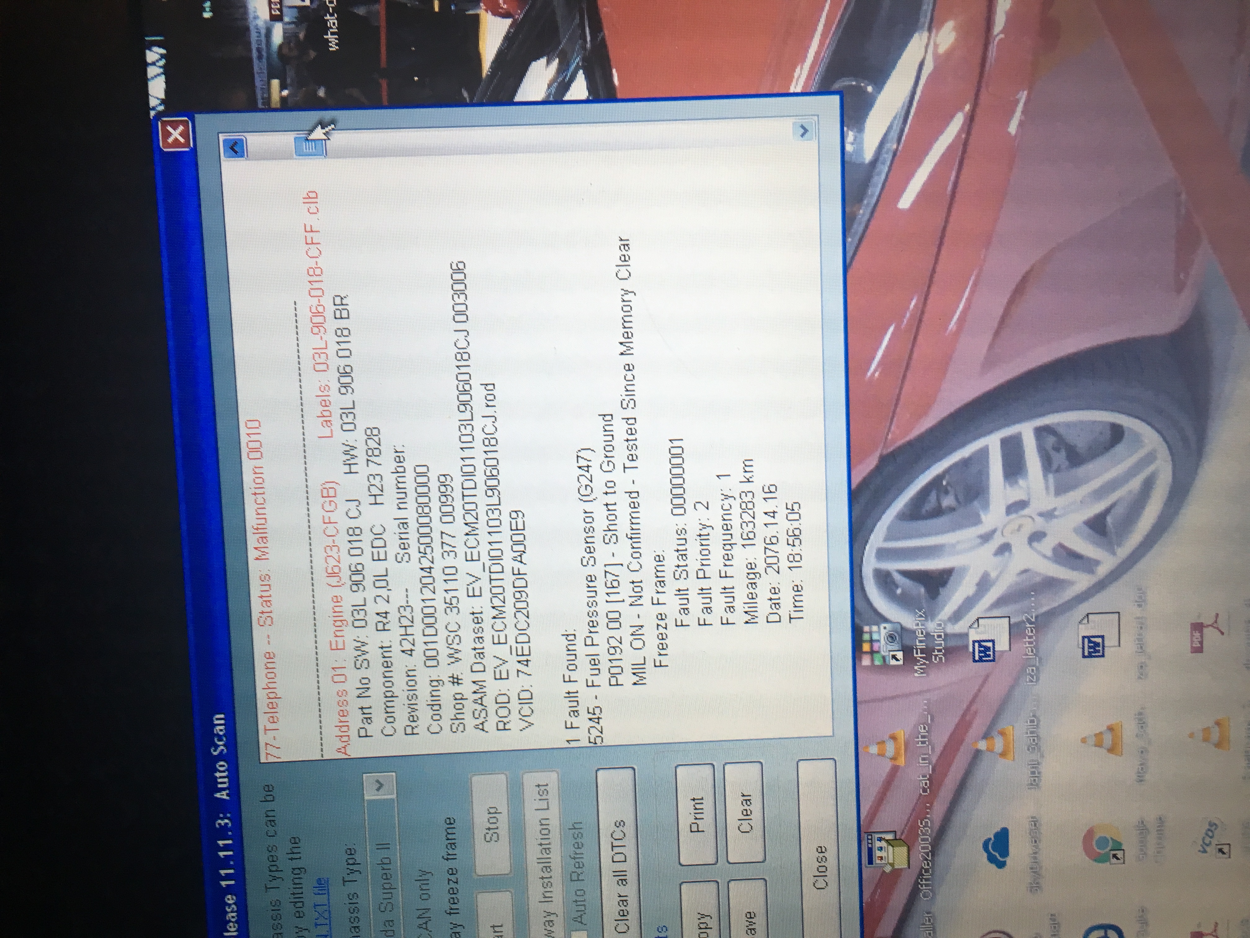

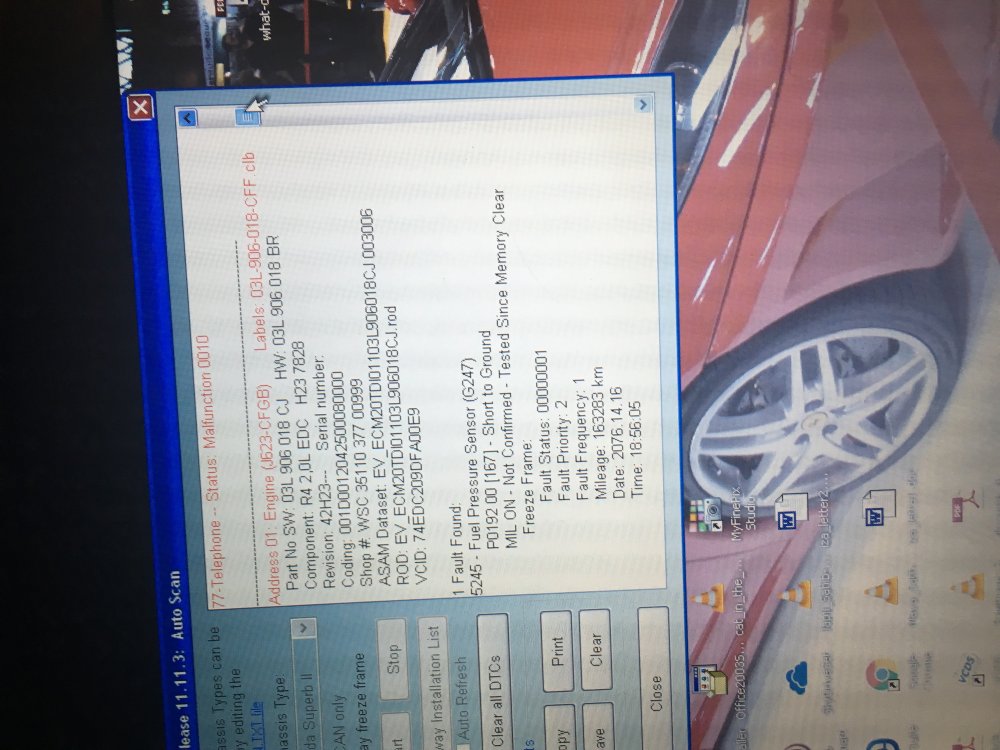

I have this on VCDS.
p0192 short to ground g247 fuel pressure sensor. So is the cutting out of power because of fuel starvation on the DSG?
Maybe, maybe not. You know the DSG thermostat is bad, so fix that first, then worry about the fuel pressure sensor.
AA are coming out hopefully tonight for this. So you reckon not related to clutch slip, almost like fuel starvation because it eventually stalled, having done it 4-5 times when I tried to force it on a hill stop start ?
I'm saying fix the thing you know is wrong with your transmission before looking for more problems.

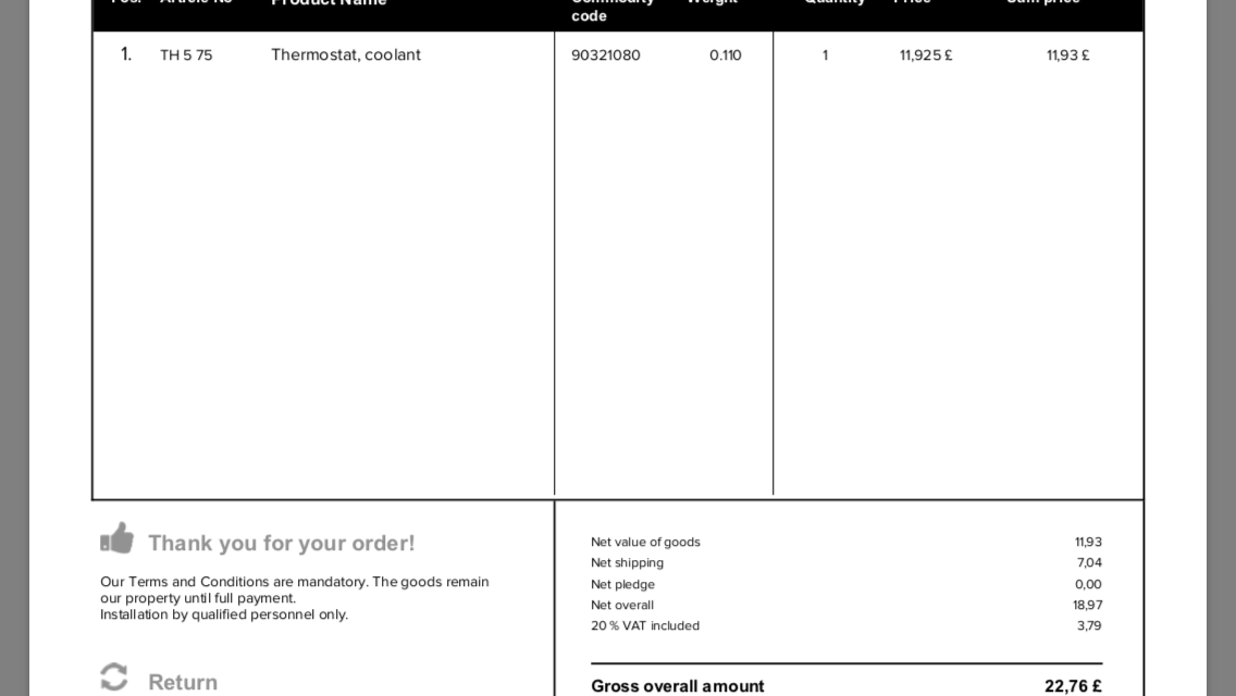

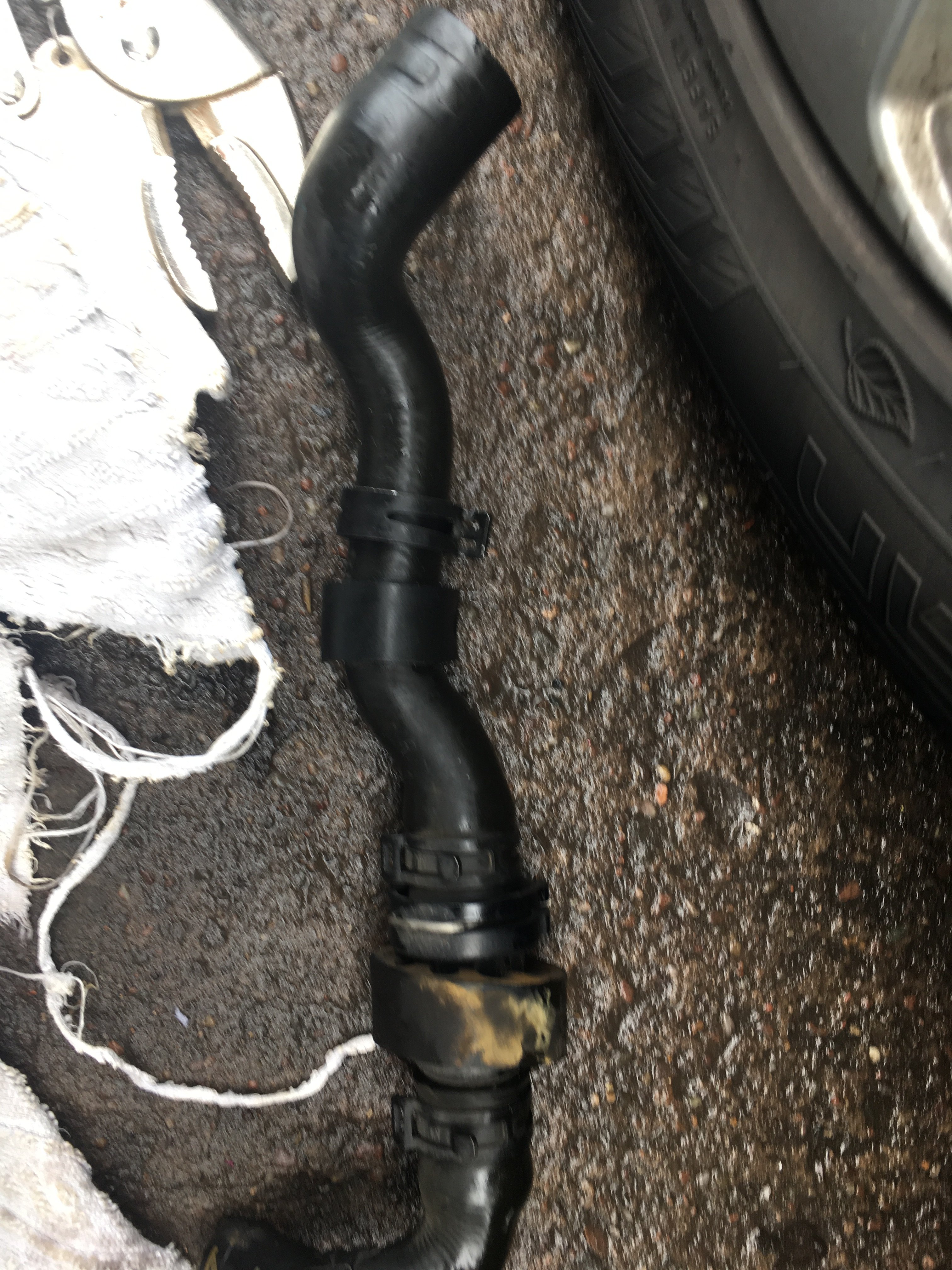

DSG Thermo replaced today with help and guidance of a garage although I did all the work myself.
Took the pipe off from the cooler clip and where it clips/joins to the T near the front of the engine. Dismantled on floor and replaced thermostat with Mahle one from Autodoc.
Let engine idle and fast idle 1500rpm until needle at 90 with cap off and also engine oil temp about 90 too. Fans never cut in. So put expansion cap on and did some local trips without issues. Will check fluid level once cooled and top up. Maybe lost half a litre of coolant tops. Not showing yet.
The part is quite cheap from memory including shipping only vs say UK prices.
As long as you can wait for delivery. Again not too long.
