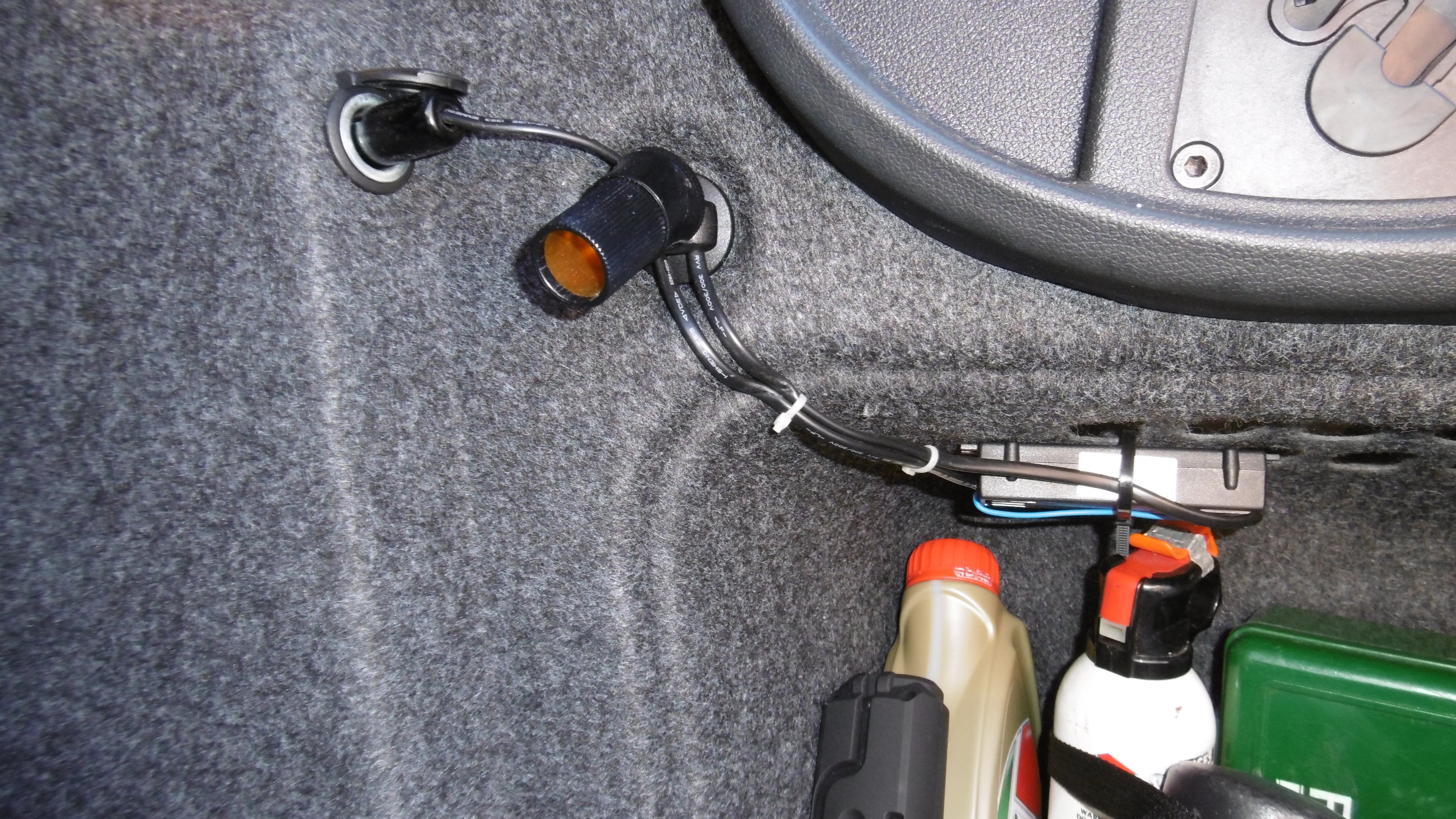

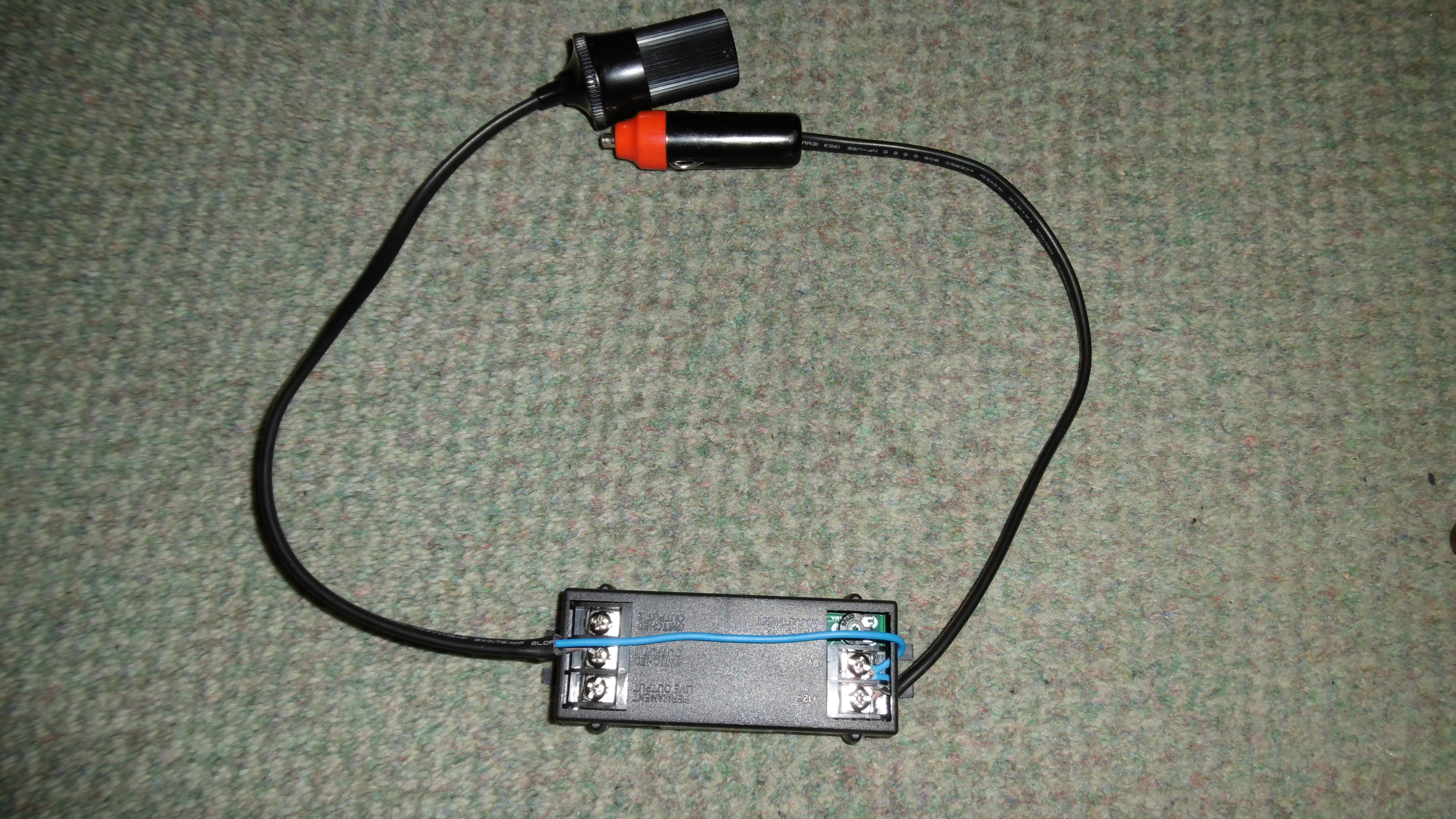

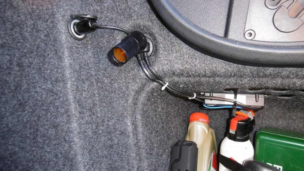

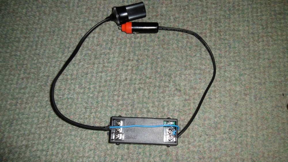

I use a PCT Volton split relay ZR1220 to feed my Coolbox in the boot. Turns off about 15 secs after the engine is turned off. cable-tied up to the top of the side compartment in my twin-door boot.
This could also be used to feed a rear mounted camera ,  infact looking at it tonight it's easy to find a cable route to the front as well
