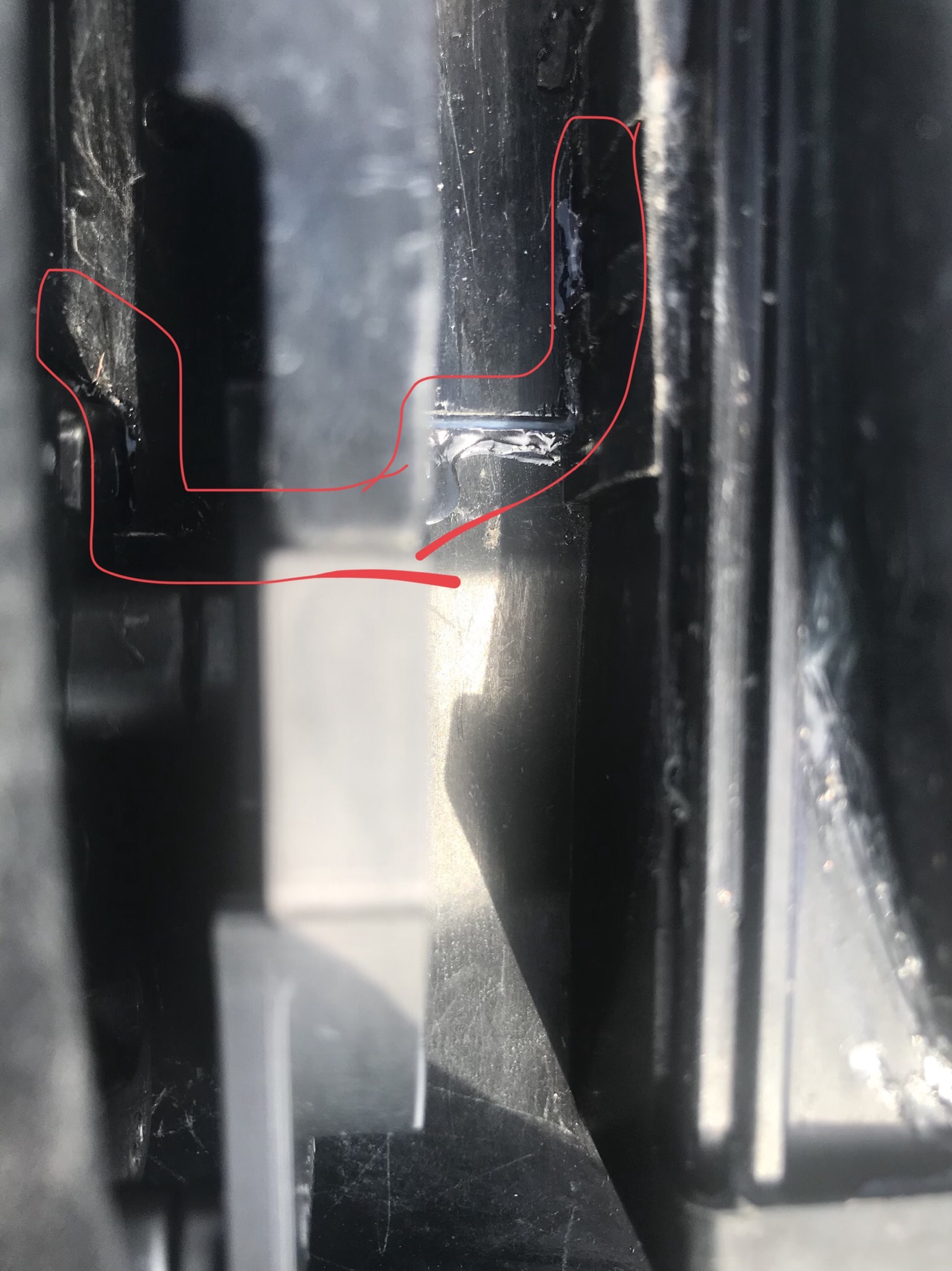

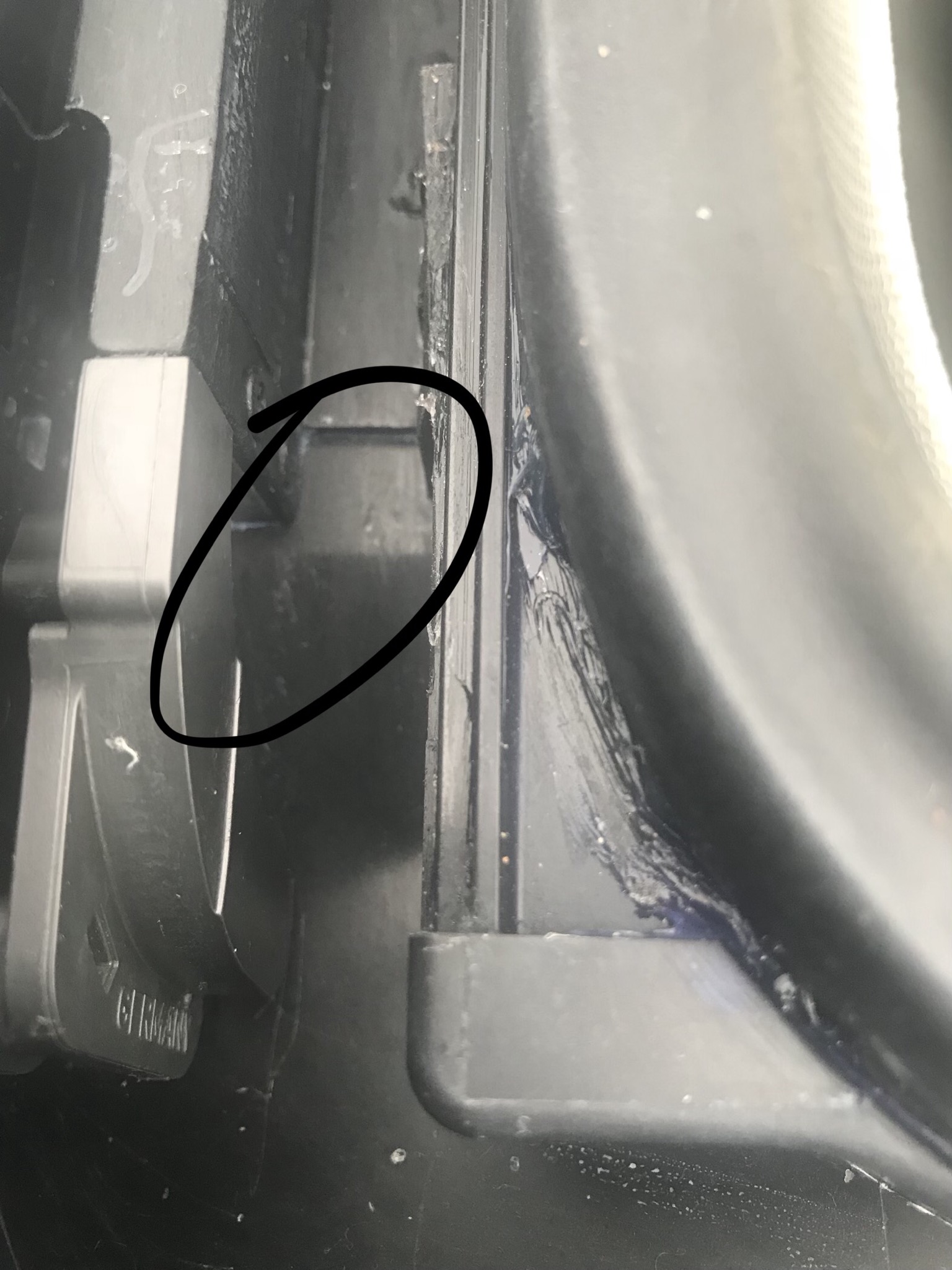

I’ve noticed that with a bit of pressure the whole plastic downward stretch moves, compromising both channels’ connection/seal.
United - when you retested before reinstallation did you make sure your waterline went over and back up the channels? In my pool test this morning as soon as the waterline hit where the seal is it started gushing. I probably should have tried a pour test first to see if any got sucked back into the seal...

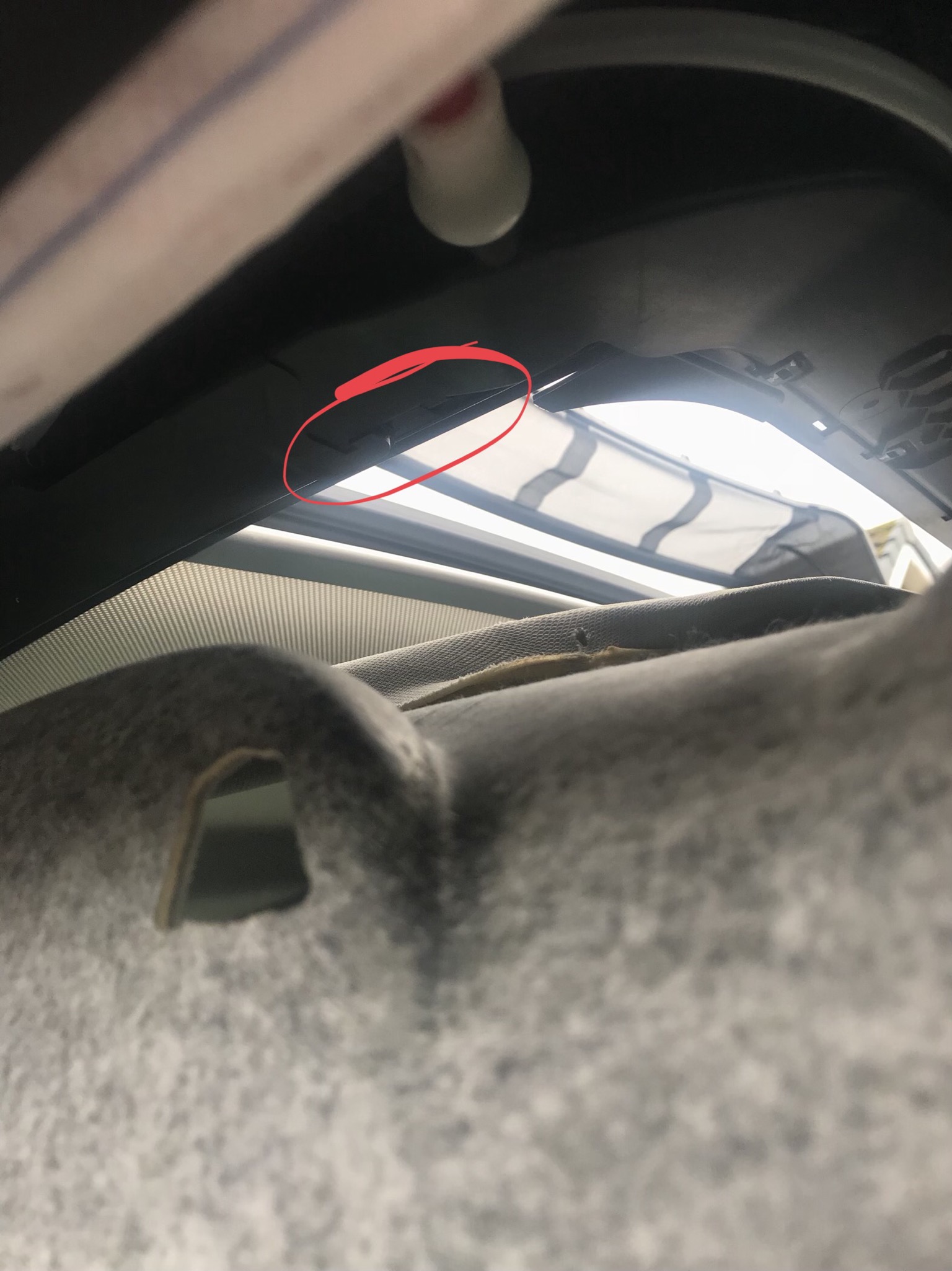

I’ve circled on the inner channel - if pressure is applied the gap increases quite easily - I have tolleys from Thursday still wet against the inner wall.
If you apply gentle pressure from below in the last image you can see liquid/tolleys appear along the red line circled in 2nd image.
perhaps everyone who’s had this problem is thinking “yeah, and...” did anyone have to seal the inside channel too, the one circled in 1st image?

I applied a full syringe of the tolleys above and below both front corners and from below on each rear corners figuring if one has failed the others will.. obviously I have removed the roof liner to do from below. so I didnt use a lot on each of the 3 applications. just enough to leave a bead of tolleys along the joints
I also applied it to the areas you have shown in the red and black circled areas of your image. basicly the whole joint where each part was in contact was tollied

Hi goose, thanks for coming back. Had your tolleys dried ok? Even with the rain? I reckon I must have water inside the frame somewhere even though I tried to blast the air out with a foot pump (all I had to hand). My tolleys applications, although applied Thursday, don’t appear to be dry properly. Where below did you apply it? Where the plastic housing meets the metal? Interestingly, mine had a thick blob of black sealant hanging out - like someone had already tried sealing it...
More importantly goose, were you getting movement in the plastic?
If I do have water inside the frame somewhere I probably need some advice on how to get it out - on the 2nd pic it looked particularly wet along the edge of the red circled area

Did any tolleys run down towards the drain channel opening? I found mine started doing that after only a tiny amount had been taken up. I’m also not entirely sure if it’s leaking on the outside or inside channel. Could be both. I’m not getting any drips the other side
Also, does your tolleys dry clear? I had that after the first day or so but the sealant I applied yesterday doesn’t appear to have dried.
some of it is still white. I got a splash or two near the drain but only dots.
just keep appying very few drops each time or it will floor then allow an hour between applications

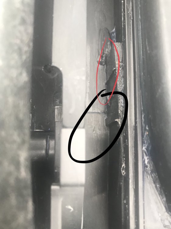

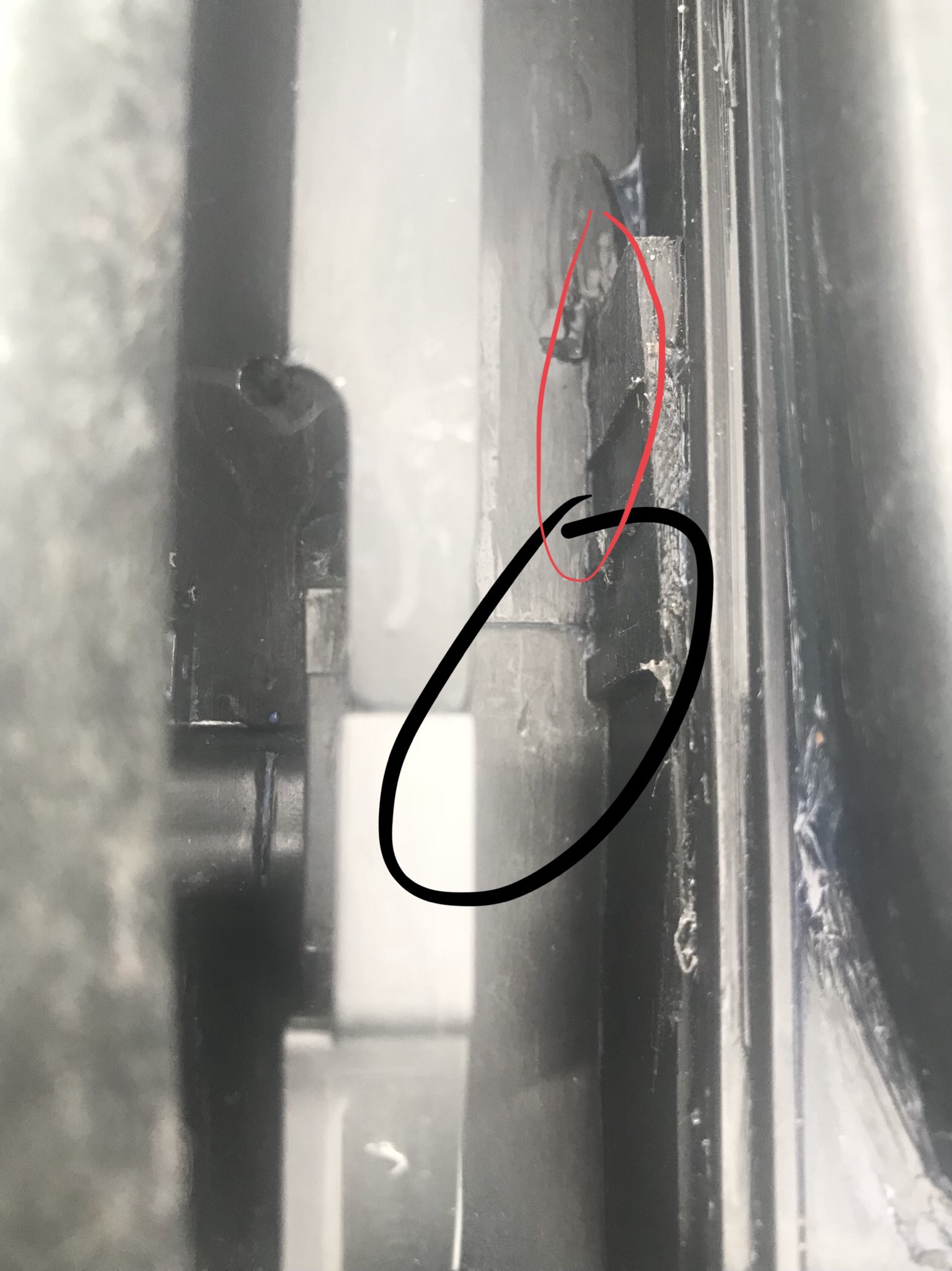

Big thanks to United for this post - tolleys is definitely a wonder product for this occasion. Thanks also to goose for help - I was losing it saturday!
Having added tolleys and watched it seep into the various cracks I decided to layer up the cracks to hopefully keep it watertight for a while. I layered the tolleys all along the marked red areas to hopefully stop any backwards flow of water.
 I wish access was a bit better on the outside channel as I can’t see how well it’s layered but it’s holding for now...
Good news Pano. Thats exactly the areas i filled. The outside is a bit of a pita the get in. I used the hollow tube off a cotton bud that fit snug in my syringe after cutting the ends off.

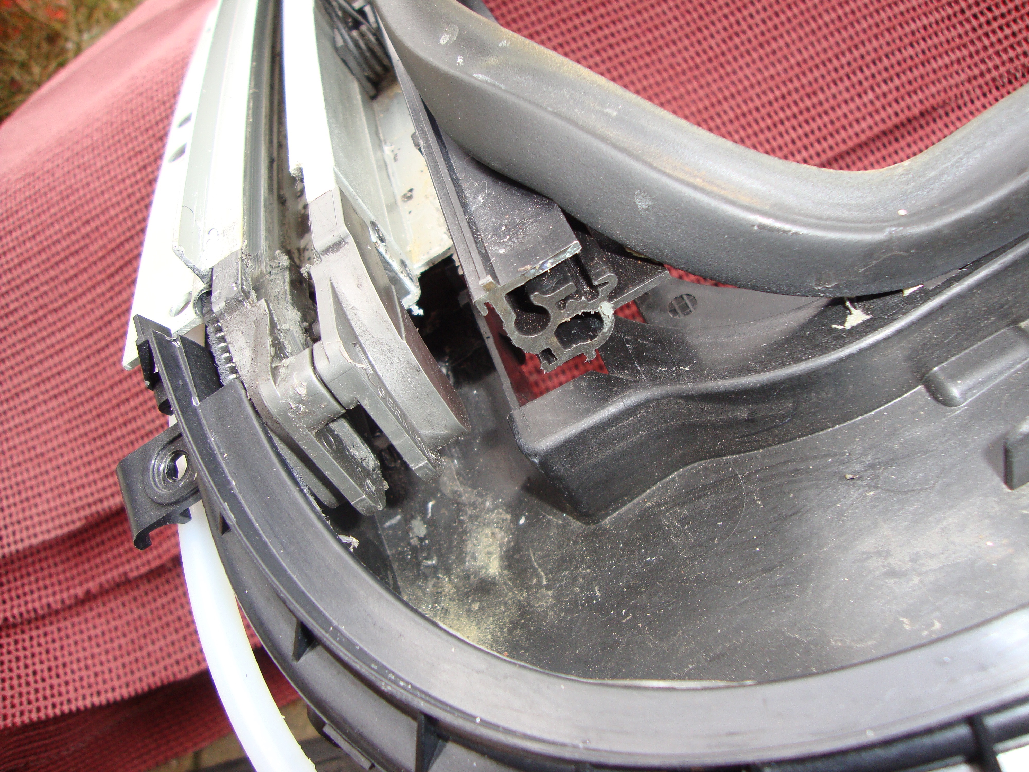

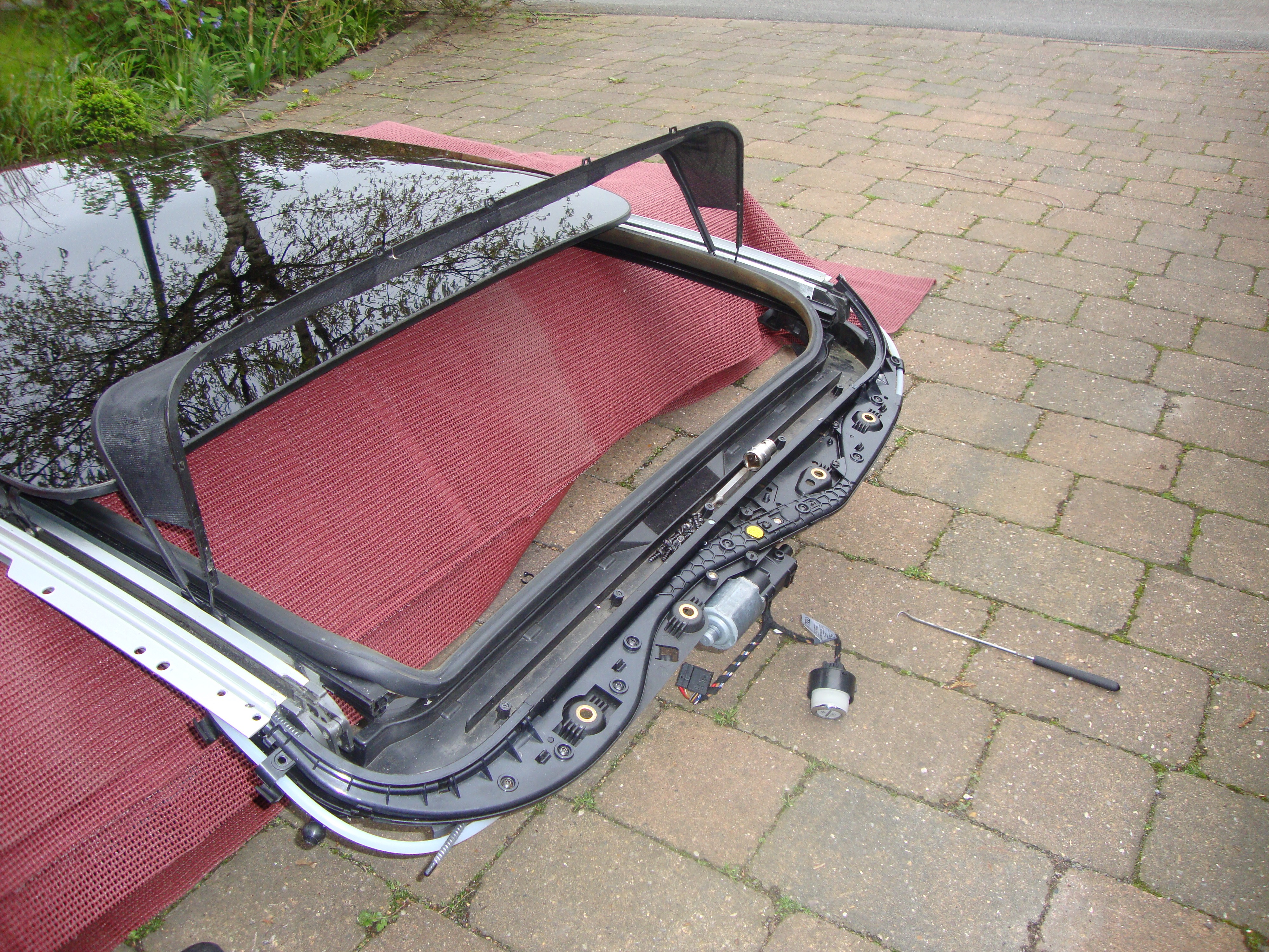

Unfortunately this excellent guide didn't work for me,well it did for a short time,just long enough for me to think i had cracked it and so replace all of the underfloor sound proofing which i had dried out again.
So,back to the drawing board. I have removed the complete sunroof from the car, its no wonder we are having these problems,there is so much flex in the front plastic section which obviously has an impact in the seal between the plastic and aluminium side sections. After removing the sunroof i carefully separated the front plastic section from the aluminium sides just enough so i could see that there is a rubberised seal inside the plastic,i carefully removed all trace of the seal then generously applied black tiger seal before re assembling. Tiger seal was oozing out between the plastic and aluminium...perfect. Then i clamped the joints allowing the tiger seal to set,although it never fully sets before re fitting the sunroof. I'll let you know how it goes.
