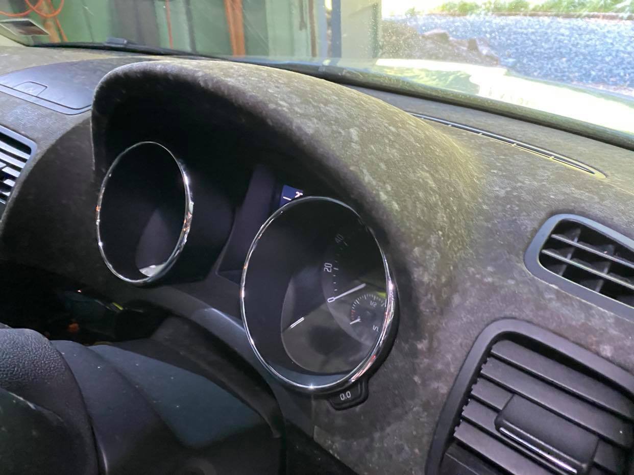

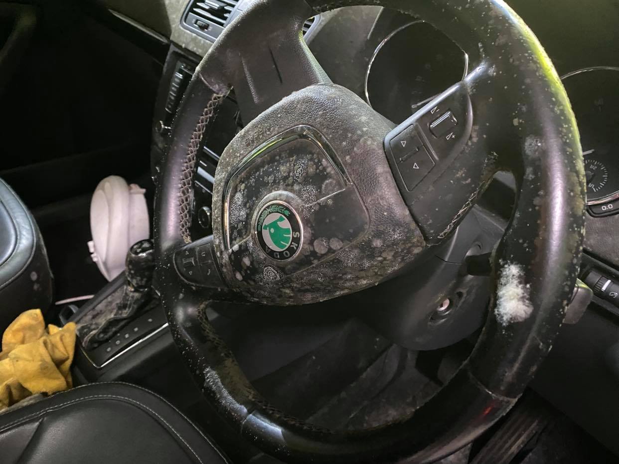

UNITED 232 and other contributors. Thank you. My mums car (L&K Yeti 2013) has had little use and always main dealer serviced. After some minor damage 2 years ago, the insurance repair ended up with over £1000 of work to fix an additional water ingress issue as described. Mum had a stroke 3 months ago and i went up last week to check on things and found the car in a terrible mess inside. I've brought it south and may attempt to repair but what a mess! see pics attached.
What a very sad Yeti.  I wish you well in your efforts to restore the poor thing 😧
that is unbelievable,  you are going to have a hell of a job cleaning that up, good luck with it
If it is insured it may be possible to write it off, as my experience with this sort of damage is that it is almost imposibble to completely remove it, and then the leak still needs to be fixed at more cost?

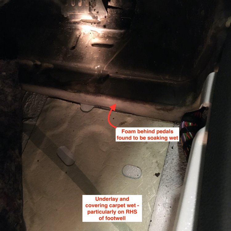

I now have my '64 Yeti in my garage (only just !), the driver's seat removed and all bolts and plugs removed (bar one) in order to dry out carpet, underlay and foam.  To recap, there is no evidence (that I can see) of water ingress through the panoramic sun roof.. This was replaced 18 months ago by Skoda for just that issue.  No further issues with water ingress until a few weeks ago - same place, driver's footwell, OFS.  This time the roof lining is dry, and no drops of water can be seen where before it was obvious.  The drain tubes are clear of any blockages, draining water efficiently from a bottle administered into the front cassette corners.
So, Question 1: How is the foam beneath the pedals getting soaked?

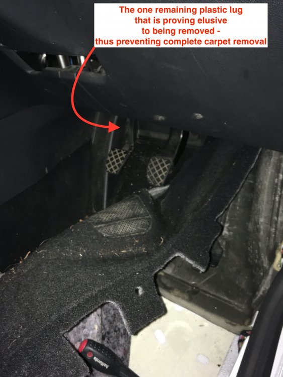

Question 2:  How is this remaining plastic plug to be removed?  See Image 2:
Image 2.
To fully dry out the carpet, etc, I really should remove it all.
So, in summary, I would be grateful for any help, from your good self, United232, or indeed from the noble folk that make this Forum such a breath of fresh air!
