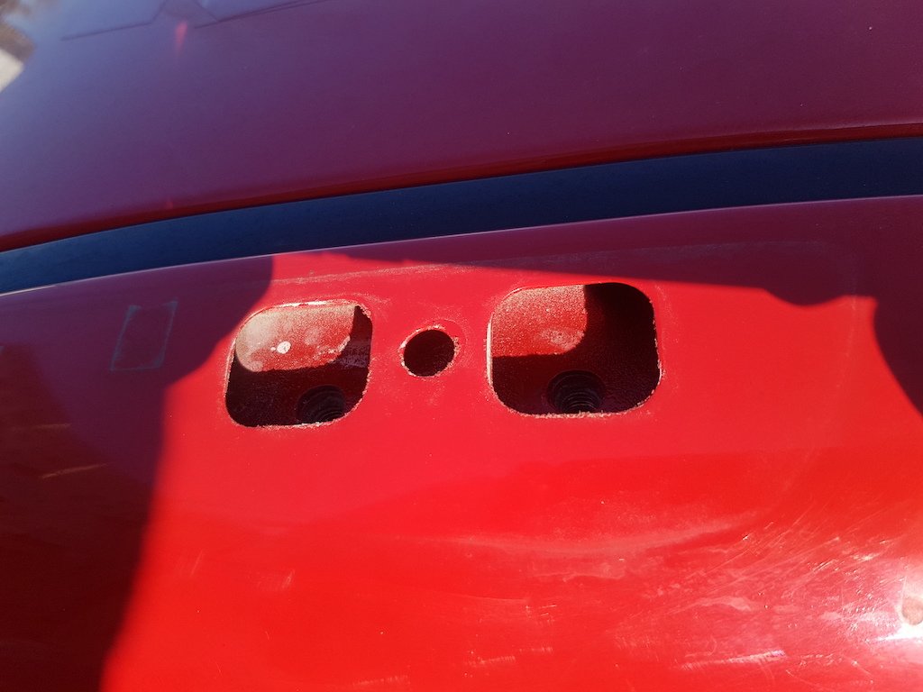

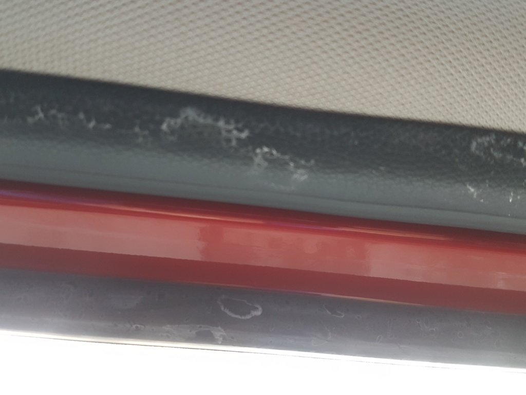

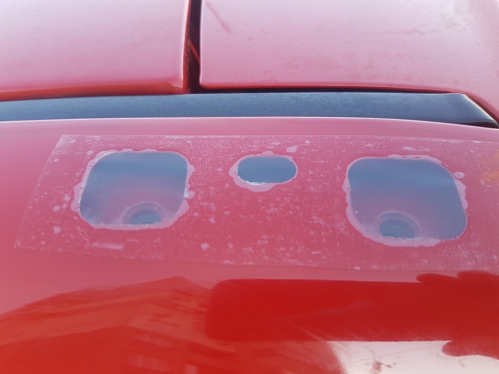

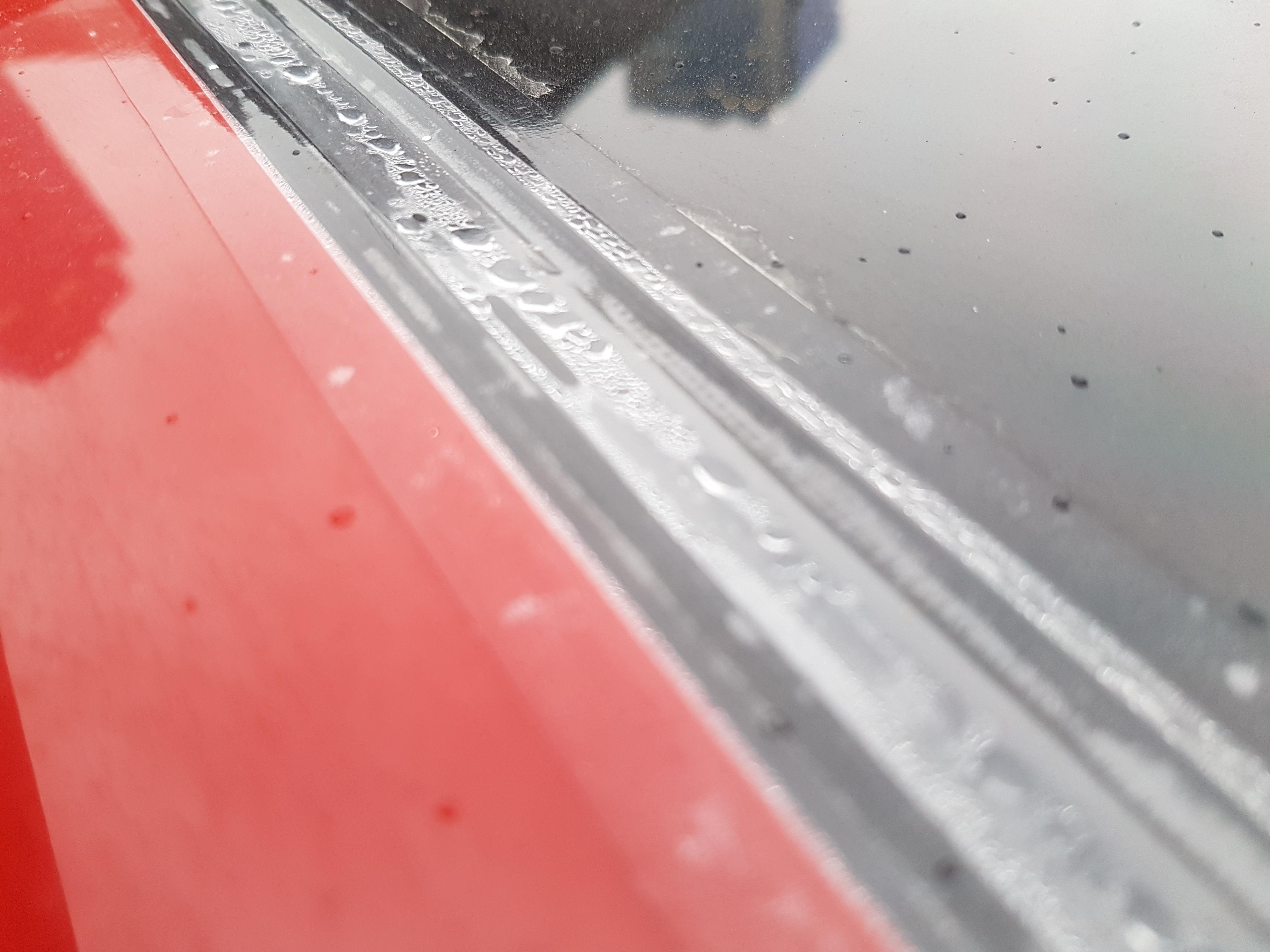

@Stubod
- it is cheap, it costs 5 eur in Bg, in Uk will be almost the same, i got 126/40 cm, orafol stone guard, asked several times for good removal options of the material,  almost half left
- for whole roof is not very good idea, not to mention efforts for cleaning and installing, soap water and tools, also removing will be chalenging
- permanent solution is not very good idea , also need to think for comfort module / open/close windows/ , dont forget to apply in the middle , and use double for
- use captain think in the summer/ dry conditions , it is best option, i am waiting for summer ;) or warm garage for atleast week/s to dry and
*my remarks from application

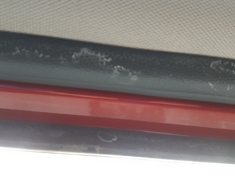

Do you see guys, other option of ingress, in the roof, not in the pano? Front window, rails mounting, some other interesting place ?
You could see condensation, it is not very good, i cleaned and left it dry for several hours.
I am asking, because , i got water inside, from roof and even after application of the folio. It was after water jet clean, i was very gentle, from distance and  got water inside from both sides. Definitely no water from stripes, I have checked  and they are very good condition, only condensation in the middle.
Anyway way , i am waiting for dry conditions and removing roof panel to see from inside .
Cheers
George

@here, whole roof packing for me is not very good idea, will be a lot of efforts for installation and removal ;) @United232 has pointed the issue with ingress and pdf has clear instructions, that will solve the issue with leaking pano roof. Unfortunately for me,  i have very long way  to solve my issue, i packed all possible roof ingress, pano, rails and  now front windshield is main suspect. Even you don't have roof, it is worth looking for white spots in the door sealing, this is beginning of the waterfall and you should take measures. Also checking black roof channel "sealing" for gaps and reinstall/replace is good idea. I am looking for good rubber sealing replacement or other solution.

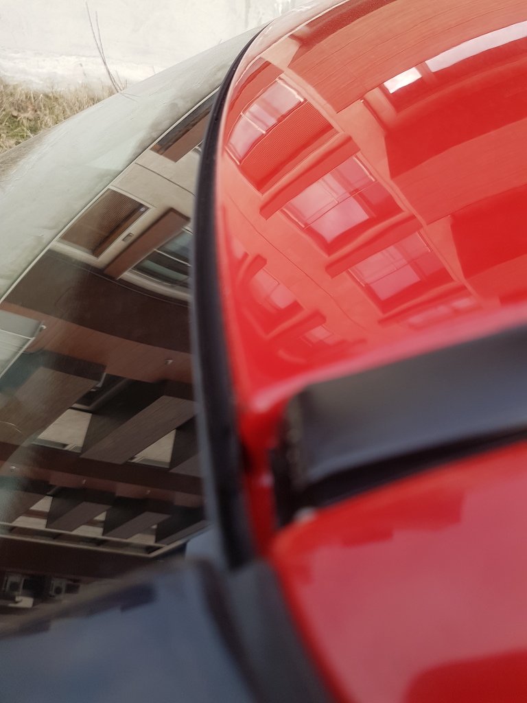

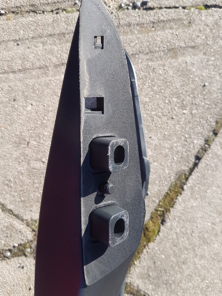

More news from me, i still had water ingress, so the water is not coming from:
- pano roof,  after packing  the pano .
- roof rails mountings, after packing roof rails,  / for removing use M6, Torx is not suitable /
Water is coming inside from front upper part of the roof, just behind sun visors . After each packing i have very gentile test in the jet wash, but still there is water, little relief is that water is not that much.
Now last suspect before having  cabrio and going to the south, is front windshield + the channel with black "sealing". Black "sealing" is not very reliable,  see picture with a big gap.  I packed this area and later will go for a test wash. Not to forget, i will apply capt tolley , in good weather ;)  /we have very good days with sun, but it is still winter/
Cheers
Moris
