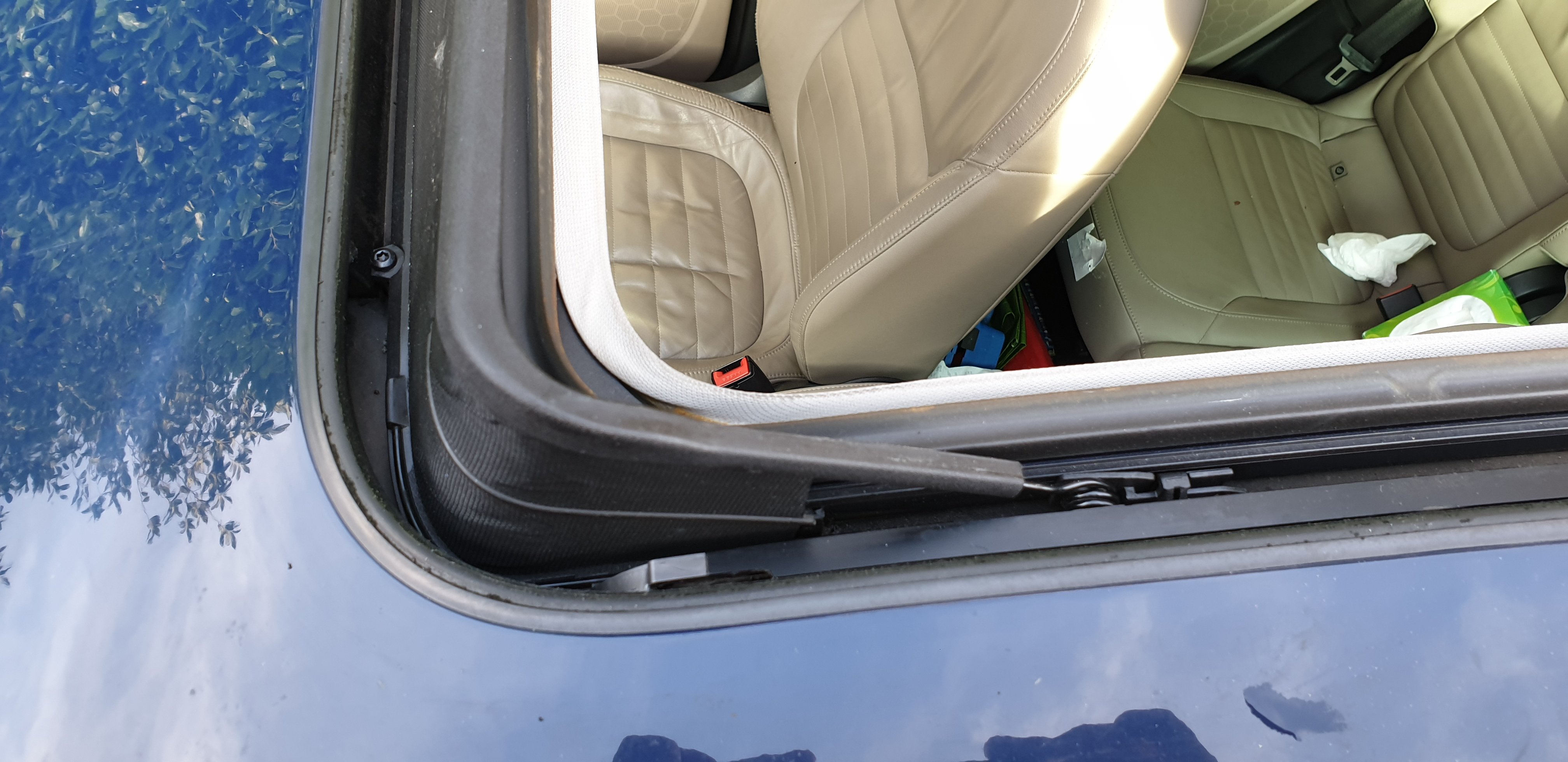

I was going to apply the cure, but the sunroof on my wife's 62reg Yeti looks different. See pic. What am I getting wrong? Thanks.

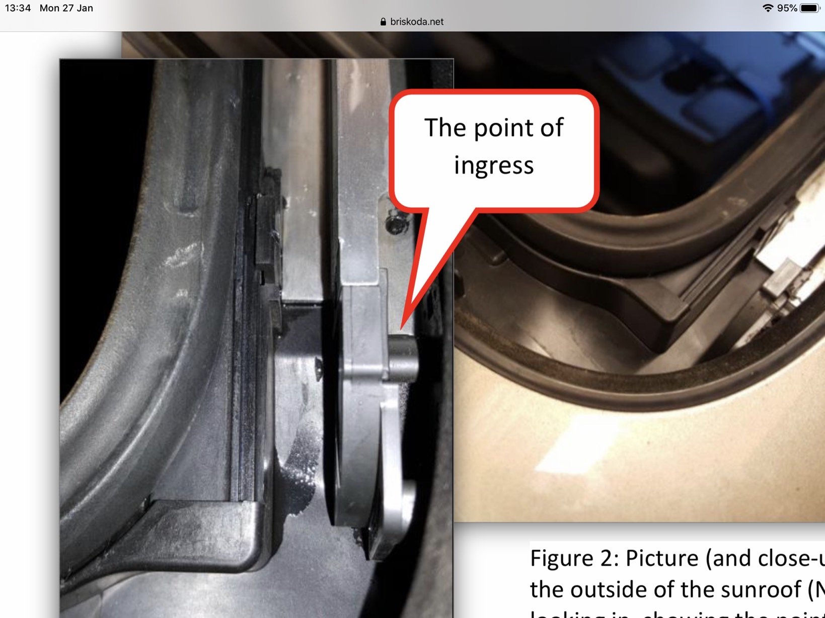

This article describes locating and rectifying a catastrophic water leak into the nearside passenger compartment of a six year old Škoda Yeti, which had a standard-fit panoramic sunroof.
  • The leak was traced to the NSF corner of the sunroof by removing the top of the NSF door seal and the NSF screen pillar trim.
  • Subsequent removal of the headlining and testing of the sunroof showed the cause to be failure of the seal between the aluminium channel forming the nearside of the sunroof frame, and the plastic channel forming the front of the sunroof frame.
  • The sunroof was removed from the car in order to run a penetrating sealer vertically down into the defective join, using a syringe and needle. Upon re-fitting the sunroof, the remediation was found to be successful, however the corresponding join on the offside front had been compromised, presumably because of the mechanical trauma inflicted on the structure during re-fitting.
  • The offside join was subsequently sealed successfully with the sunroof in-situ, using the same method.
  • Experience showed that (once correctly identified) a repair could have been effected without any dismantling, although the seats, carpet and underlay were subsequently removed in order to dry them properly.
The full story, together with annotated images is in the attached pdf document. If you're suffering with the same problem, I hope you'll find it of help. Please post any comments or questions.

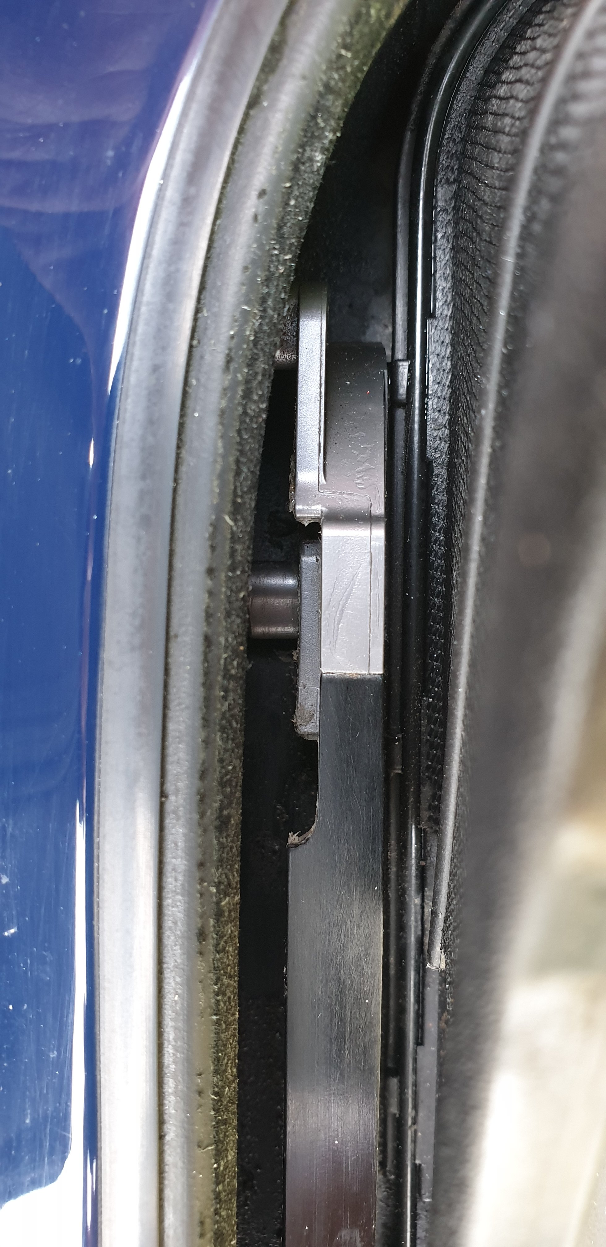

Yep, my problem is that the join/gap identified in the original instructions doesn't appear to be present on my wife's car.
You need to unscrew the wind deflector and pull it back to see and access the offending joint

Am I getting this wrong? It looks like a different gap in the original poster’s document...
Same with me, I have applied tolley several times, without success. Today it is raining and have water in both sides from the roof.  I will try to get access/view  from below and see exact egress point/s.

Now someone else has done all the hard work in identifying the fault, it's pretty obvious when you know where to look.
Tolley's is stated as forming a flexible bond and bit needs to be!
Malcvtr - removal of the deflector is easy. Remove the screws along the front edge and flip back. You can then access the problem area.
The extent of the design flaw is easy to gauge. Standing on the kick plate looking at the joint, simply press on headlining from underneath and watch how the joint flexes. It's quite shocking.
For me, it's significantly worse on the passenger side. This is also seen in the extend of the leak and amount of sealer apples so far.
I still feel that the Tolley's will work but it is a case of small layered applications to build up a flexible seal. Time will tell, keep you posted.

Hi All
As the original poster, I've had quite a few people contact me over the last couple of years, enquiring as to the effectiveness of the repair.
Happily I can confirm that after two years, ~16,000 miles and a couple of ... let's face it ... pretty testing winters, the vehicle remains 100% dry inside. Not even any condensation on the glass in the coldest of conditions. And that's what I'd expect, given the properties of the sealer used, and the way in which it was applied.
There is one point I may have failed to make absolutely clear though, and it's likely to be where the odd one or two may have fallen down. And @moris, with respect I can see you're heading that way too. The sealer is a water-based material, and so it remains vulnerable until it's cured. If you apply it to a wet environment, or an environment which is irrigated, it will ... at the risk of stating the bleedin' obvious ... just get washed out. It is therefore imperative that the repair site is absolutely dry, and remains that way until the sealer has cured. I know that's going to prove a challenge if you can't get the vehicle indoors, dry the affected area properly* and keep it that way for the duration of the remediation process.
It's an irony that these things come to light only in the conditions that are most adverse to effecting their repair. If you're really stuck with it though, you could consider taping up the roof gap (as many have said), and postponing the repair until the better weather is here. Just be careful that any tape you use comes off after a few months (unlike masking tape) and doesn't bring any paint or lacquer with it. Oh, and it's waterproof!
* When it comes to drying the affected area, probably the worst way of doing this in these damp conditions is to used forced warm air - the warm air will merely absorb more and more moisture until it finds a cold object on which to condense. And that'll be the aluminium channel you're trying to seal.
Good luck and better weather!
