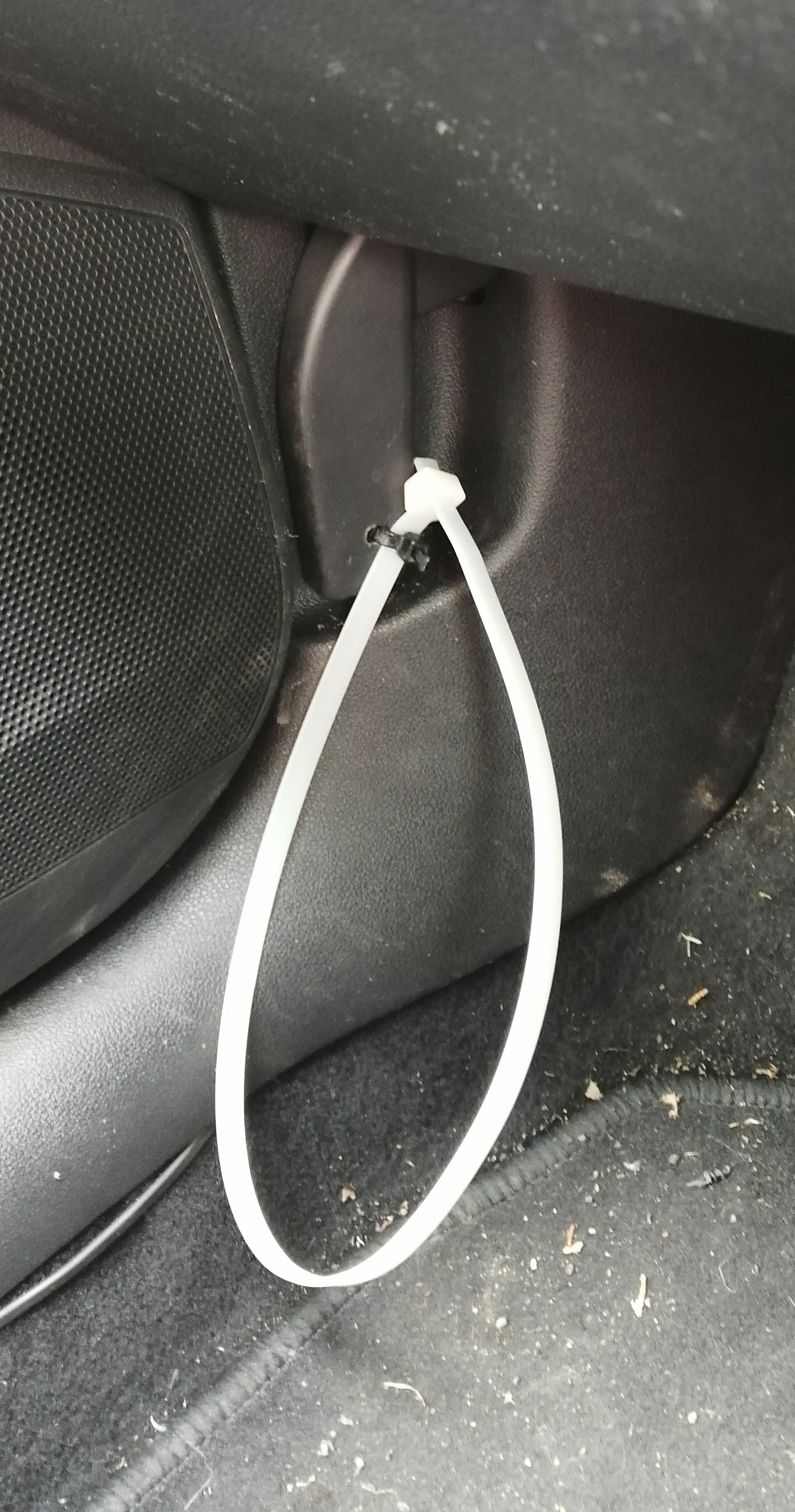

Following the problem of opening the bonnet.
I have installed this cunning device.
1) Drill small hole through the bonnet release lever.
2) attach a decent-sized cable tie through the hole and round the lever
3) Attach an industrial-strength cable tie through the "anchor" tie and adjust length to match arm length and agility.
This way the bonnet can be opened from the driver's seat.
Feel free to copy without licence payment!
