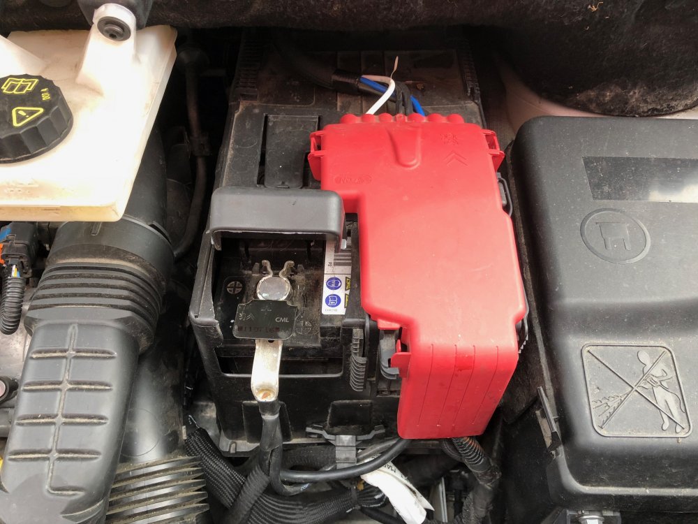

I came across this recently. Not a Skoda, but just shows how easy it could be to connect to wrong points.  The left looks like negative a quick glance, black cover on it and everything - but it was actually positive. As mentioned, best to check manual to make sure you are using correct connection points.

Just to prove the point my first glance said that the red moulding was the cover for the positive terminal (I take it it's actually the battery fuse cover)

A well designed French car that.
