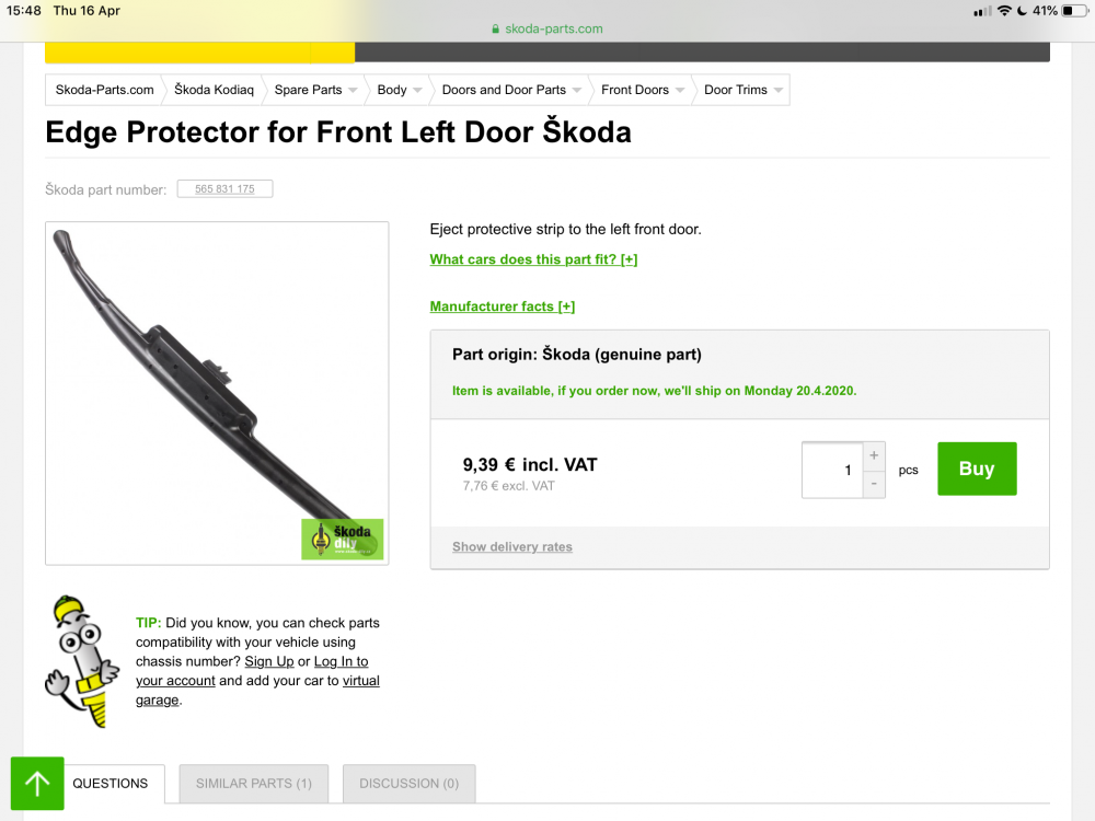

Hi guys, they are only €10 plus VAT and postage directly from Skoda—parts.com
For replacement of the broken ones I mean, not the kit.
I’ve replaced mine and it’s easy. Just remove the remaining piece that’s on the arm that protrudes from the door. Then put the door into a position which extende the stub, pull out the spring loaded arm further with a pliers and jam it with a flat screwdriver in the wee slot.  Then new edge protector clicks into place as you push against the jammed arm.

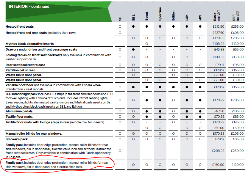

Here you go, it's a £180 factory option on all models of the current Kodiaq...
Unfortunately, much as we'd like them to be, Skoda franchised dealers often aren't the most knowledgeable about the products they sell.
As this thread alludes to though, you're really not missing much, a lot would argue you're better off without them.
