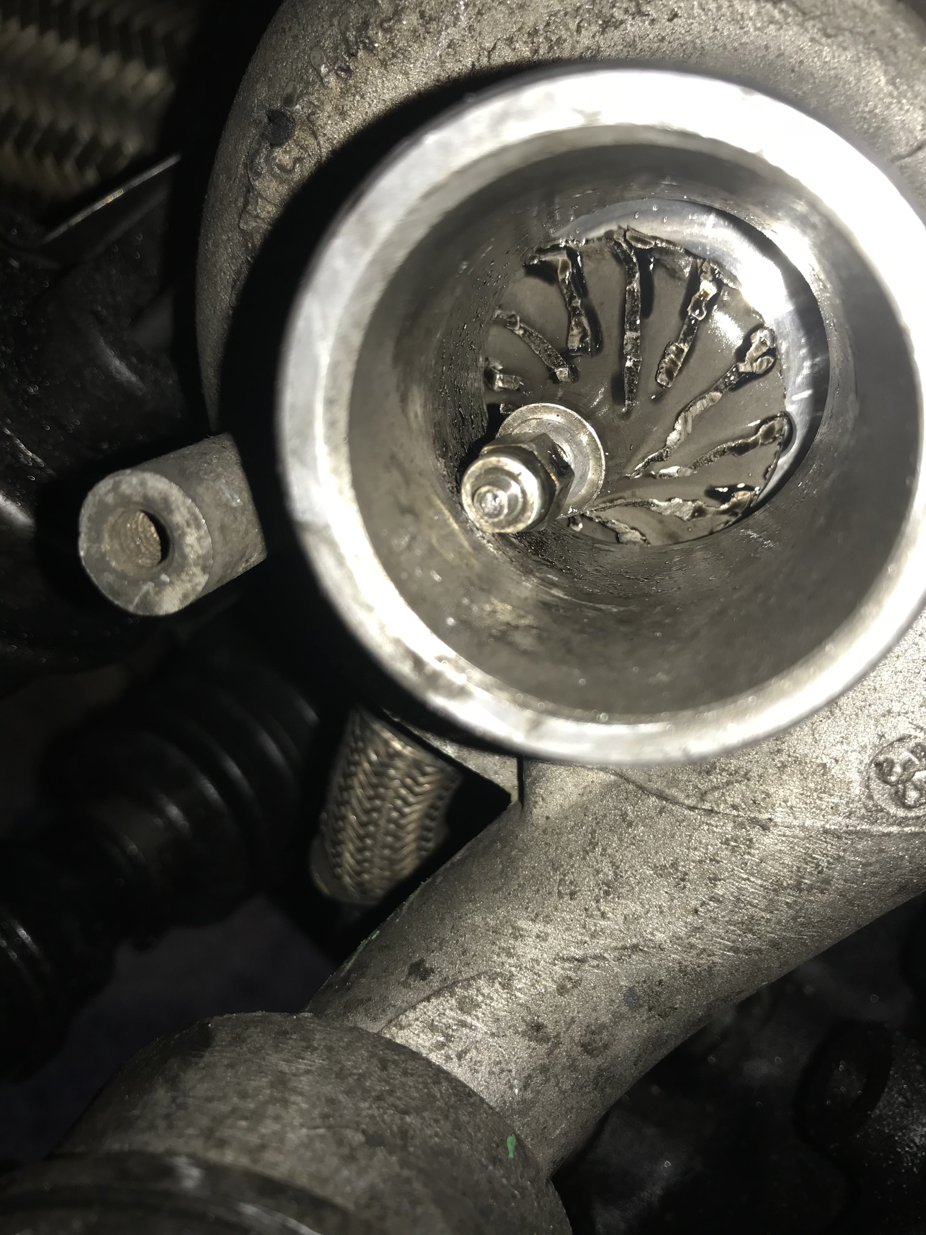

Well tonight I removed the turbo and this is what I found.... oops!
Not a a great deal! Car rolled 166.8bhp and 325ftb, believe it’s about 25psi according to Boost gauge

Some sort of alignment issue, from fitting/manufacture?? Hence the siren noise you mentioned, which ultimately has caused the bearing to give up. :speechless: “That Latvian company”, doesn’t immediately feel me with confidence :/    What bearings does/did it use?? Ball or journal??  Unlucky mate, certainly not ideal!!

Wow, all the oil in there as well, I bet the bushes have been leaking oil through the seals all along reducing oil pressure and causing the shaft to touch the bushes causing wear eventually leading to the impeller touching the casing then exploding.
Definite warranty, nothing to do with the map whatsoever, just really poor manufacturing tolerances.

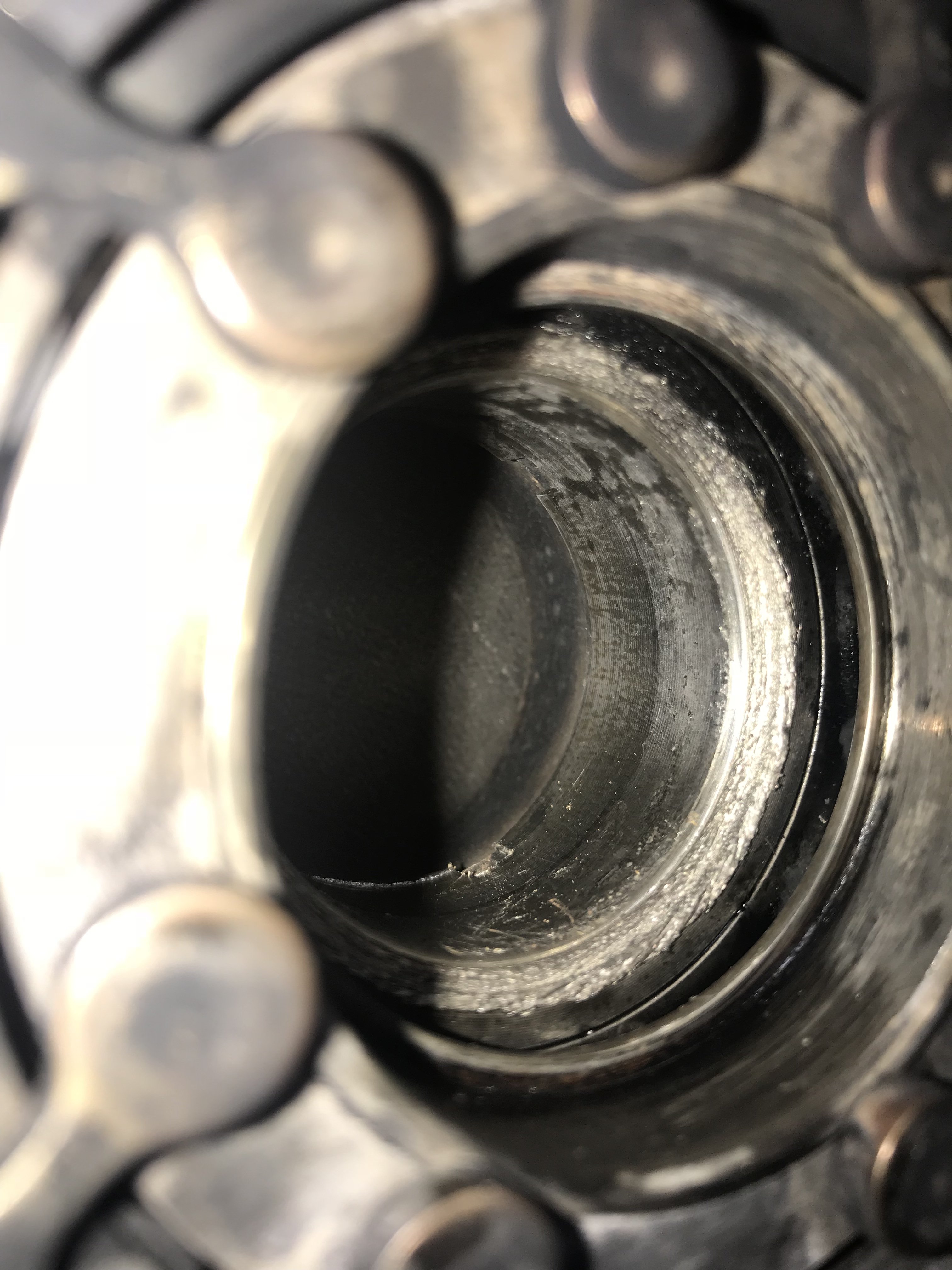

Seems strange we changed the core however when the bolts on the housing are tightened the compressor wheel doesn’t spin at all unless the bolts are loose
Also I have 2 dead cores one good, none of them spin freely the exhaust side is catching on something almost you can hear it rubbing but as soon as any torque applied to bolts that’s it doesn’t spin, the hot side was seized solid when the shaft snapped however no damage to hot side wheel, the hot side housing on the other side looks rather rough :( is this throw away jobby or rescue with a bit of wet and dry?
