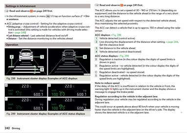

Thanks for all the replies on this. No wonder my recollection was vague - this is what the manual says:
A barely noticeable paragraph tucked away at the bottom of the right hand side. Note it says it "may" work, and it "could" happen from "about" 80km/hr. Not exactly definitive!
One bit of info there that might help though - @Q102 notes it doesn't work abroad. According to the manual it's not supposed to. It says it is activated "when your vehicle is moving faster than the vehicle in the adjacent lane on the driver's side". Which is all the time if driving on the wrong side of the road. If you see what I mean...
Finally, it says "The display shows the detected vehicle is in the adjacent lane", then helpfully (not!) doesn't show a picture of what it actually looks like. I'm guessing this is the change of maxidot image from saloon to SUV that Penguin mentions above.
Jeff when the SUV icon appears it actually shows it on the right hand side of the lane markers, clearly showing it's in the outside lane of your current position.  So where the number '1' box is on the diagram is where you'd see the vehicle icon.  Hope that makes sense.

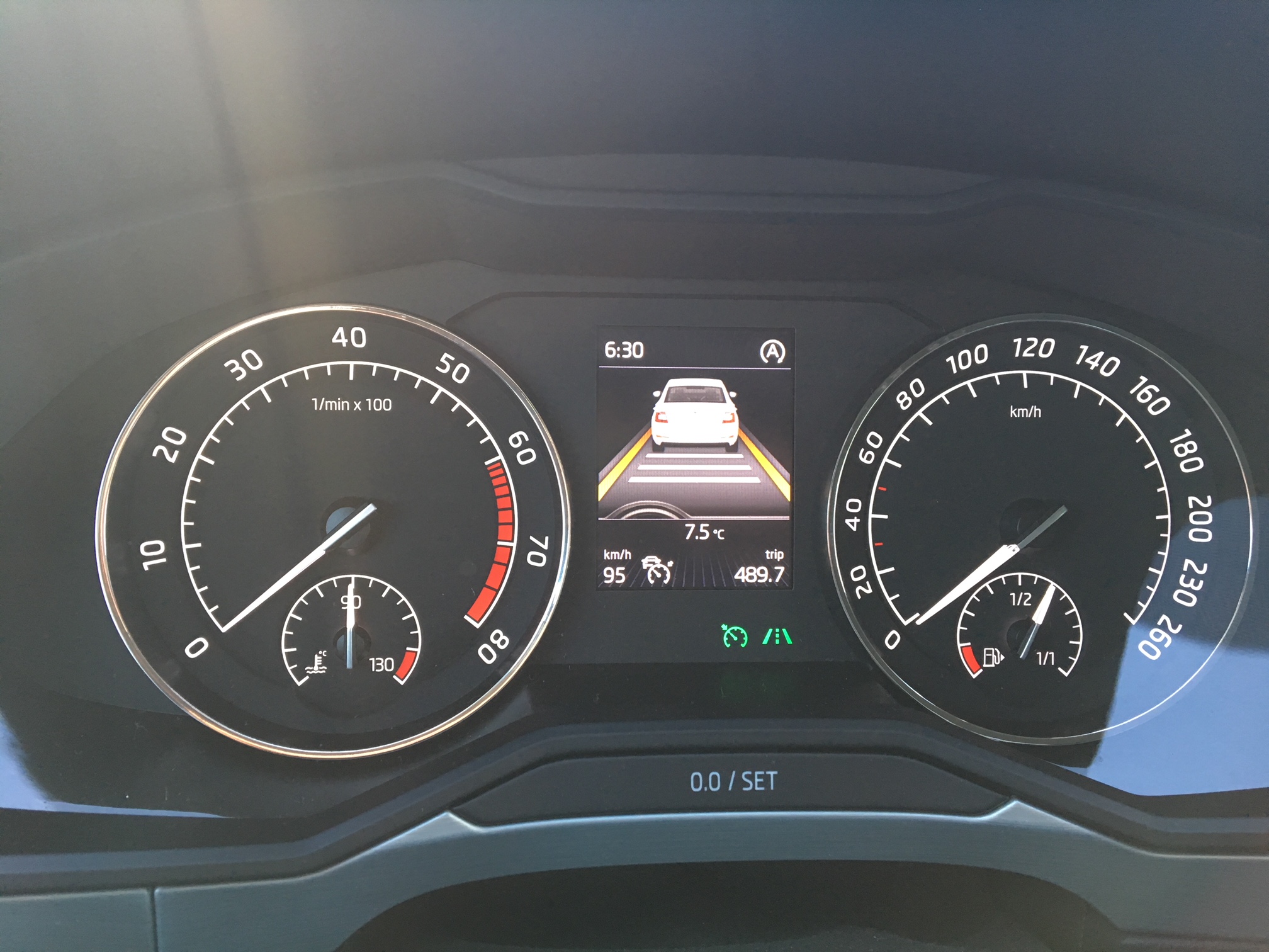

Can anybody else confirm, that a SUV i showing in the MaxiDOT when using ACC? As seen below, I get white Octavia´s (in my brown Superb...)
No, it's a different car.  Defo not the Octavia as I've had instances of both been on the screen at the same time.  Looks more like the previous Tiguan.
That´s weird. I get nothing but white Octavia´s - even then it´s showing a car in the lanes next to the one I´m driving in.
