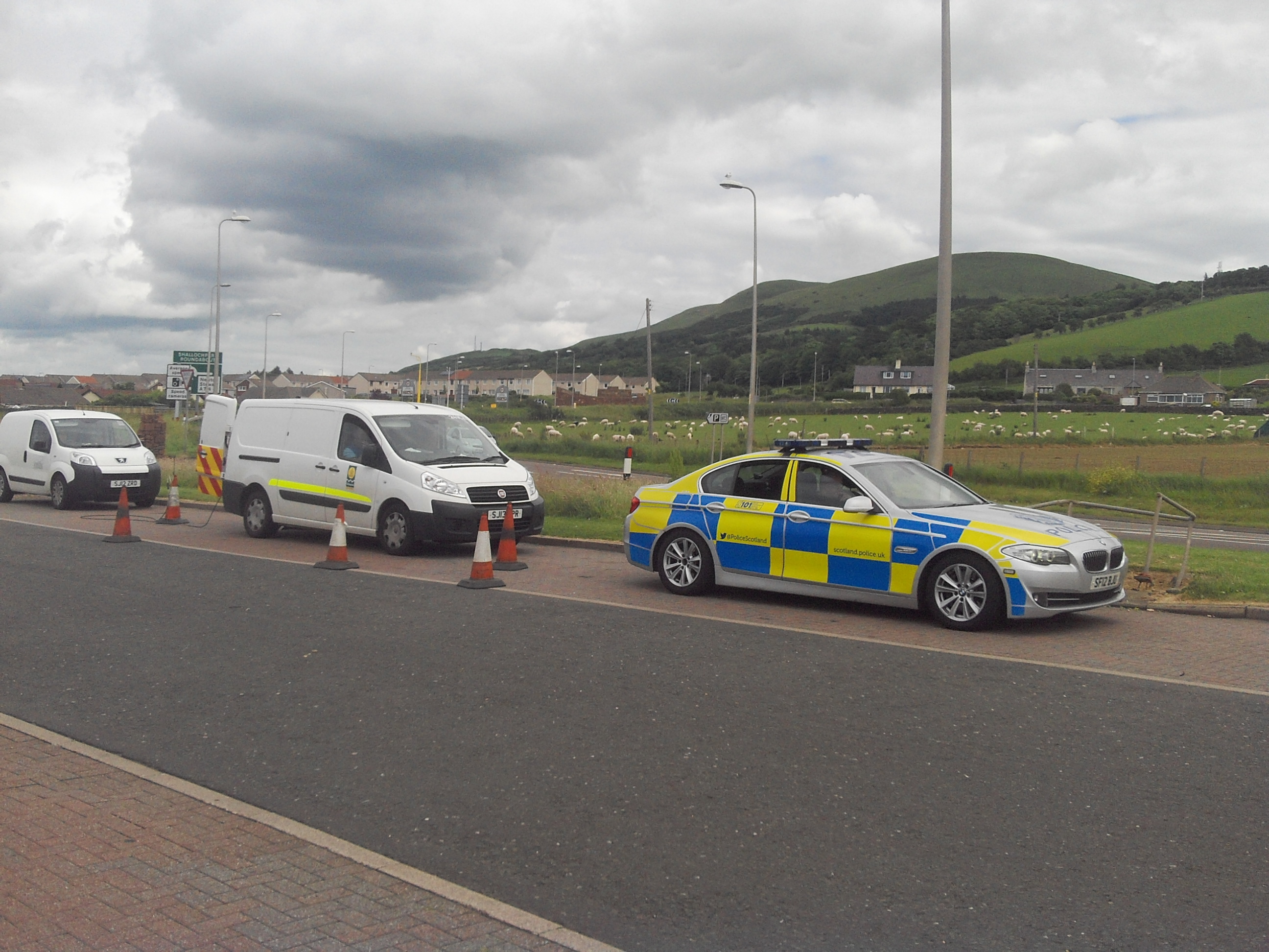

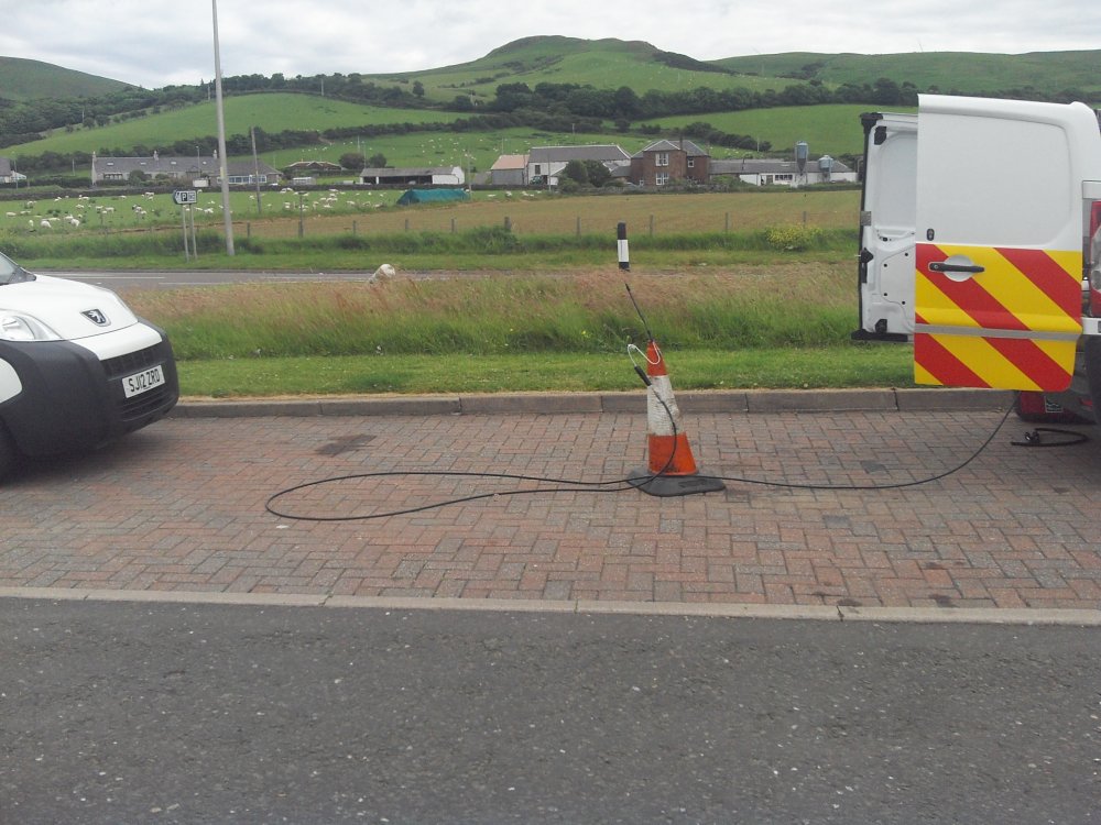

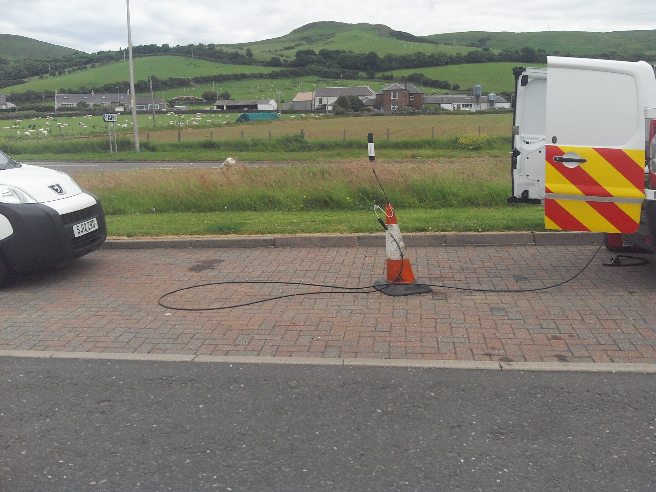

Until there are Webcams / ANPR (VIN Scanners) looking at the Test Bay in every test station checking that the vehicle away to be passed is the one being tested there will still be hooky MOT's done in the UK.
Those dodgy ones caught are often by HMRC / DWP and not the DVSA.
Then more roadside checking, as many many have parts on for a MOT then changed after the pass.
Not just Registration Plates, Headlights or Wheels / tyres.
