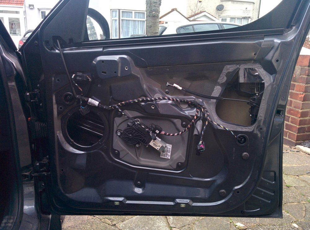

I've done this on my 57 plate Roomster. It's not that hard to replace the door loom. Basically it's remove the door card, drill the 4 speaker rivets out. Unplug the old loom from the A Piller, the gator unclips from the top on the A Pillar and all the door items it connects to. Replace with the new loom, re-rivet the speaker back. Fit the door card back on with new clips, as the old clips break when you pull the door card off. It must of taken me about 2 hours max as a 1st attempt but honestly nothing is that involved and it all just unplugs and plugs on.
I would recommend you order the loom part number as written on the current loom tag. There are a few different part numbers.

I got the wrong loom first attempt because my 57 Roomster was built right on the 04/11/2007 changeover date. The electric window motor changes between 1 and 2 plugs. My loom was the later BQ version with 1 window motor connector and front/rear electric windows. Your AN version is the earlier version with 2 motor plugs and I think only front electric windows (that web sites descriptions are not too clear), has your car got manual rear windows ?
By just ordering the part number already on the white wrap on label on the currently fitted loom then it must be correct.
I was driving for a week with no door card, unable to open any windows and opening my driver's door by pulling on the cable end you see coming from the door lock in my above photo. After a week the new loom fitted perfectly and I could fully replace it all.

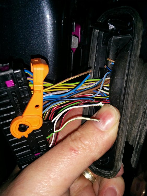

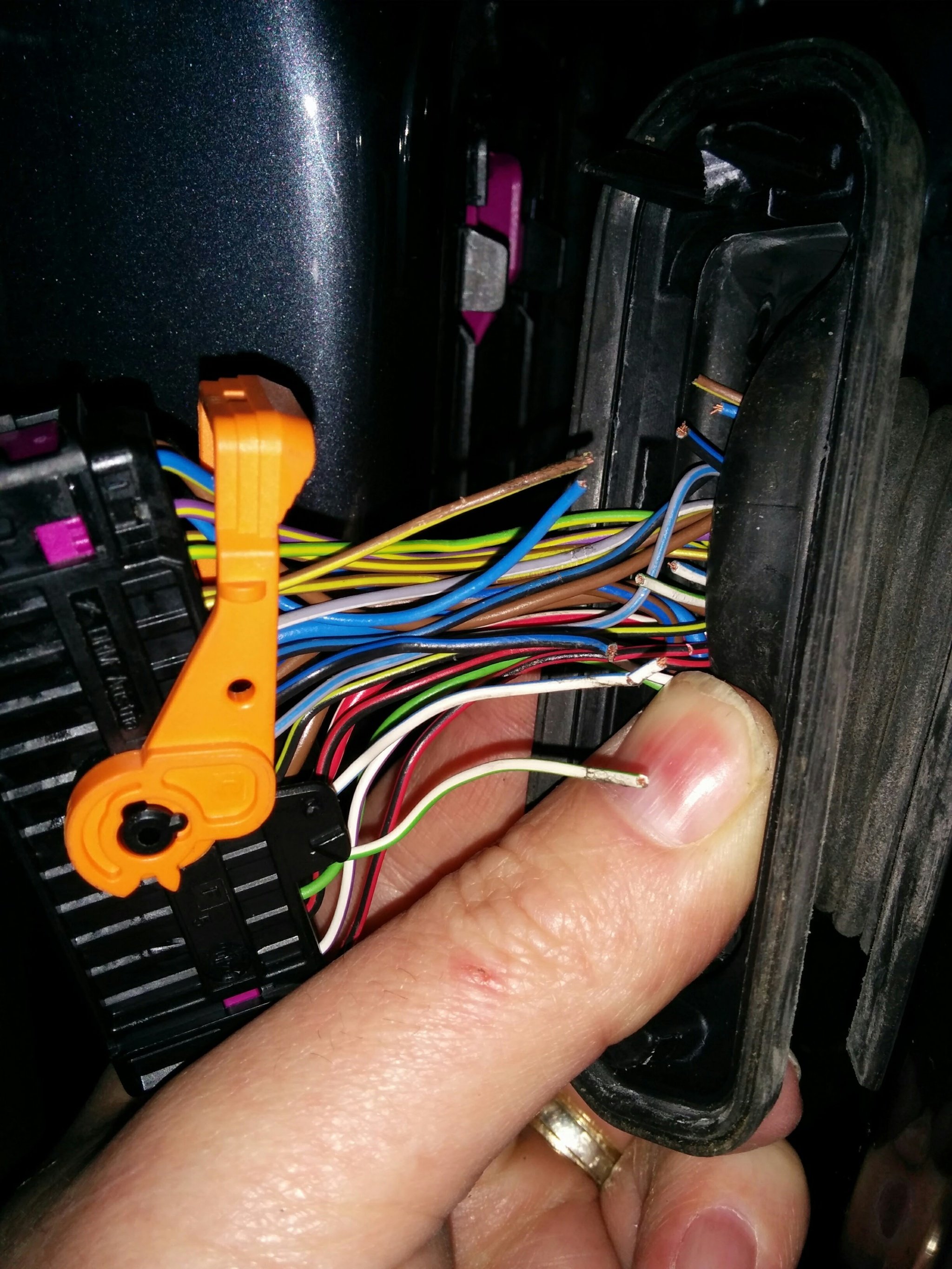

The wires break where they bend. Inside the rubber gaitor between door and A Pillar. The same for the hatchback loom. These are my inside gaitor wires. My fault was windows stopped working and door led locked flashing led didn't work. All door problems.
But reading your original problem, I've never read about anyone having horn and hazard problems due to these looms. They normally cause window and door lock issues.
So nothing wrong in gently pushing the release catch at the top of each door gaitor on the body side and having a look for broken wires or broken core insulation which causes shorts. But be careful your original problem would not direct me to investigating door and hatchback looms, except for one important point you made in when the fault occurs. When the hatchback is opened. I would be very suspicious of the area that causes the problem.
Interesting statement you make about removing the loom to see if the problem goes away. They do just plug onto the body side. In my photo here the loom is unplugged. You can see the plug on the left. That yellow handle on the plug locks and releases the connection. The hatchback loom doesn't unplug at the body, it must be just inside but I've never unplugged it so I don't know exactly where. Has to be behind C Pillar trim at a guess. I have had exposed cores with breaking insulation in the hatchback loom. But I fixed those issues by soldering and insulating the original cores.
