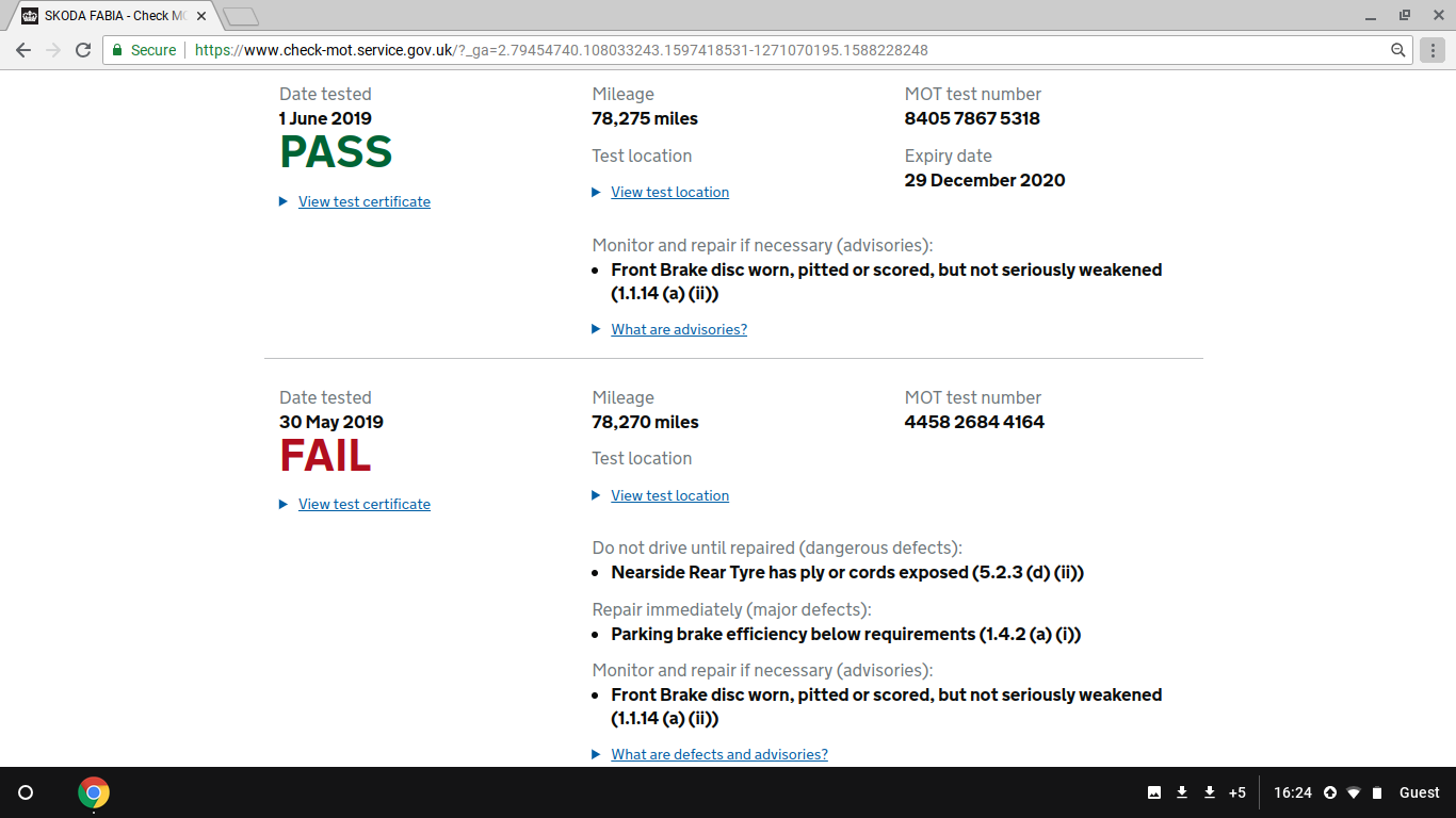

Check the past MOT's for Advisories and any past Fails so work required.

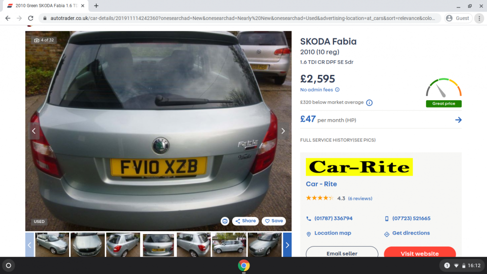

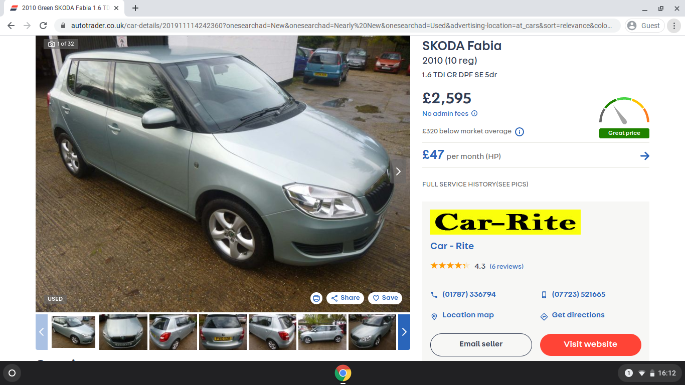

Here you go;  https://tinyurl.com/yyp9k85c
The first service entry from Formula One Autocentres is a bit puzzling but otherwise looks tidy enough.
Is it this 'Silver' one?  Not Green Metallic.

If it is the one above use the MOT advisory to barter.
