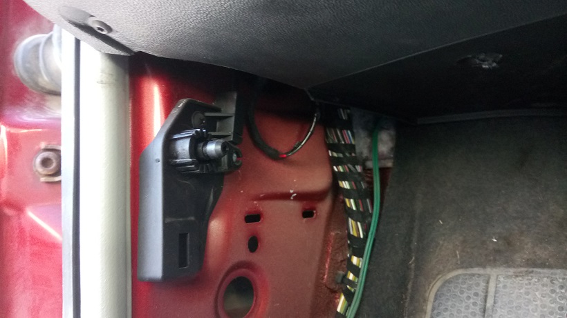

An inside look at the bonnet release handle stopper clip:
It can be removed with a flathead screwdriver and the handle pops off.

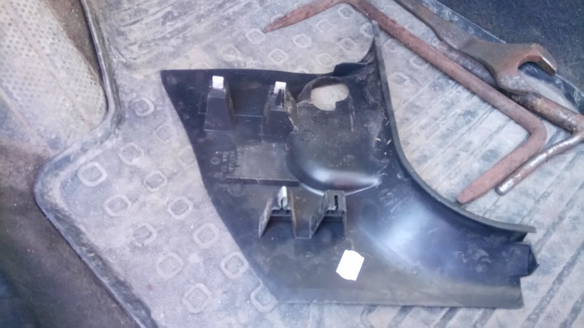

The trim is held on by four clips, it is good to know their exact locations when taking it off:
Just be careful not to break anything. The first time getting it off might be really difficult. On the other hand, if you break most of the clips, it'll be easier next time.

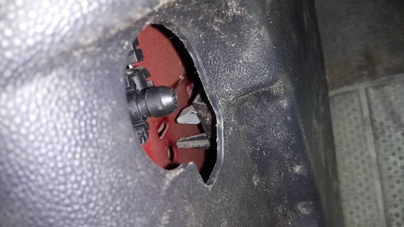

You can get better leverage on the clips through the lever hole:
And when the trim is off, you can see the bonnet release cable actuating mechanism:
Quite a simple mechanism but plastic all over.
