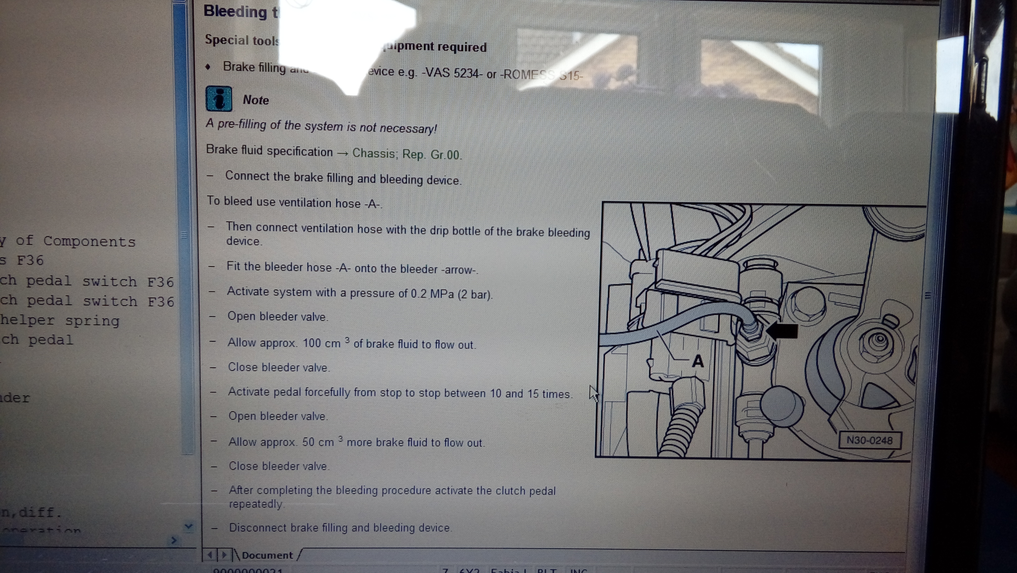

nipple is 9mm if I remember correctly. Some air came out but this could be air getting past threads. The fluid ran clear later without air bubbles. 200ml bled. M cylinder topped up.20180406_105907.thumb.jpg.ee8a390ba49b917f3f774c28571b3d7e.jpg

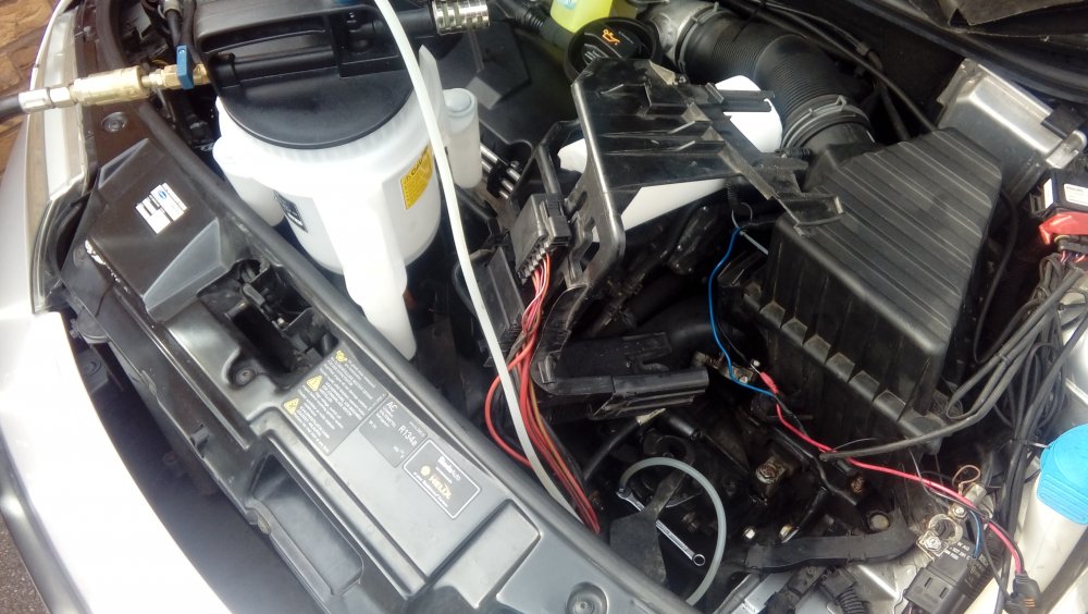

2nd photo shows location of clutch bleed nipple. Look for a rubber cap on a black bleed nipple.
Follow the bleed hose in photo.
