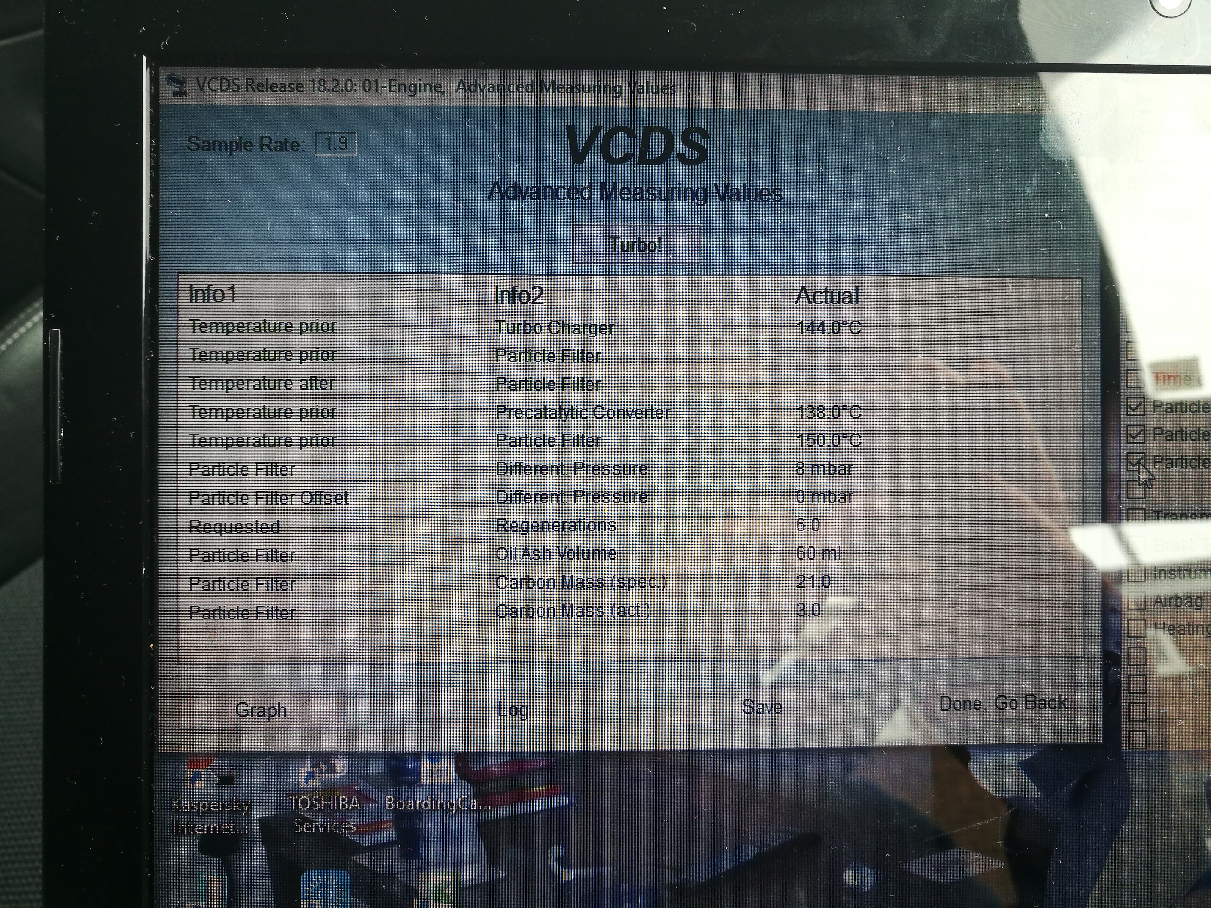

Could someone please explain where and how ill get to info about DPF via vcds? im getting desperate here lol
Been reading trough net/youtube, but cant get my head around it.
from what i've seen,the info should be: 01 engine - 08 Meas.block - channels around 68 -75 (cant see nothing there) ,
i can see some info in advanced meas. blocks like - oil ash volume 60ml
                                                                                         -carbon mass (spec.) 21.0
                                                                                         -carbon mass (act.) 3.0
so how full is my dpf? is that figure 21.0 or 3.0 figure in grams? or what is it?
The car is regenerating every 200miles or so,and im always very carefull not to interupt it. I have pluged it 2 days ago and i have seen that there was 4 requested regens , today already 6  requested regens.
Ill be very glad and thankfull for any advice or explanations about that.
Thank you

Ok, so ...i have been told that CR engines have different dpf measures blocks to pd. So now it makes a bit sense. And as well, that maximum oil ash capacity for octy vrs mk2 is 180ml(which is calculated by amount of miles rather then with sensor)
