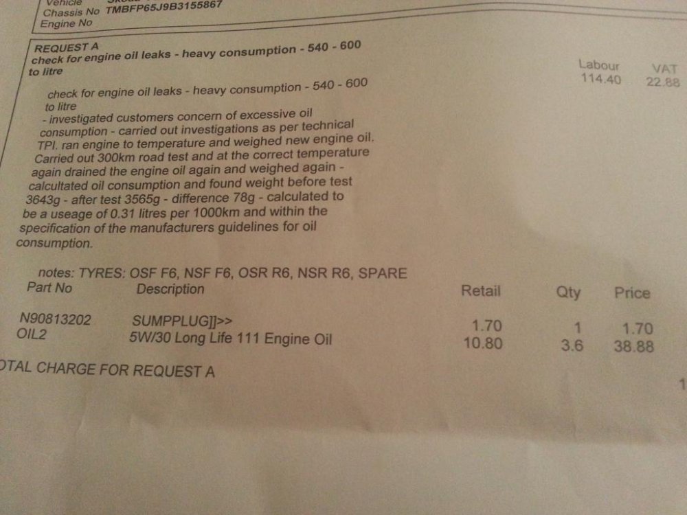

Supposedly a 'Professional' did this Oil Consumption test and yet does not know what a litre of engine oil weighs.

Is there a problem with the weight of oil?
I think the maths works out as:
79g / 0.3 = 260g/1000km
260g / 856g = 0.3037g/1000km
Forgive me if I've missed the point but the mechanic does seem to know the weight of oil.

Carrying out an oil consumption test on a 1.4TSI Twincharger 132kw engine with a 3.6 litre oil capacity.
so you put in a new oil filter & 3.6 Litres of oil, take the engine to operating temp which requires at least 5 miles driving not ticking over.
you drain or suck out that oil and weigh.
3.6 times 857 grams is 3085.2 grams, or a bit more.    Because 1 litre of oil does not weight 1,000 grams even still in a bottle.
3,643 grams of oil is 4.2 litres of oil drained before the test, and 3565 grams drained after the test would be 4.1 litres.
This is why the Owner never paid the Dealership that wanted paid to do the Official Oil Consumption test, and Skoda UK paid to fit a replacement engine.
In Gods we trust, in Factory Trained Main Dealership technicians you check after them.
