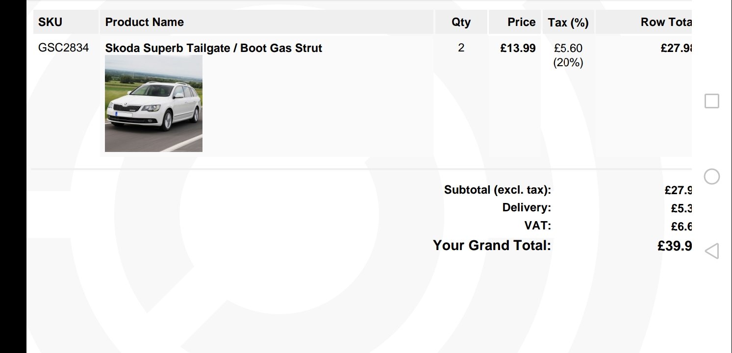

Hi Matt,
I have attached the details from my SGS invoice. It was 2017.
Hope you manage to get them.
No coding required, I swapped the struts over (10 minute job) and the boot closed and then adjusted as it normally would with electric struts.
Cheers
