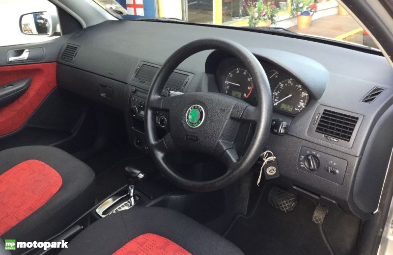

Spursboy, is it a Tiptronic Autobox you have and not actually a DSG?

I was under the impression it was a DSG, but it may not be! It's the one in the pic (took it off Google).
It is a tiptronic, not a DSG.
Thanks for the clarification - seems to be a four-speed one at that, too. Bought it advertised as a DSG, but either way it's better than the MMT I had before!

No DSG boxes in Furbys, too expensive for a budget hatchback. No doubt you bought it from Norf London Liars Ltd.
