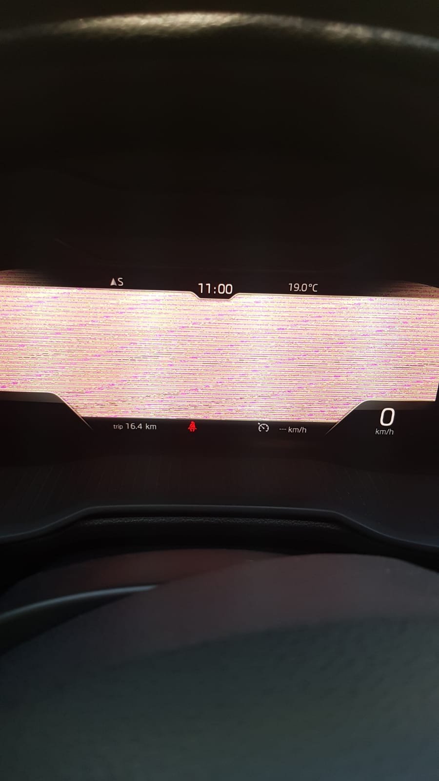

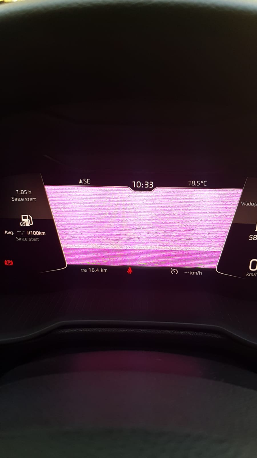

Hi,
Can you tell me please witch resolution used to view maps o cluster?
I have this error. I m useing VCDS or ODIS.
Tks

Hi, please help to set  Maps on cluster. right now is only just lines
Is yours an MIB2 or MIB2.5?
The MIB2 doesn't support streaming of maps to the VC. You need an MIB2.5 for the maps to work properly.
